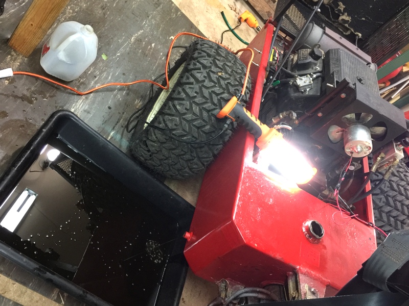

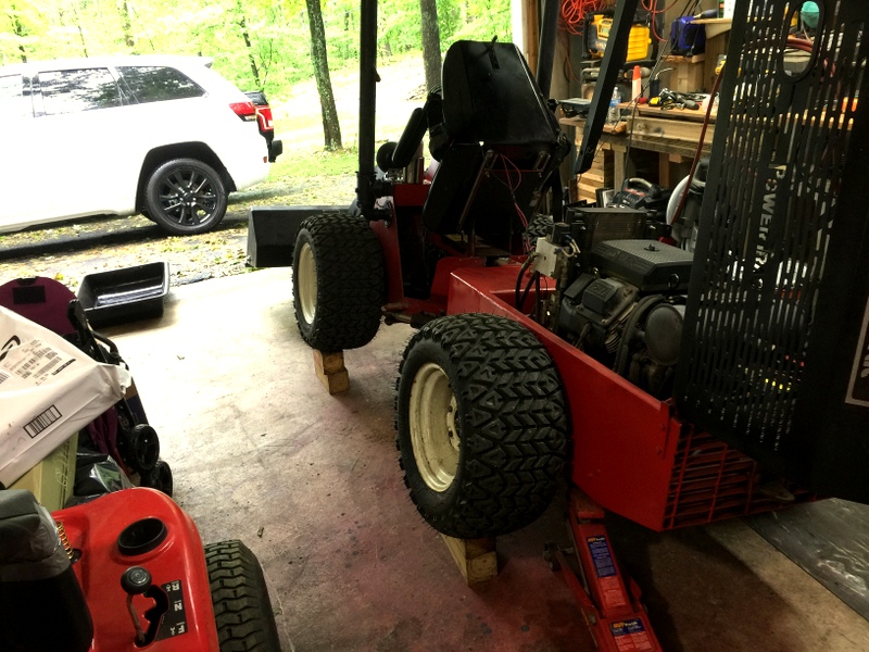

I did the oil change out today thought I would be done, go figure. When I bought the machine the guy had a hose in the box.. I figured it was the air bleeder hose .
Guessing from the large fittings it was a by pass hose you need when moving the machine so you don't damage the pumps.. Guess I'll have to wait until this week call Terry and order a bleeder hose to finish the job.. Bought this little drill pump but it was so slow I just went ahead and removed the hex plug.
Turns out the oil didn't have sludge like I first thought. Turns out it was pretty clean with the exception of I did see some tiny metal specs .. They may have been break in metal from the new drill pump. Thanks for everyone's advice and help. Now on to Synthetic oil change for the Kolher engine. :cool:

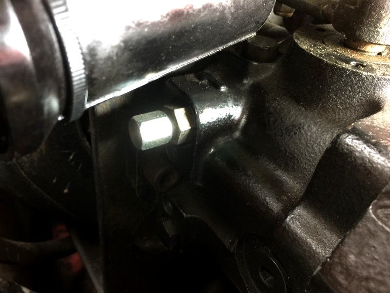

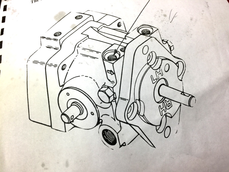

Yeah I should have been more clear in my description ... Appears this is my bleed port and has a threaded nipple.. I have not taken the cap off yet .. Your thoughts do you see any reason why I can't just thread a section of gas hose onto the nipple here to bleed the air out and back into the tank instead of ordering a hose from Power Trac ... May even use a hose clamp ..

I would think any hose that makes an air tight & secure seal will do the trick. Could probably get a hose made at NAPA store too, save on shipping from Tazewell unless you need other things?
   / Tank Oil Change #59
The only reason I have fittings on both ends of my bleeder hose is that it doubles as my tow hose. If I didn't need a tow hose, I'd have just kept the factory-supplied bleeder hose that had just one fitting on one end, and a cut off hose on the other.
As mentioned, I guess when bleeding is you just want an air-tight connection where the hose meets the bleed port, and a hose that's long enough to get the other end submerged in the tank oil.
