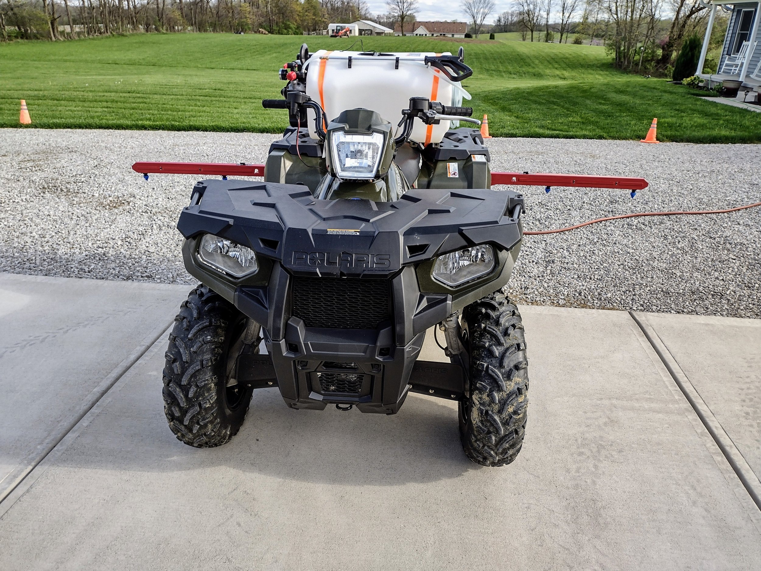

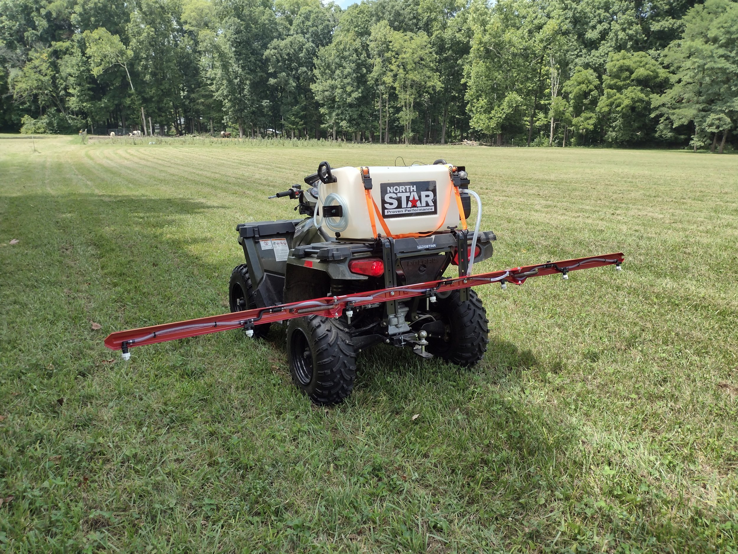

This works great for me. Purchased from Northern tool. Connected to the battery charger wire. Steer and throttle with right hand spray with left. Came with 2 straps. On and off is quick and easy.

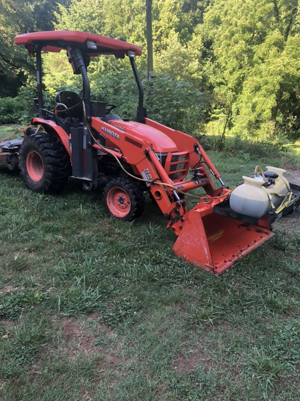

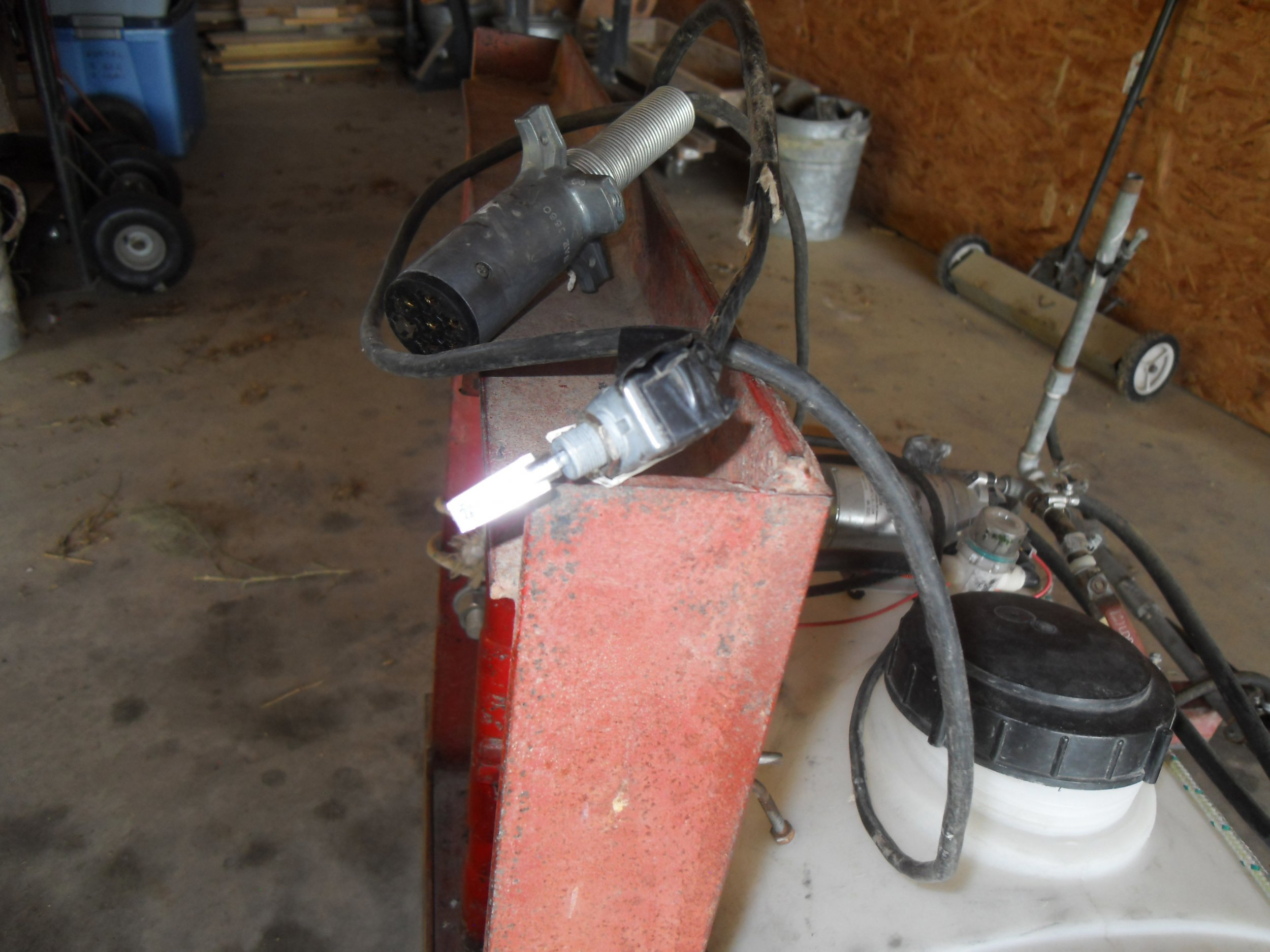

Some ideas. This is the setup that I dreamed about for years.
I started with the 25 gallon Fimco sprayer from TSC for the bed of my Mule. Legs broke after a while, so I salvaged the Fimco pump and wand and bought a 65 gallon poly tank from TSC. Custom added that setup to my non-FEL tractor with pipe that bolted to the frame - only required 2 bolts to install/deinstall:
Sold that tractor and moved the sprayer to a larger Kubota with FEL. Modified the setup to utilize the 3 point in back instead of using the front. In addition to the electric pump, added a PTO pump and boomless spray head that will do 40 feet. Had to redesign the Boomjet spray head support a few times because the brass lead was too bouncy and rough on the PVC piping:
Detail:
Since the above pictures, I have added a second bigger Fimco pump that will run parallel w/ the original Fimco. Allows full pressure at the wand and each pump can be independently turned on/off. Wiring goes to an electric weatherproof port behind the operator seat, facing the 3 point.
