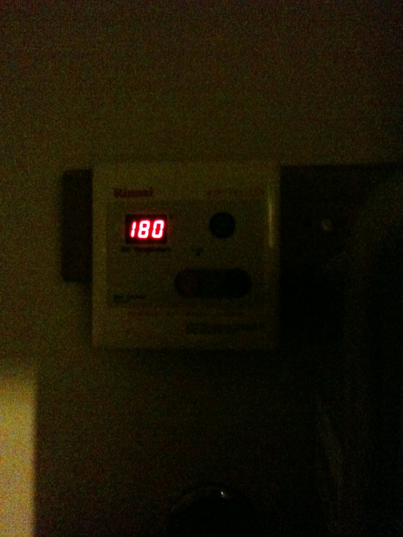

Oh yeah, I'm sure you also know, 180 degrees is waaaaaay too hot for a residential setting
It's impossible to set your residential tankless water heater for 180 degrees. You mentioned that you had the wrong unit (after you made that same comment about the temp setting) after I mentioned that some time ago.

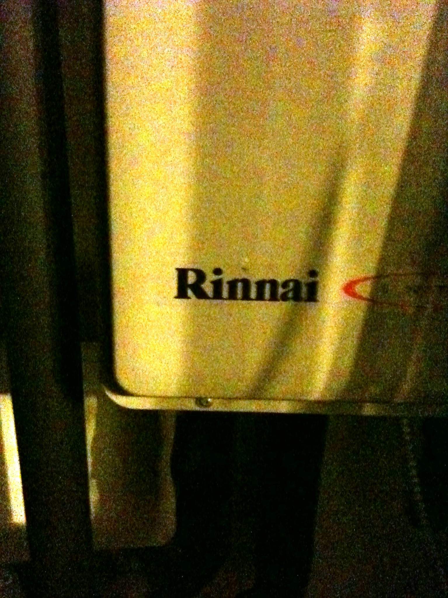

Sorry about how dark the pics are. My cheapo phone doesn't have a flash. They are the right units for what I wanted for the higher demand. I don't have them set that high. I just turned them up to show where they can be set. In the winter I bump them up to about 140 and in the summer I drop them to 120. They each can easily run 2 showers at the same time in the coldest part of winter no problem. The one in my guest house only goes to 120. Nobody has ever complained about not having enough hot water. There is only 1 shower in the guest house.
