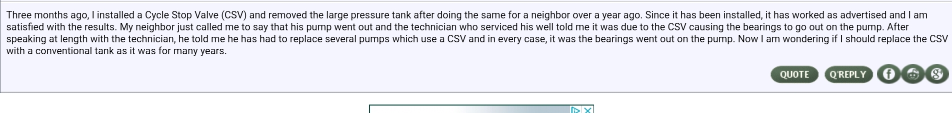

If a pump delivers 20 gpm and your using 5 and the CSV keeps the pump running continuous then your running too much back pressure to the pump. Google this and you will find threads of people damaging pumps with CSVs.

Lol Mat! In almost 30 years and a million installed there has never been a pump damaged in the least by a CSV. To the contrary, every pump with a CSV has lasted much longer than normal already. Back pressure is a good thing for pumps. It makes a pump draw lower amps, run cooler, and is what eliminates the the destructive on/off cycling. But these quotes do show the lack of knowledge by so called professional pump installers. As a matter of fact that one statement or question can be used to tell if your "pump professional" has any idea what he is talking about. When you here someone saying back pressure is bad for a pump or that cycling on'off doesn't hurt pumps, find a different pump man. If they don't know this one simple thing about pumps they have a lot to learn and you need to run away as fast as you can.
I will say this again. In 1994 Goulds and several other pump companies blacklisted the CSV as a disruptive product. They told their employees, "The CSV makes pumps last longer and use smaller pressure tanks. Goulds makes pumps and tanks, so any of their employees who mention a CSV would be fired immediately." The best pump engineers in the world couldn't find a single flaw with the CSV and they were afraid it will cut into their replacement pump business, which is does. Makes "techs" who say things like you quoted look pretty stupid. You won't hear any of the pump engineers or anyone who knows what they are talking about say something like that.

Never good running any type of pump long periods over its recommended pressure. Currently 26 years on a properly sized pressure tank and farm use for the current pump. They are more designed to cycle than to run long periods over pressure.

That is certainly not true! Pumps are made to run "continuously" as in 24/7/365. It says so right on the side of any pump/motor. "Duty... Cont" for continuous duty. You are either just lucky to have a pump last 26 years, or you know how to irrigate without causing the pump to cycle on and off. I guarantee if your sprinklers are mis-matched to your pump, it will cycle itself to death in 2-6 years and no way will last 26 years. I have a stock water well pump that hasn't turned off in over 18 years. I expect it to last longer than my house well pump which even with a CSV, cycles on and off when needed. There are strict limits to the number of times a pump can cycle on/off, and those limits are published. These limits on cycling are only to make the pump last through the warranty period, as the less cycling the better.
Last week one of my customers told me why so many people think like that. It is called "Hysterical Denial". People get hysterical and even angry with me for explaining something differently than the way they always thought it worked. They should do a little research to uncover the facts instead of just denying things they don't understand.
Counter intuitive things people have wrong about pumps.
Pumps like to run 24/7/365.
Resting pumps is not good.
Restricting a pump with a valve makes it draw lower amps and run cooler.
Running just a little water thinking is is easier on the pump, is the worst thing you can do, unless you have a CSV.
Variable Speed Pumps save energy. Wrong! Varying the speed increases energy per gallon pumped.
So many things about pumps work just the opposite of what our intuitive brains tell us, that it is no wonder even most pump engineers don't really understand. And the pump engineers who do understand how a CSV works don't want you to know, as that would cut into their repeat pump sales.

First off I'm not a well and pump expert, but I don't believe for a second that it is good for a pump to run 24/7 /365 , didn't say it couldn't just can't believe that it would be a good thing, if that's the case why have a pressure switch. Lastly Out of curiosity on your stock tank that hasn't turned off in over 18 years where does all the excess water go? Just curious.

Like I said, so many things about pumps are counter intuitive, and that is one of them. When a submersible pump is running there is a film of water between all the bearing surfaces which makes it completely friction-less. But just like a truck engine, when it first starts all the bearing surfaces are dry and wear happens. Once the pump is up and running, it is just like when the oil pump finally gets oil circulating in a truck engine, all the wear stops happening. Ask any trucker why they leave those engines running all night. They will tell you their engines last longer if they never turn them off. Look up Kingsbury thrust bearings. You will see they use them in dynamos like at the Hoover dam. Some of those bearings have been running 24/7/365 for over 75 years. I saw a report where they inspected one a few years ago and said it had absolutely zero wear and was good for at least another 75 years.
My stock water pump feeds 3 GPM to an earth tank, similar to the windmill it replaced. If the earth tank ever gets full, it overflows into a creek. But I have only seen that happen a couple of times after some really big rains. This pump has been running over 18 years. The last one only lasted 12 years, as I didn't have it restricted to 3 GPM, and it was obvious it had been pumping a little air all those years. With the latest 7 GPM series pump restricted to 3 GPM, the amps are lower making the motor run cooler, it is no longer pumping air, and I expect it to last more than another 18 years. My children or grandchildren will probably have to finish this thread, as I probably won't be around to see it last another 20+ years. Lol! It would be great if they found this thread after I am long gone and remembered I put that pump in for them in 2001. :)
Having worked on pumps for over 50 years, I can't count the number of times I heard people say, "I was just using a little water as I didn't want to hurt my pump". It is just counter intuitive to think never turning a pump off is the best thing for it. But pumps like to run 24/7/365. It is the cycling on and off that destroys them. I have been explaining this for 50 years, and I'll bet my grandkids are still explaining this in another quarter of a century. It is a hard concept to understand and many people will just never be able to wrap their heads around it. But that is true of many things. :rolleyes:
