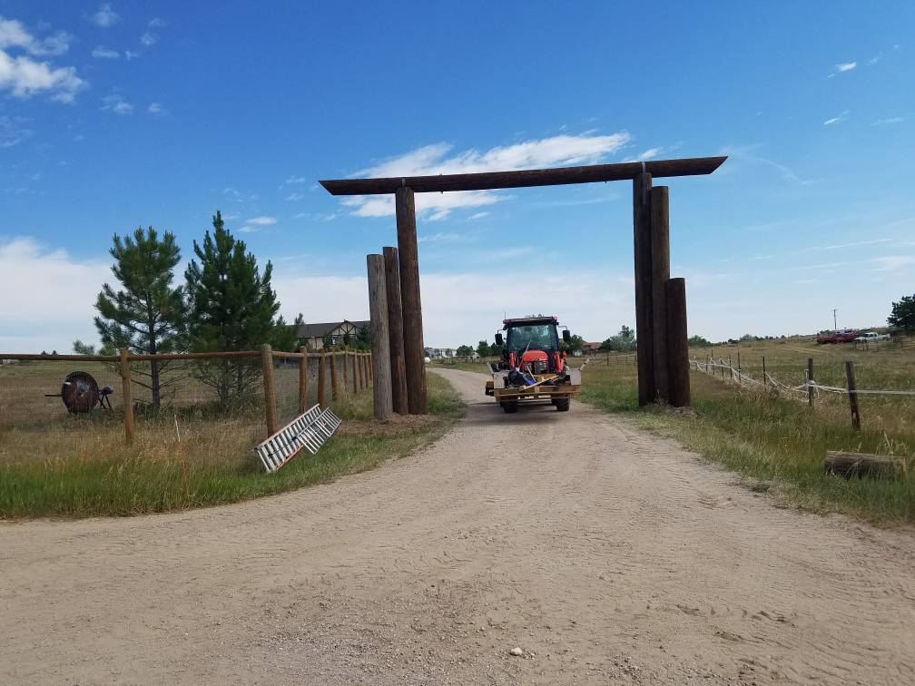

The 16' gate is about 150 lbs or so.
HD sells 6x6 square treated (Copper Azole) wood posts in 8' lengths for like $35. Problem with treated wood is that it dries out and can warp/twist over time. It never stays true and square.
I'm leaning towards getting a thick walled steel square tube post and anchoring that into the ground with concrete. Stronger and won't twist/warp like wood.
   / Tarter 16' Wide Steel Gate - Install #19
The weight isnt the problem, it's the leverage. Hanging 8-18' out there 50lbs generates way more force on that post than 500lbs close up.
I have some lighter 18' gates that havent pulled over my posts. Crossbars are 4' up, posts are burried 30" down. All tamped dirt rather than concrete. Properly tamped in our clay there was no difference in the force required to pull out 20 year old posts set in concrete vs dirt.
The most important part for me though is properly tensioning the fence & doing crossbracing. That wire transfers load into other posts & keeps everything tight & plumb. I hooked up the fence puller to the bucket on my L3200 in 2wd with no ballast. Backed up until it lost traction then stapled in the fence. Nice & tight with the crossbars keeping the posts from pulling over.
Speaking of crossbars, a really tall post & criss bar like a ranch arch looks nice & keeps the post from leaning. Definitely not practical to put up for most people on a driving gate. Good on a man gate though.20170711_102633.jpgDSC06434.JPG
