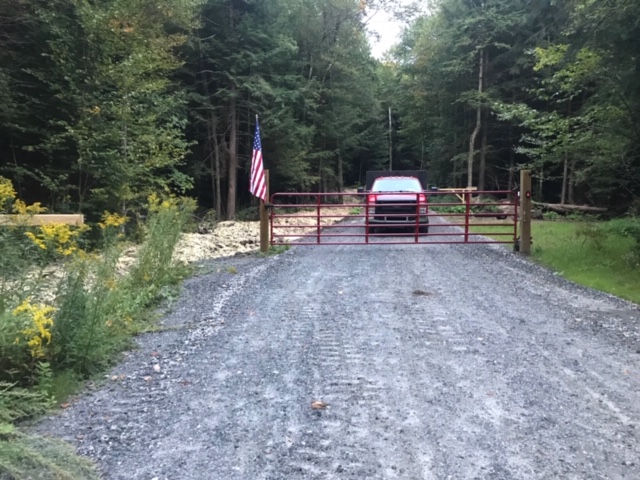

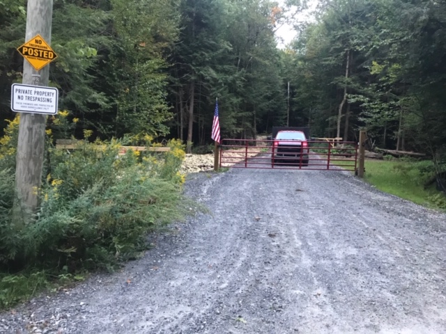

This is my heavy duty 20 tractor supply gate with mighty mule opener.
Posts are 8x8x12 PT 4 deep 15 80lb bags of quickcrete in each hole and the gate with hinges has a guy wire that goes back 40 in the woods.
I think the gate is around 250-300 lbs.
Finally should have the correct pictures posted of my 20' gate with mighty mule and 8x8 PT post.

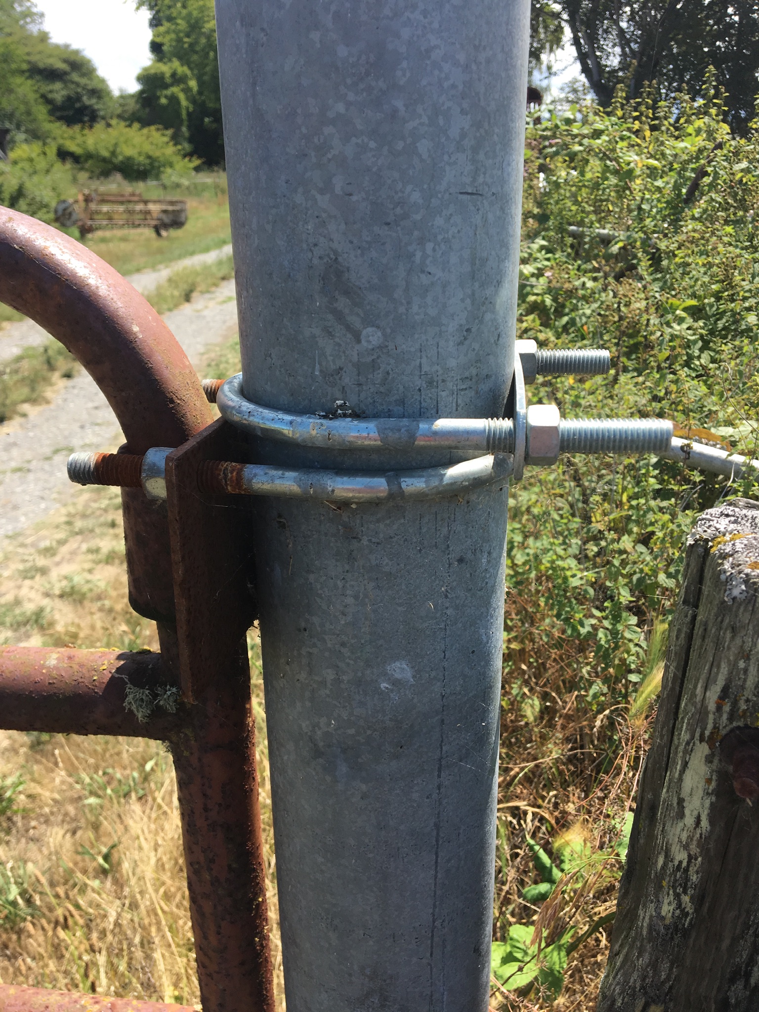

This is how I attached to my galvanized post. This is a farm gate, not a driveway gate so it is not as purdy as some of the others. The top U bolt is doing nothing, it just got left there.
