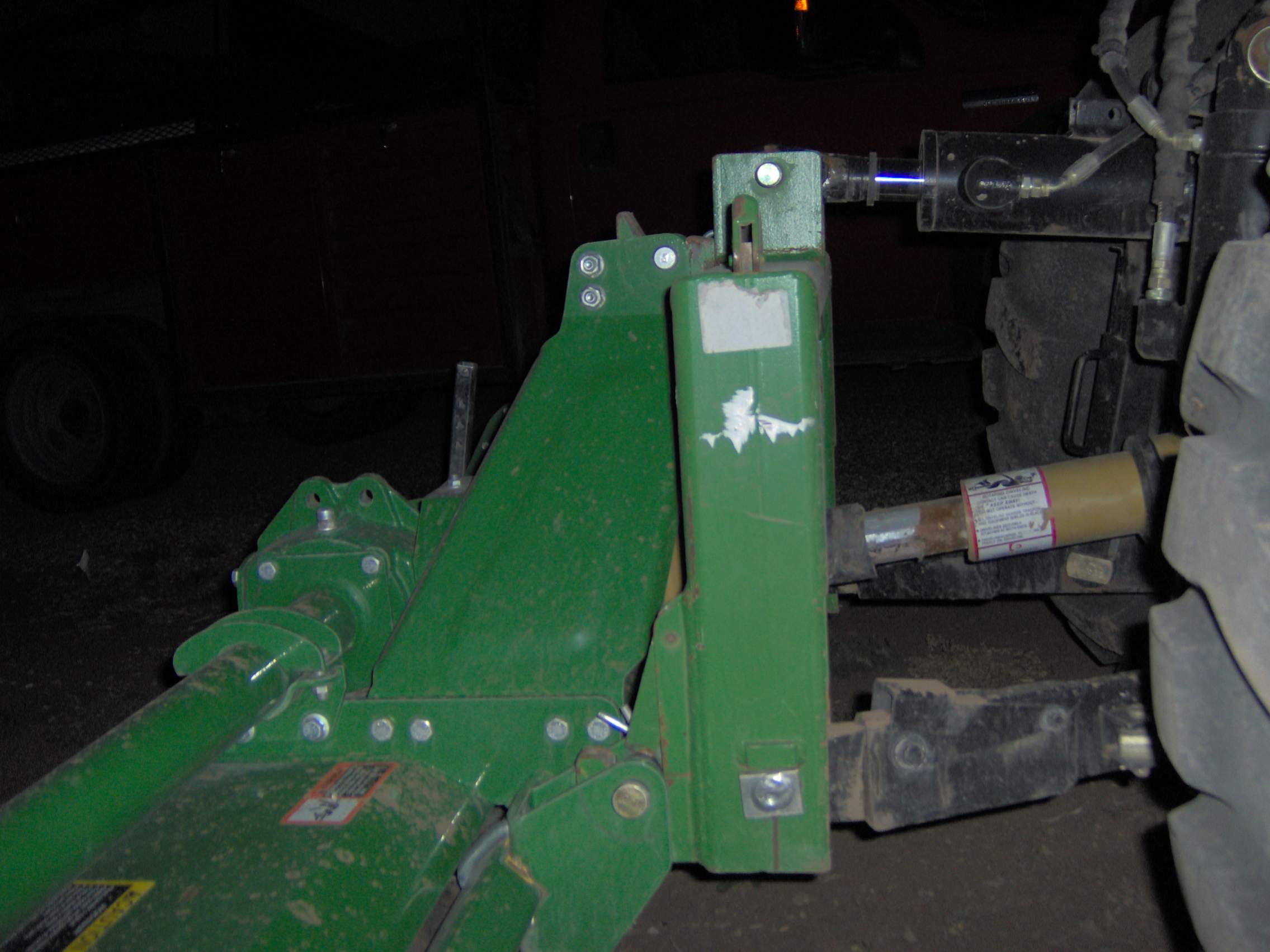

I've spent a bunch of energy getting this puppy set up. First: The adapter for the quick-hitch did permit me to install without cutting the PTO shaft but whenever I hit a root or good sized rock it would hop so violently the pin would jump out of the top hook of the quick-hitch. After spending a couple of hours with it I finally pulled back to the barn, disconnected everything and followed the procedure for marking and cutting the PTO shaft step by step. Shortened the shaft 3". But that steel was hard! Ruined my saw blade. Wound up taking me half a day to get this done but 2 hrs of trouble free use once hooked up directly to my 3-pt hitch was simply wonderful. And this puppy is leaving a beautiful tilled soil with just two passes for each row.

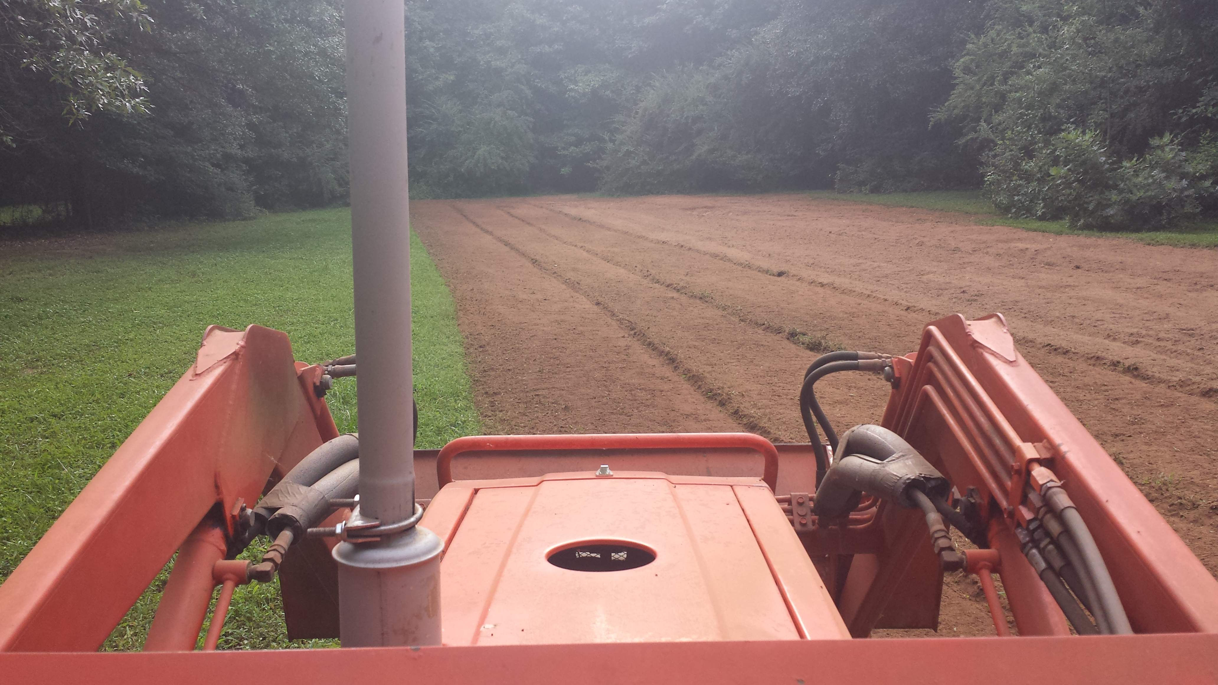

Thought the pic might be nice.

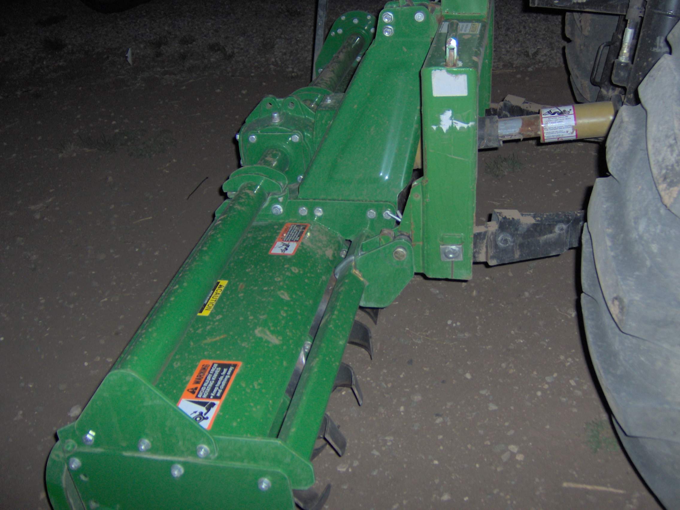

I've spent a bunch of energy getting this puppy set up. First: The adapter for the quick-hitch did permit me to install without cutting the PTO shaft but whenever I hit a root or good sized rock it would hop so violently the pin would jump out of the top hook of the quick-hitch. .
Do you have pictures of this hooked up? There is something wrong with your set up if an implement can jump out of the top hook on your quick hitch. I use a quick hitch with my tiller and other implements and have had no problems.
   / Tarter Rotary Tiller #19
I only have one photo that shows this and I've attached it for your review. I don't need an adapter for anything else and have no trouble with my middle buster, rake, or haul around attachments. The tiller is the first thing I've had with PTO power. I cut the shaft and will use the tiller direct connected to the 3-pt arms now. Very stable this way.

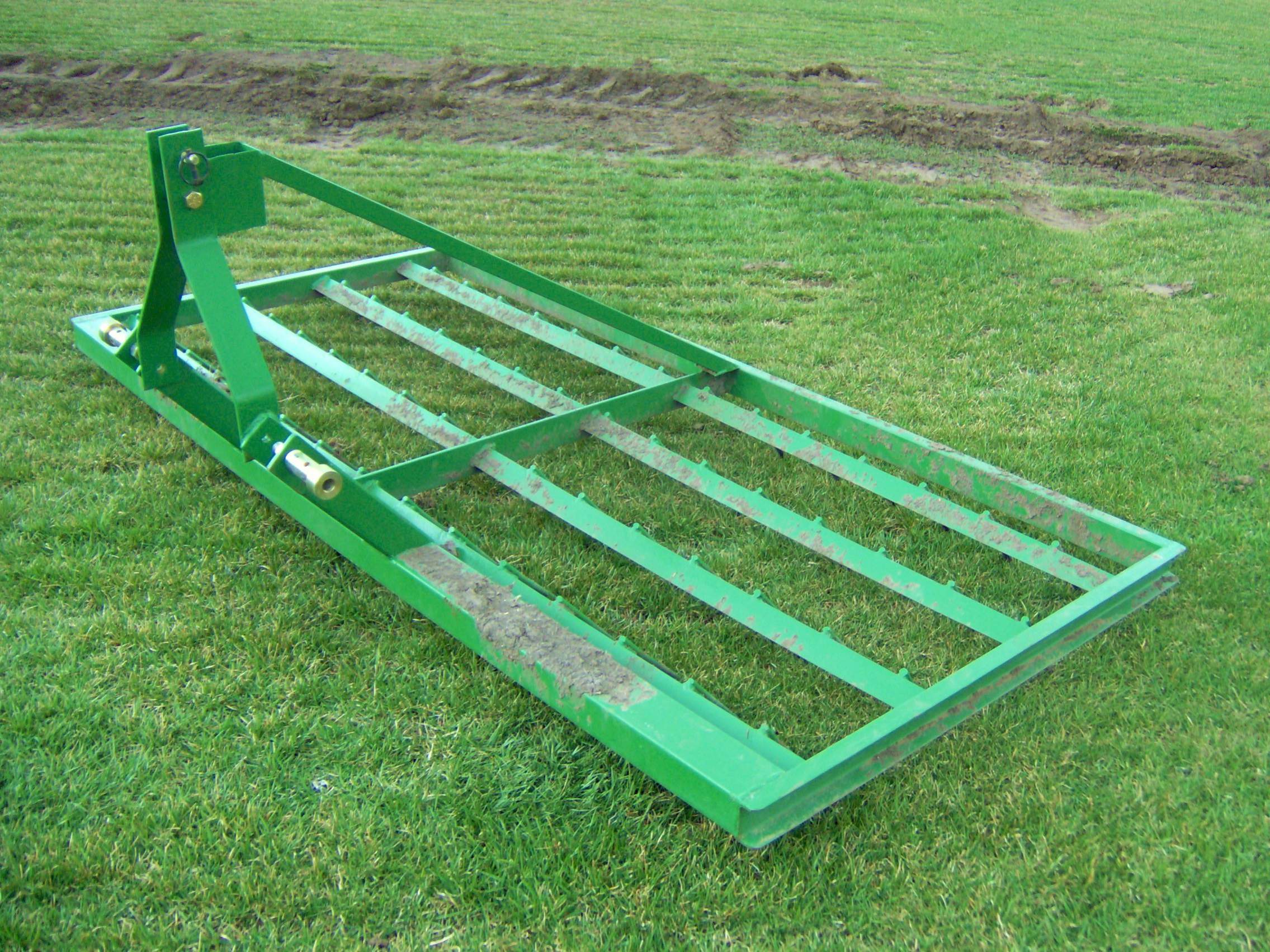

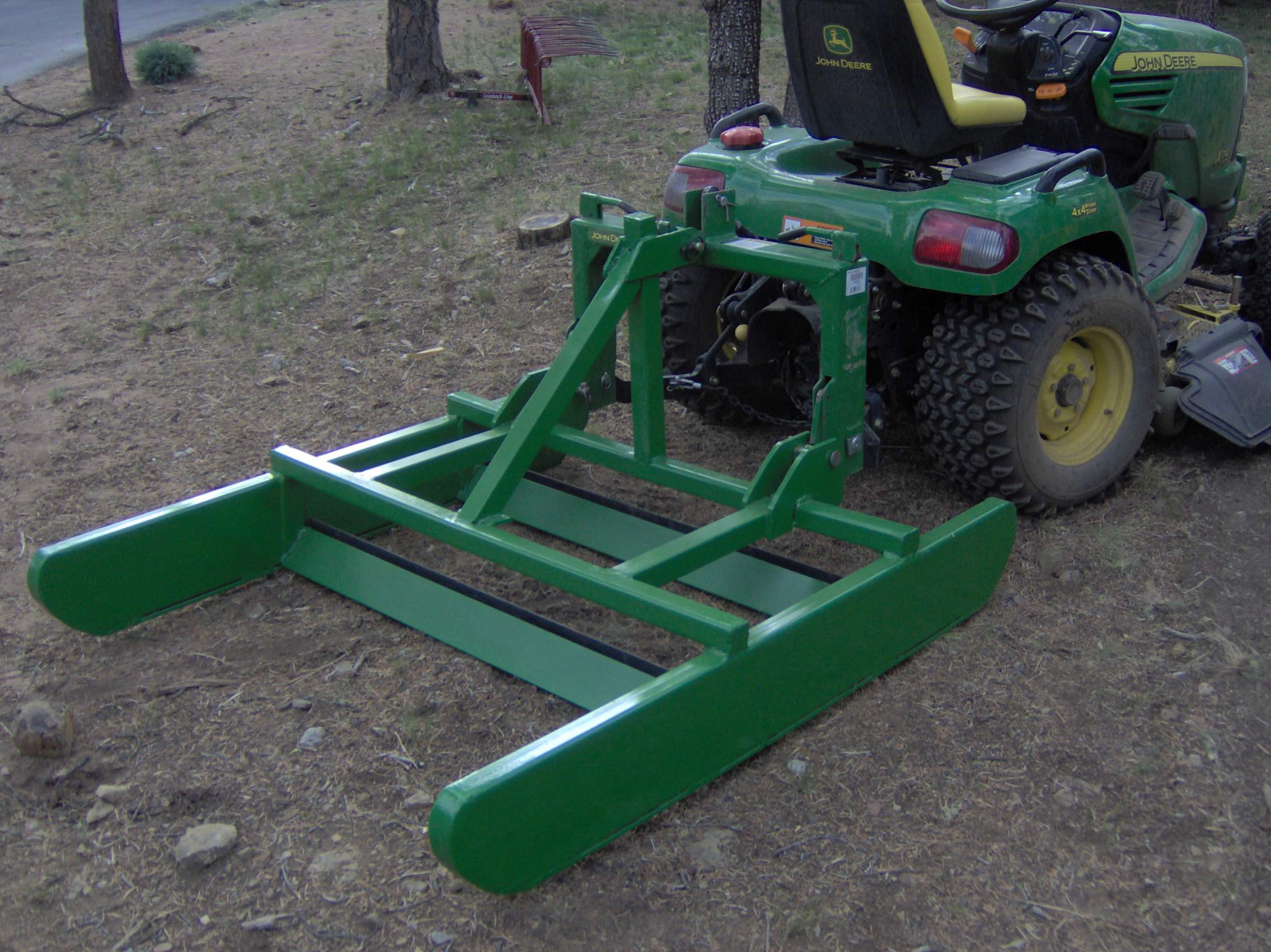

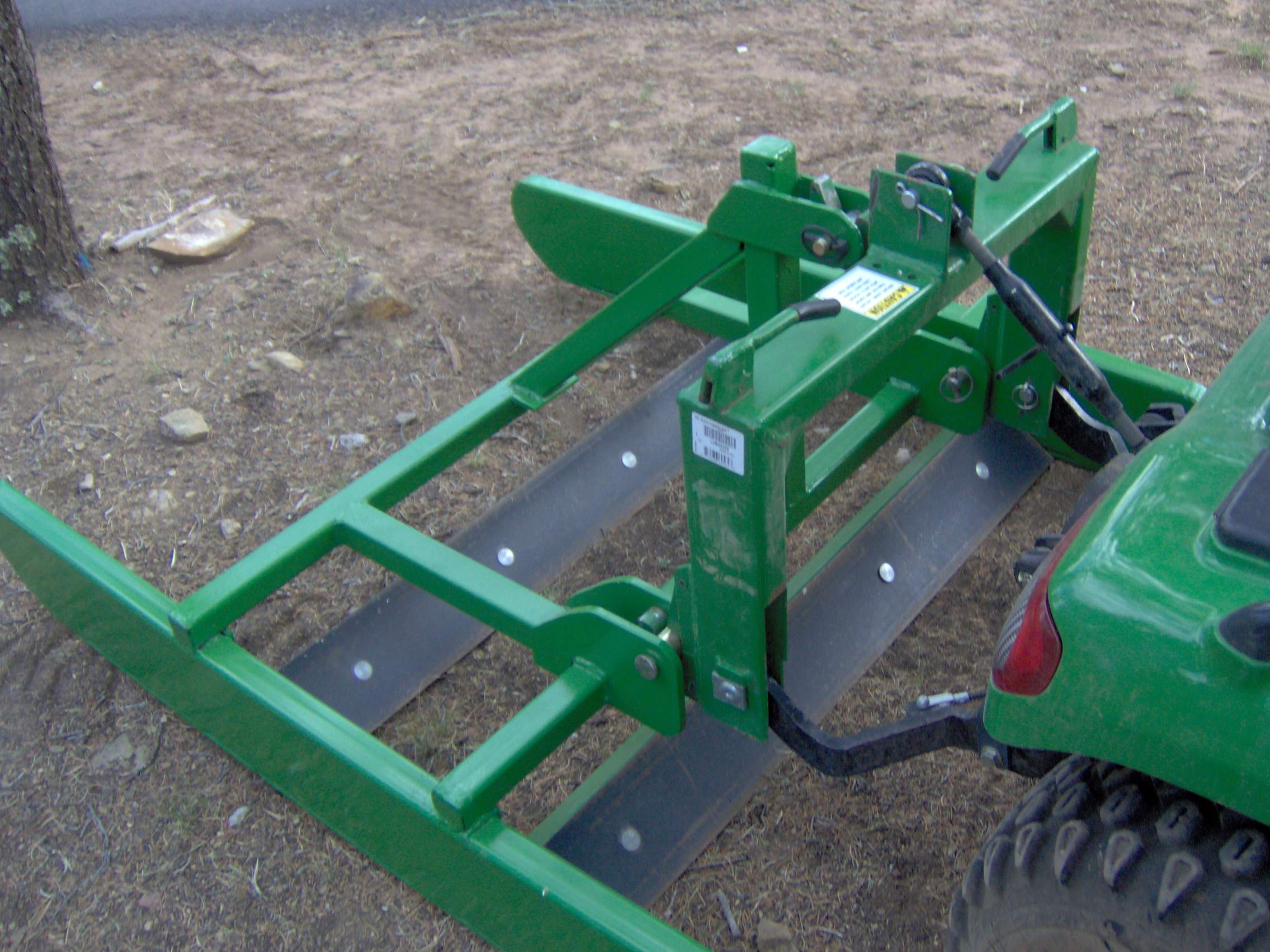

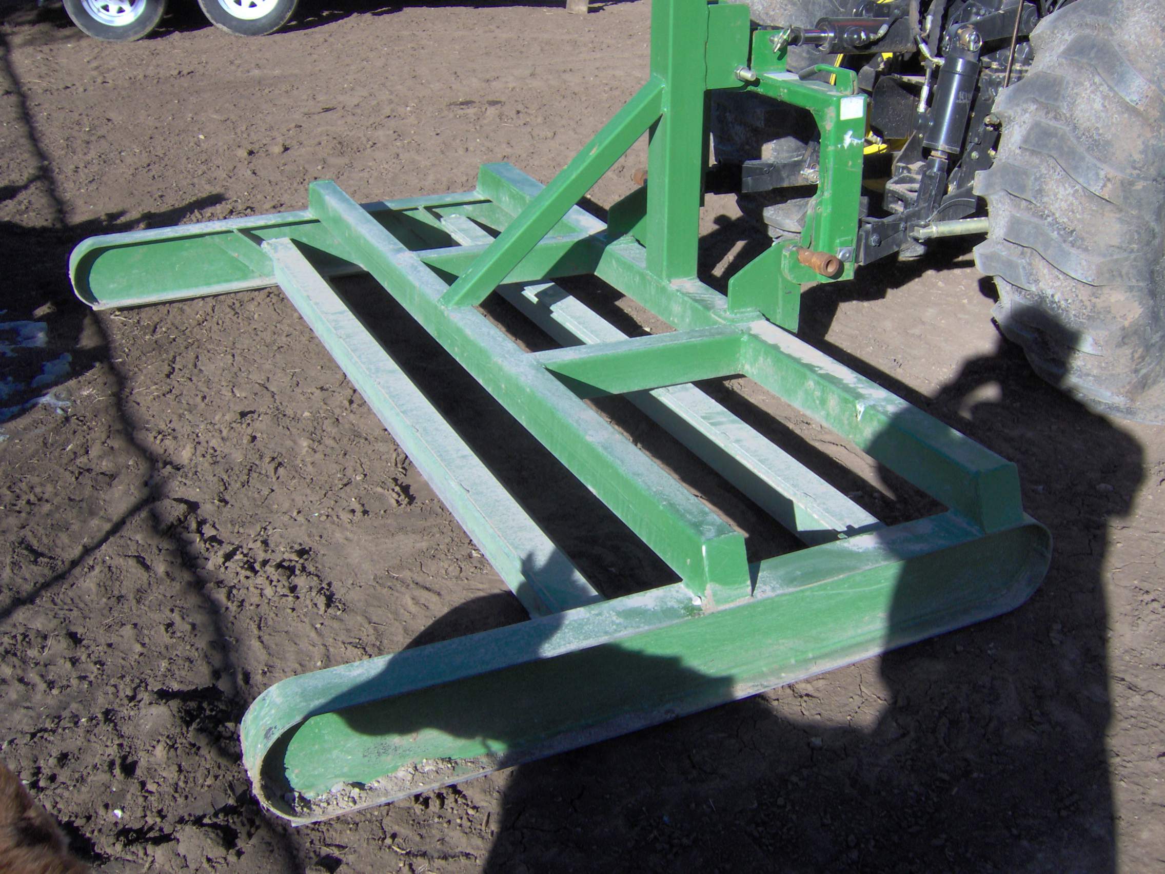

FWIW, you would need the proper lower bushings on the hitch pins to change them from cat 1 to cat 3 to fit the quick hitch properly. The top hook should fit the lower cross bolt on the top mast without the adaptor you have in place now. This would also allow you to unwind your top link to level the tiller properly.
While it may not matter to you now I can tell you that having a multitude of implements in later years it will. With lots of implements I can change them on a whim from the tractor seat. A properly set up implement and quick hitch means I don't have to be reluctant to change them out. It takes less than a minute to hitch up then raise parking stands and hook up the pto if it applies.

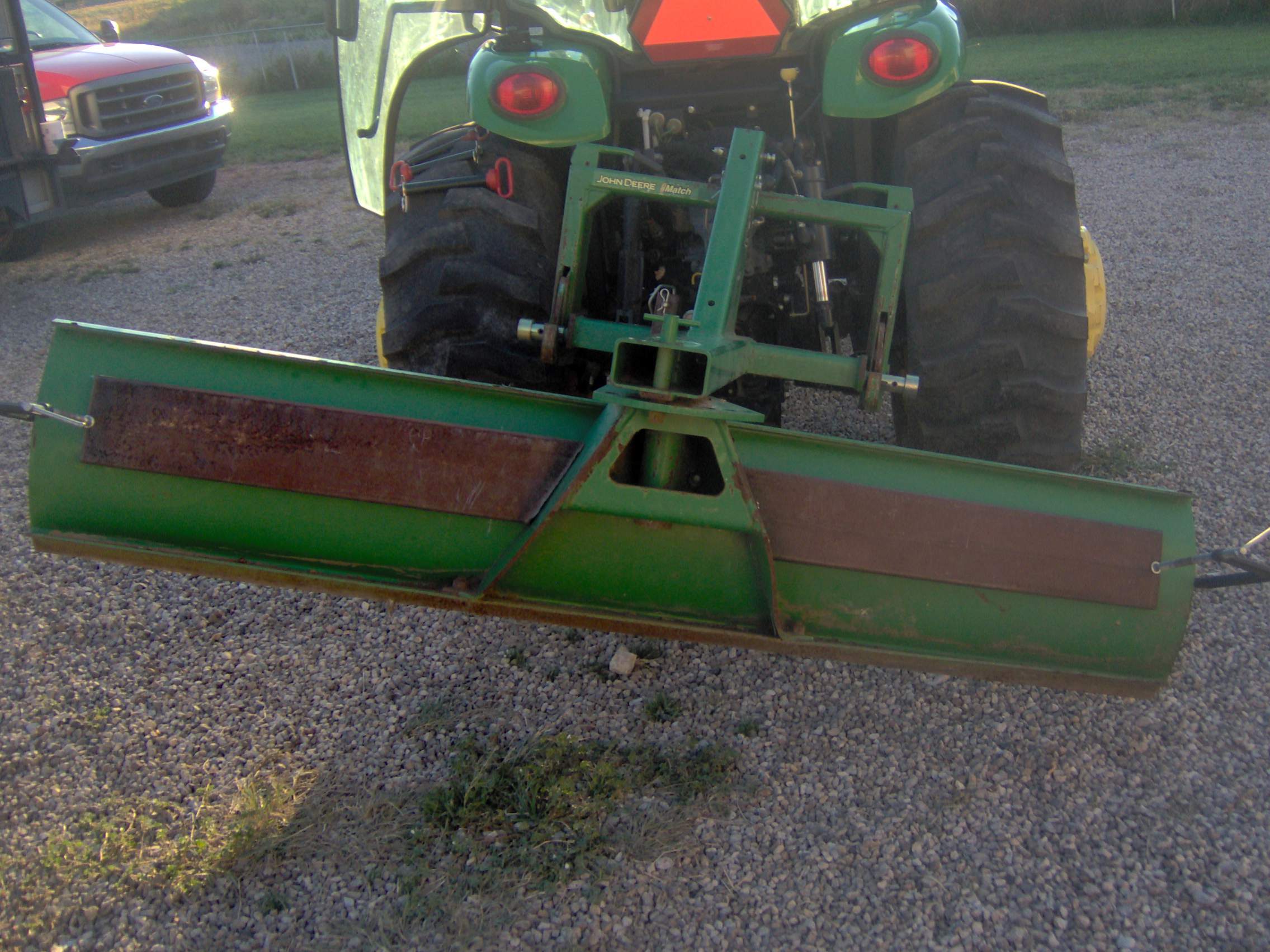

Here are some pics of implements set up for quick hitch. Notice the adaptors for the lower link pins on the 3pt harrow in the 4th picture. Also notice that if the lower bushings are in place and locked in there is no way for any of these implements to become unhooked at the top.
