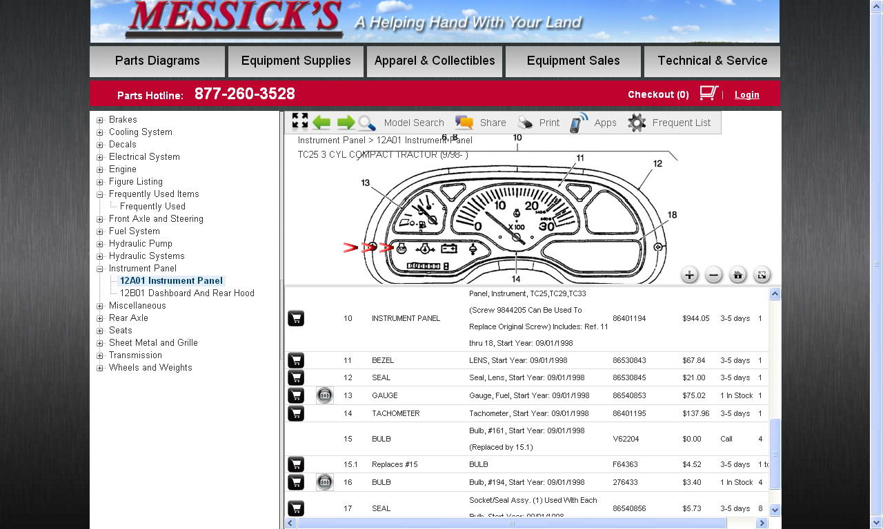

Sparc, your tractor's instument panel has a light that illuminates when the glow plugs are on. It's highlighted in the photo below by the three red arrows pointing to the lower left corner of the panel.

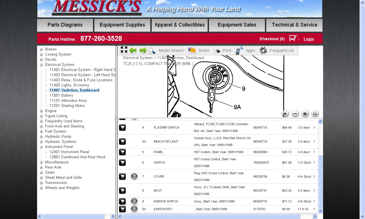

Also, your ignition switch is a 4-position switch as shown in the following diagram. The four positions are: OFF-RUN-GLOW-START. Probably what you did was to go beyond glow to start and never got your glow plugs powered.

I stopped over this afternoon and I see that yes there is a position for preheat but I see you have to hold the key manually in that position and wait, then turn to crank. Started right up once I did that but I waited 20 seconds and never saw the light go out. I figured it should have gone out by then being its only 52F here this afternoon. I also looked at the pedal linkages and figured out what the two red pedals do. One is a foot throttle (my last tractor this pedal was green), and the other is the brake lock lever, whichstrangelyy you can't engage with your foot without coming in contact with the foot throttle.

Started right up once I did that but I waited 20 seconds and never saw the light go out. I figured it should have gone out by then being its only 52F here this afternoon. .
The larger models have a timer/relay for the glow plugs. My TC-18 does not have this, and the glow plugs are energized for what ever length of time you hold the key in that position. I would imagine the TC-25 is the same.
Guy.
/ TC-25 Questions #10
Guy.
I think you are onto something Guy. The "D" deluxe HST models have a timer, but the gear models do not. I saw that when I was looking at parts diagrams.
