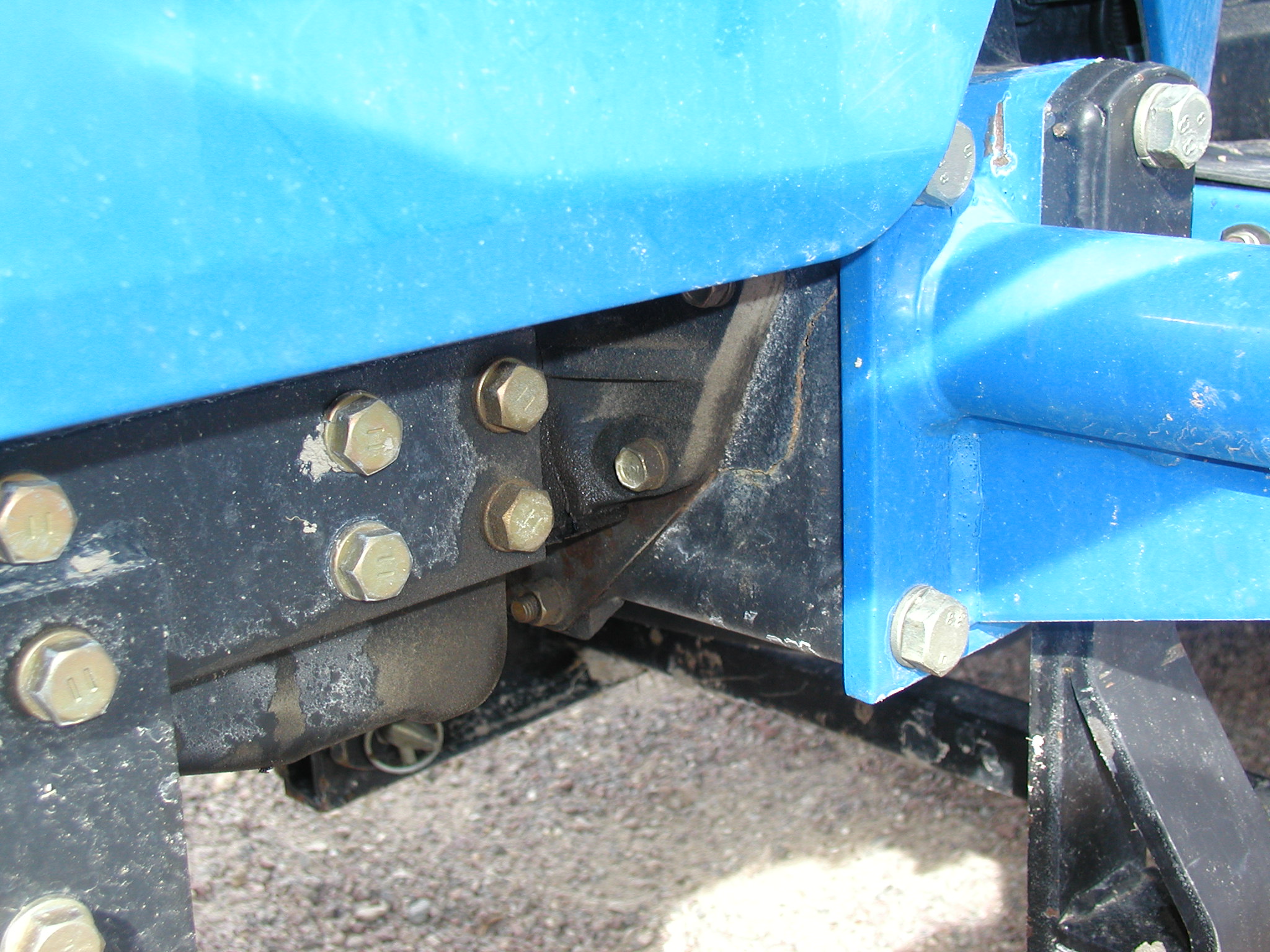

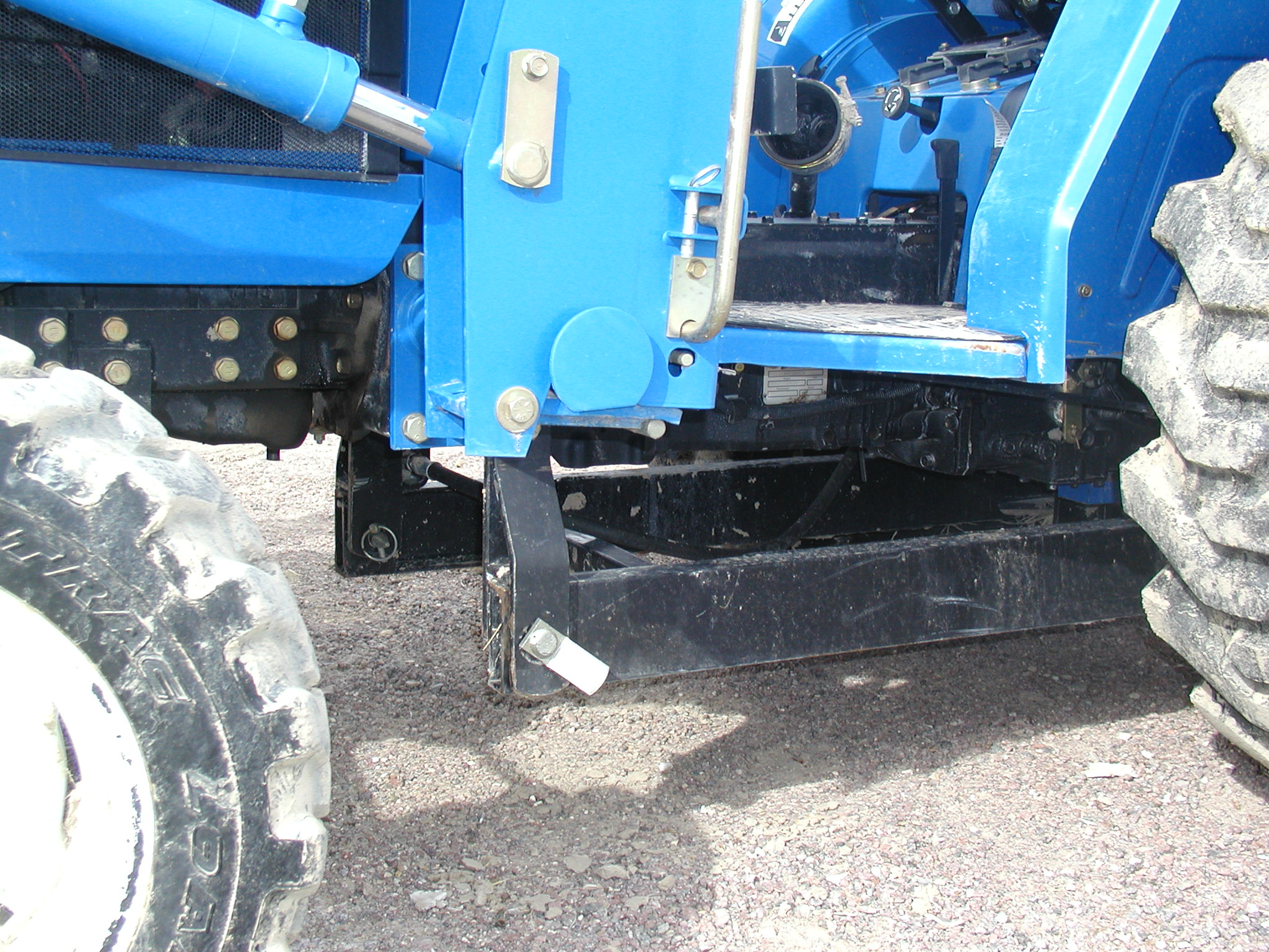

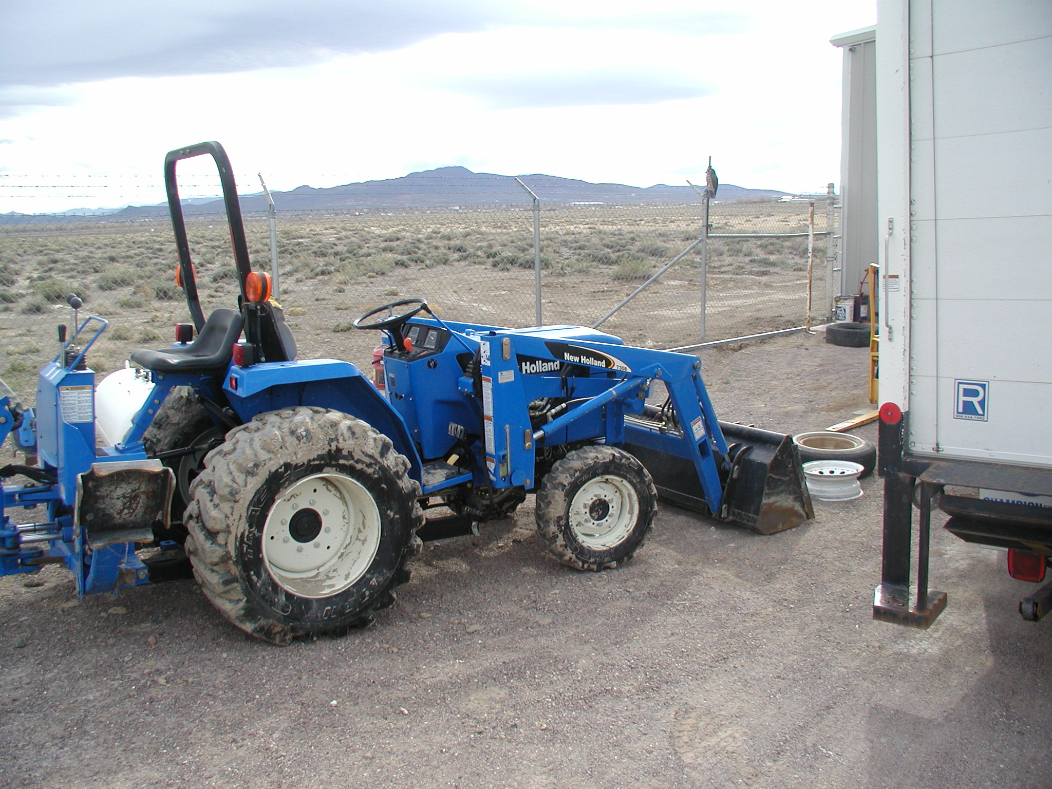

hey chuck thanks for the post. ill be happy to trade pictures with you. im supprised that your dealer built a subframe for yours if you use all nh parts you dont need one....ha ha ha...........
as you will see the block and the trany make up the frame and everytime i use the loader or the hoe it puts stress on the block and the clutch housing.
i did consult with some folks and they all agree that this tractor needs a subfame to take the stress. so until i find a replacement block ill just keep welding the crack, im geeting good at it, at witch time ill tear the whole thing apart and install a frame at the same time install a block. and if it works ill tell every one that i got the information on this forum and not from nh who should have known it needed one in the first place...interesting fact i looked at an old kabota tractor about half the size of a tc30 an it had a subframe on it that went front to back and the implements were hooked to that. just goes to show you friends of ford are always looking for a better way....:laughing:
as you can see the front bumper and fel attachment run along the engine block to about 4 inches shy of the clutch housing and then everything bolts to the clutch housing leaving the last few inches of the block and front of the clutch housing takeing all the touque. if these pictures are not clear enough let me know and ill take some more
thanks for your intrest and help mike
