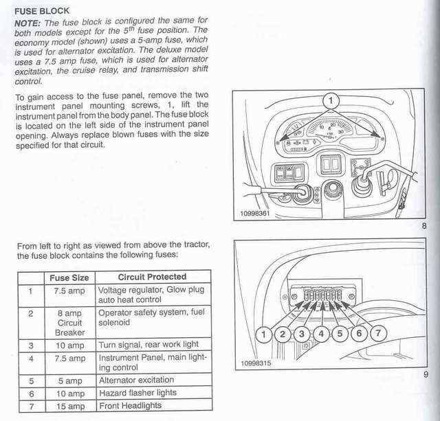

Hi everyone and thanks for the help. Here's what happened-
Somehow the wire underneath the seat connecting the safety switch came undone. It was late at night when it happened and I couldn't see that. That is why the tractor died, but would start when the parking brake was activated. That's also why when I put it in gear and released the brake, it died again.
I reconnected the wire and it still wouldn't start. PTO light was still "on" the console. Pulled instrument cluster to get at the fuse box. The 7.5 amp fuse for the PTO was blown. Not sure what caused that, but put in new fuse and everything works great!
Happy ending and my 35 is humming along again. Thanks!

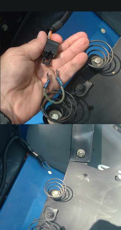

WOW! Most of us only have one of those problems at a time, but you got "lucky" and got two of the problems at once. /forums/images/graemlins/tongue.gif /forums/images/graemlins/laugh.gif
Now I wouldn't want you to do anything "unsafe" and jumper around your seat switch all the time like I did. But if you were gonna do it, it would look just like the attached photo. /forums/images/graemlins/blush.gif

</font><font color="blue" class="small">( Now I wouldn't want you to do anything "unsafe" and jumper around your seat switch all the time like I did. But if you were gonna do it, it would look just like the attached photo. /forums/images/graemlins/blush.gif )</font>
What a coincidence. The jumper I don't use looks exactly like that. /forums/images/graemlins/blush.gif
My dealer didn't see the non-existent jumper either. I know that because he told me "I didn't see that".

...and you never stand up on your tractor and take your seatbelt off either. /forums/images/graemlins/smirk.gif I know a guy who used to have a TC29 and he'd hook a chain to a tree, start the tractor pulling, and then get off and take a break. /forums/images/graemlins/shocked.gif
You don't know that guy do you? /forums/images/graemlins/wink.gif /forums/images/graemlins/laugh.gif
Hey, Brad_Oatley, check out the attachment. You have to take out the instrument cluster, but it's easy as pie. /forums/images/graemlins/cool.gif
