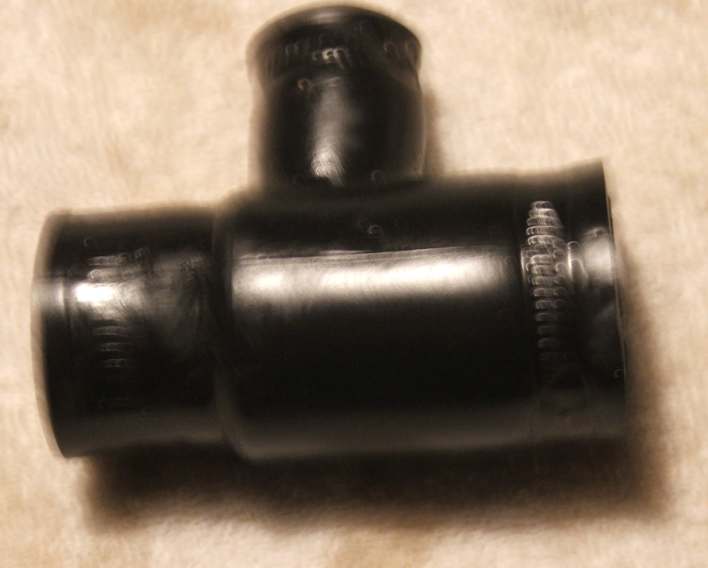

That rubber T is the hydraulic supply from the reservoir. The small line is feeding your HST transmission. The large part goes to the main hydraulic pump and may be a source of air leaking into the pump. You probably have air getting into the HST charge pump line too, but it seems you still have enough oil to keep the transmission going, at least at low speeds. I think you got lucky because you may take care of your leak by simply retightening the clamps. Chalk one up for the good luck column.:)
I can't really add much to what IronHorse has suggested. I think you'll soon have your TC off the stumps and be back in business. That also looks like a fair location to work. You could have had the tractor surrounded by a bunch of brush. It looks like every side is very accessible.

good evening tractor friends,replaced clamp with negative results,so I removed rubber hose tee and discovered puncture. does anyone have a parts diagram so I can order a new tee? I could drive to the NH dealer with part but want to make sure its on the shelf before wasting half a day. thanks again,Cary

Try Partspring.com at this page, HST Piping section 7.11, Part #9. (Connector 3-Way.) My TC40D parts list is number SBA398120870. My scanner has siezed so I can't scan the page.
   / TC 35 Stuck on two stumps #17
And in addition, Messicks.com has the part;
CONNECTION, 3 WAY
SBA398120870
1 Needed for Job
$20.73 Avail in 3-5 business days
If Messicks does not have it in stock, then I'd bet your dealer does not either. But at least this will get you started.
