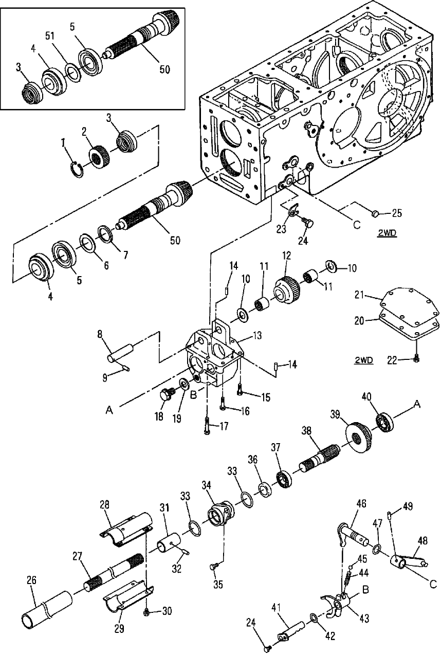

Rick, I think your problem may have started from the 4wd lever being bent and leading to 4wd not being fully engaged when the lever is all the way forward in the slot. To test this, I'd shift into 4wd without the tractor running and mark where the shifter goes to as it enters the shifter on the bottom of the transmission. Disconnect the linkage so you can rotate into 4wd without the linkage attached and see if the shifter shaft doesn't rotate a bit more. With the 4wd in this position (with the shift lever disconnected) drive your tractor to see if it will stay in 4wd without jumping out.
There's a chance that you have worn/damaged the gears so that they are now beveled and want to jump out of 4wd. I don't mean to say that this is your fault, it's just something that MAY have happened. If you are lucky, only your shifter linkage is bent and you may be able to manipulate it so that 4wd is more fully engaged.
I've attached NH's illustration of the 4WD driveline shifter box. In the illustration, item 50 is the rotating shaft inside the transmission. This shaft drives an idler gear, item 12. Item 39, is a gear that drives the splined output shaft, item 38, of the shifter box. It slides back and forth as you shift into and out of 4WD as a function of the shifter fork and shifter shaft (items 43 and 46) moving against the bearing, item 40, that pushes the sliding gear into position. I would disconnect the lever (item 48) from the handle linkage and try to engage 4wd using just this lever to see if could rotate the shifter enough to make 4wd stay engaged. That will tell you if your problem is internal or just bent shifter linkage.

Rick, I don't know how mechanically inclined you are, but disassembly/reassembly of the gearbox requires careful attention to the orientation of gears and thrust washers as well as needle bearing assemblies and sealing o-rings that need to be renewed when the gears are removed. You also have to drain the hydraulic fluid (probably about 7.5 gallons) and drive out rollpins with a drift-punch to remove the driveline going to the front wheels and also a shaft inside the gearbox has a rollpin retainer.
One nice thing about the gearbox is that you can remove it and inspect it without having to take it apart. If you see something wrong or a gear that needs replacing due to wear, you could probably take the whole gearbox to a dealer and get them to replace the worn part. That would save your having to take your tractor to the dealer. Once you have the driveline removed to the front axle, all you have to do is drain the hydraulic fluid and unbolt the gearbox to remove it. If you decide to go this route, be sure and write down the serial number of your tractor to take with you. In some instances, parts have changed slightly with different models of tractors. I don't know that it's needed, but having the serial number is just a good thing to do.
BTW: The idler gear and the sliding gear that mates to it are about $88 and $125 respectively. The illustration I posted is from Messicks. If you go there, click on the New Holland emblem/logo and then enter "TC40" into the block and look up your part under the Transmission head as "FWD Drop Box and Drive Shaft" heading. A complete list of parts and prices are listed by reference number callouts.

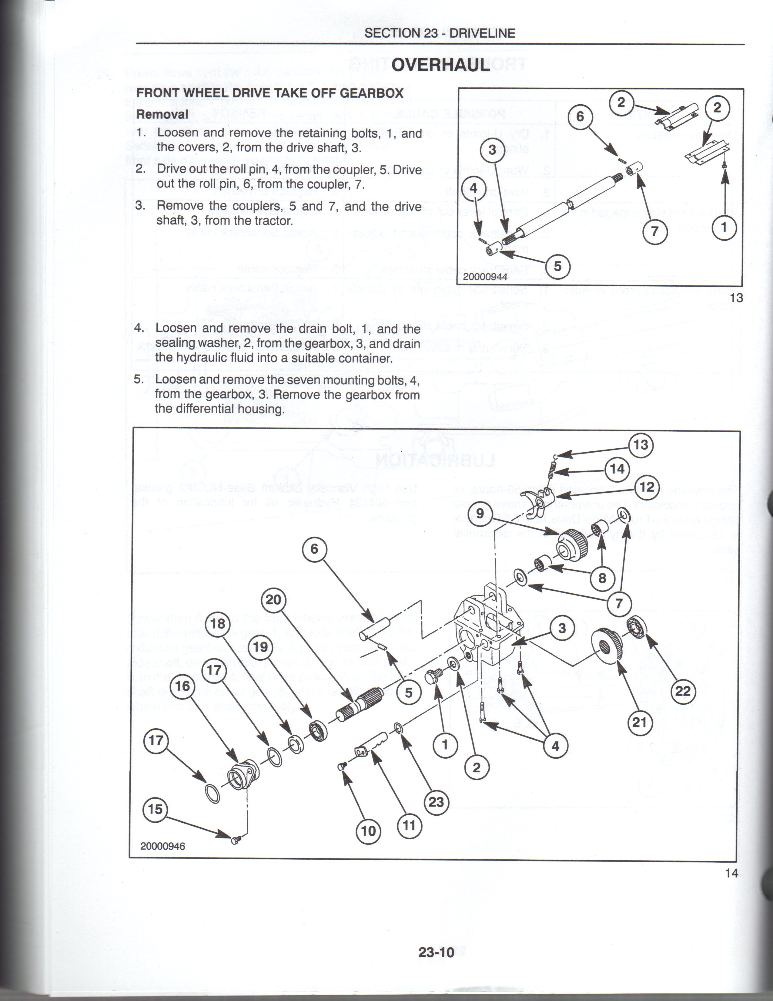

Dang! Rick, I had high hopes it was just bent linkage.:(
Here is what I'll do for you. If you'll PM me with your regular email address, I'll email the pages out of the Repair Manual that apply to removing the 4WD driveline and dropbox. I want you to realize that I've never done this removal and disassembly. I have no expertise or experience beyond what I can read in the Repair Man'l. What you will have is written instructions for removal, disassembly, and re-installation. With that and the parts, an experienced mechanic should be able to do the job. You may even decide that you are confident enough to do it yourself. Just please realize the limits of my ability to help. After sending you the pages, I'll just be a cheerleader.:D
   / Tc 40 D keeps slipping out of 4wd!!! #9
Rick1397 I have been following your dialog with Jim and feel your pain. Before you start removing parts I just wanted to be sure that you followed Jim's instructions and did not just "try it with linkage disconnected". Review his first paragraph of his entry dated 3-19-10 at 10:11AM. Were you able to disconnect linkage and shift back and forth from in gear to out of gear? Did the shifter move further without the linkage than with linkage? Did you still get the problem when shifter was rotated all the way? I am just asking these questions to save you a lot of unnecessary work if it is not needed. These linkages do bend easily and impede the length of travel. Lets hope you have not damaged the gears. Best of luck, Frank
   / Tc 40 D keeps slipping out of 4wd!!! #10

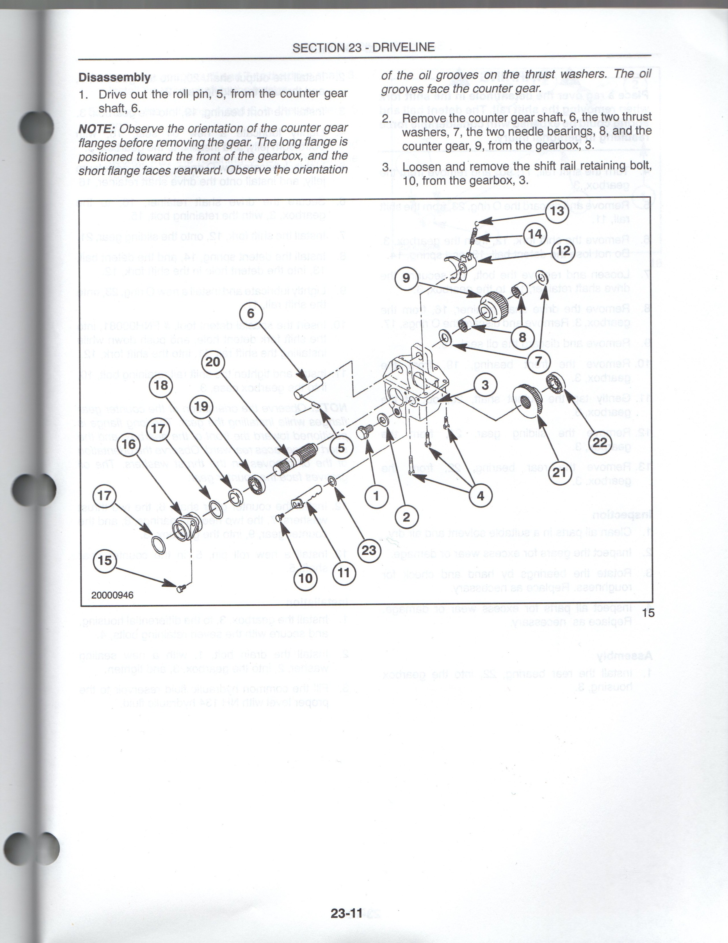

I've just been looking in the repair manual section 23-4. This might not be that bad. It looks like the 4wd engagement is a small gearbox hanging off the differential. It does not appear that you need to split the tractor; the gearbox can be removed directly. I guess that makes sense when you consider that some tractors are not 4wd (and this gearbox adds that capability). From a manufacturing standpoint you'd like that to be easy to do. Notice detent ball #13 and spring #14 in the 3rd attachment. I think that holds the shifting fork (#12) into position. Part #12 shifts sliding gear (#21) into engagement for 4wd. Attachement #1 explains the overall operation.
