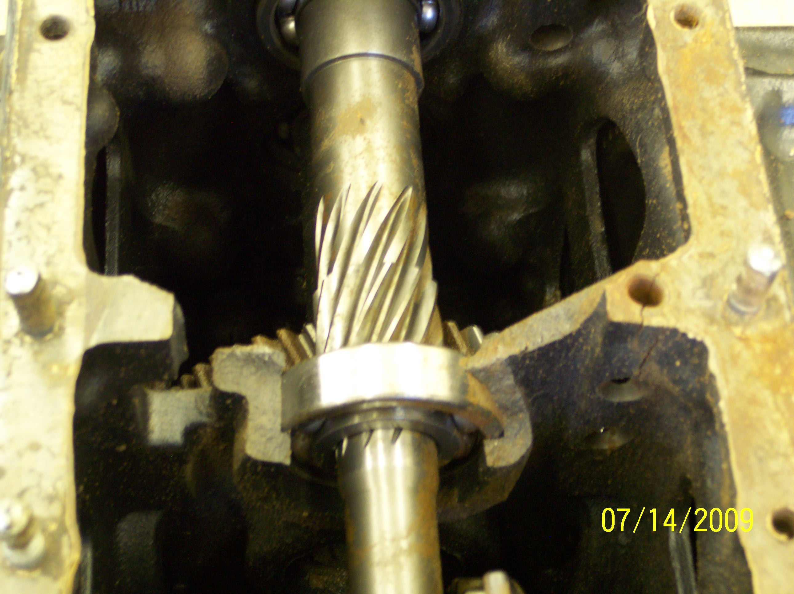

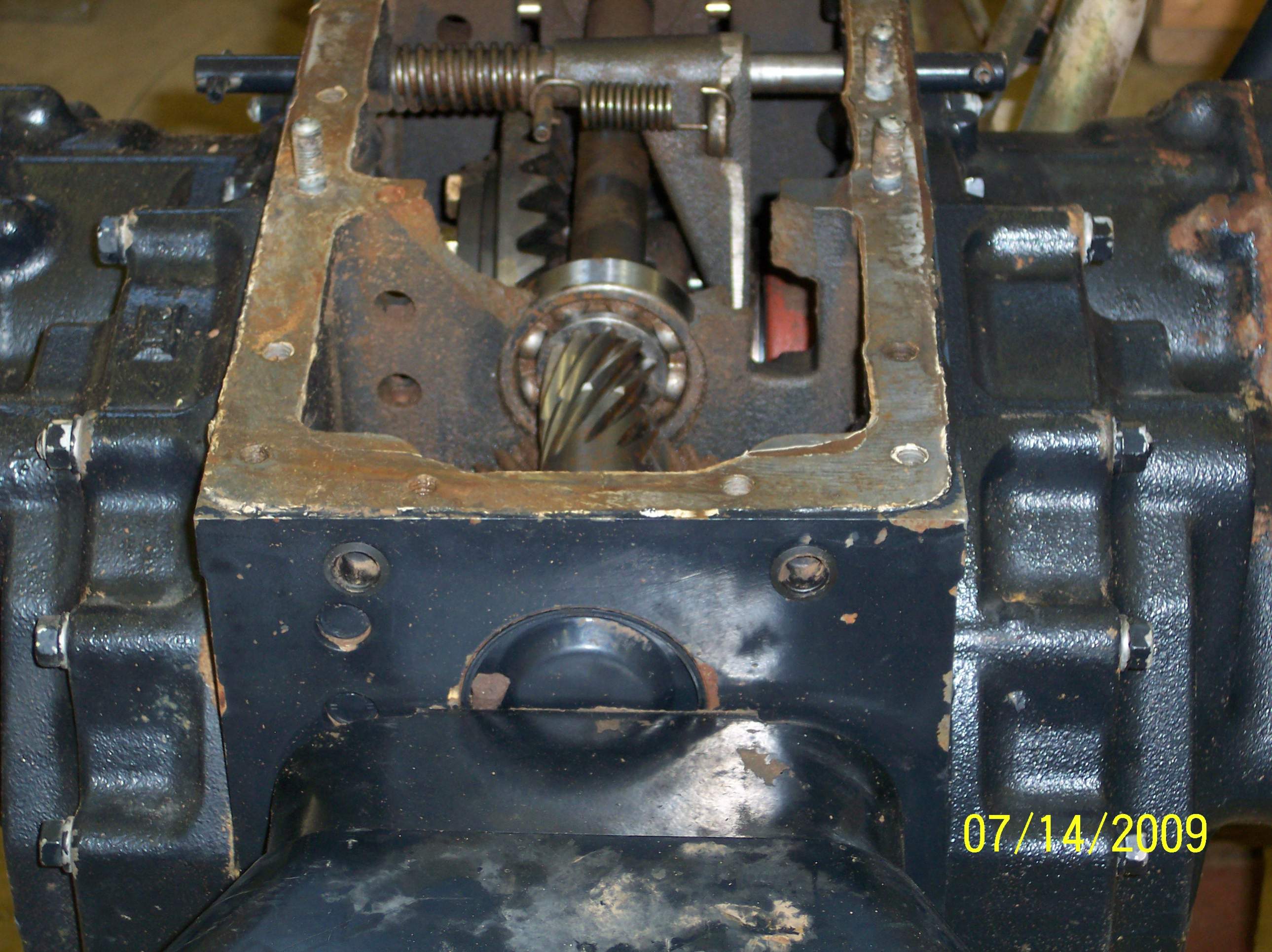

Ok so I am new user and I started a thread on rebuilding my rear differential but I started it in general service section. I think this might be a better place since its blue. I bought this tractor broken for a reasonable price and I am about to start the differential swap out and I am looking for advice, such as tricks, tools and problems I mught encouter. I seems straight forward but I am still wonderig if a $500 service shop manual is worth the price. Hear are a few pics of what I am getting into.

I would do a search on ebay and get a service manual. I think they are worth there weight in gold when doing any repair. Any idea on how the case got broke. I would put a dial indicator on the shaft and make sure it is strait.
Bill
   / TC 45D Rear Differential Rebuild
The story I got about the broken case was that it was from the backhoe that was mounted and/ or the oversized turf tires. My only though on this is a torsional twist of some sort that caused the web to break. I would not think that a frame mounted backhoe could do this but since I have never mounted the backhoe I am not sure where the force is applied. Good thought on checking the shaft and I will be sure to do that. I would hate to find out the hard way.
Thanks for the link that is the best price so far. I think I will get one to be safe. Another member is going to send me the pages for the trans. case rebuild but I might need the manual down the raod. Thanks to Djaustin for offering to copy and send the pages. The local dealer said it was most likely caused from a PTO shaft that was tool long on an impliment causing the bearing to be forced against the case.

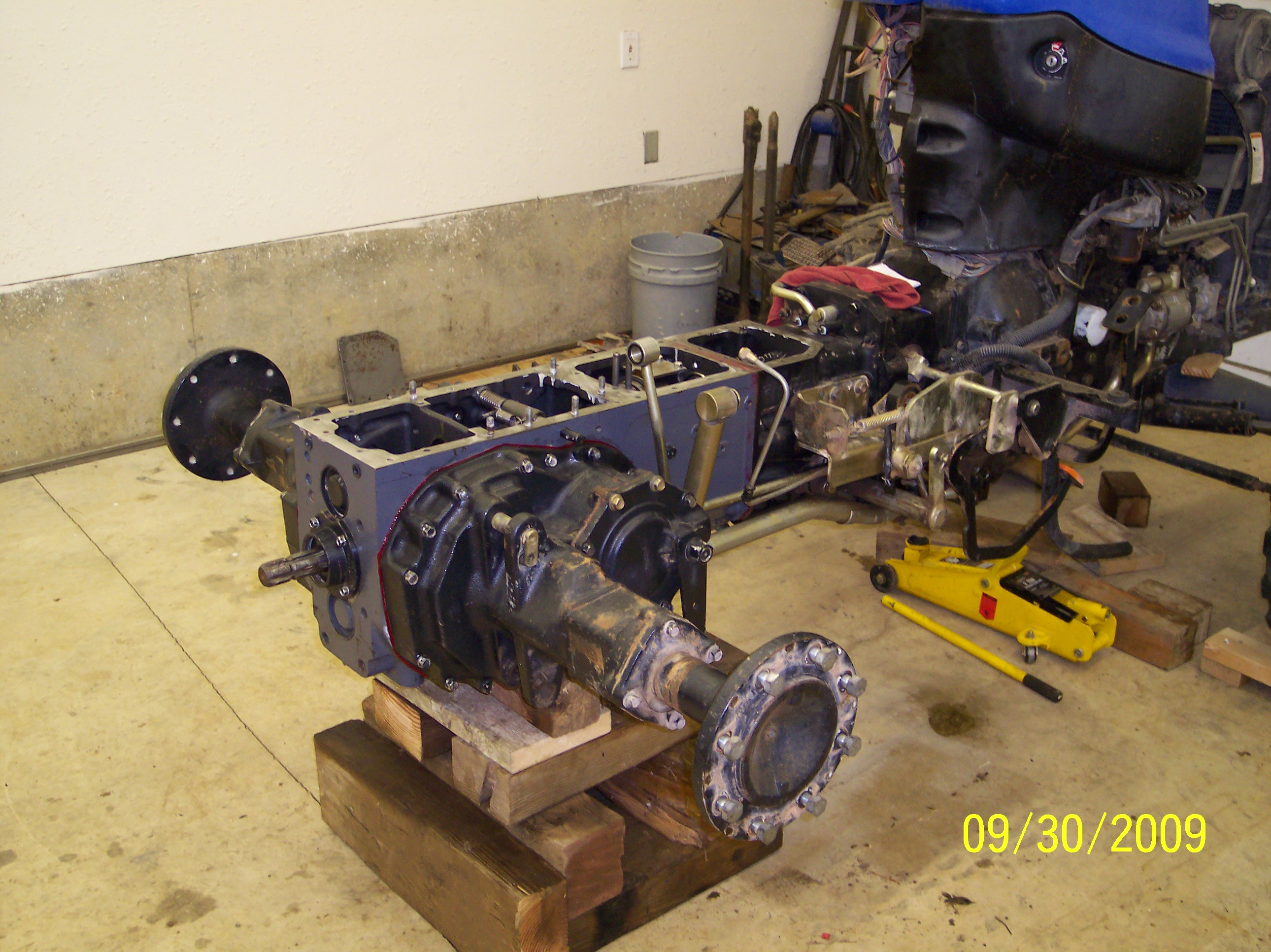

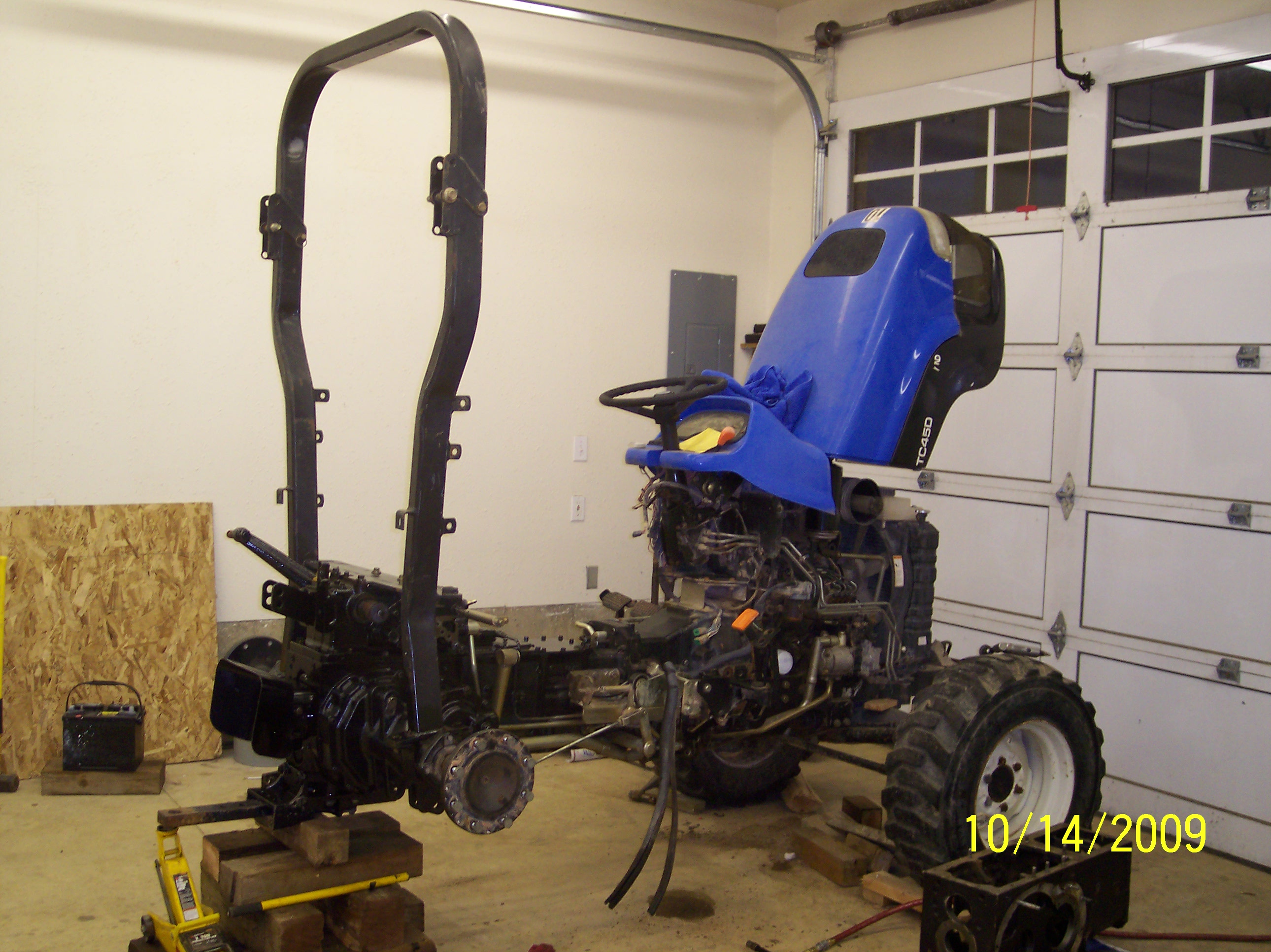

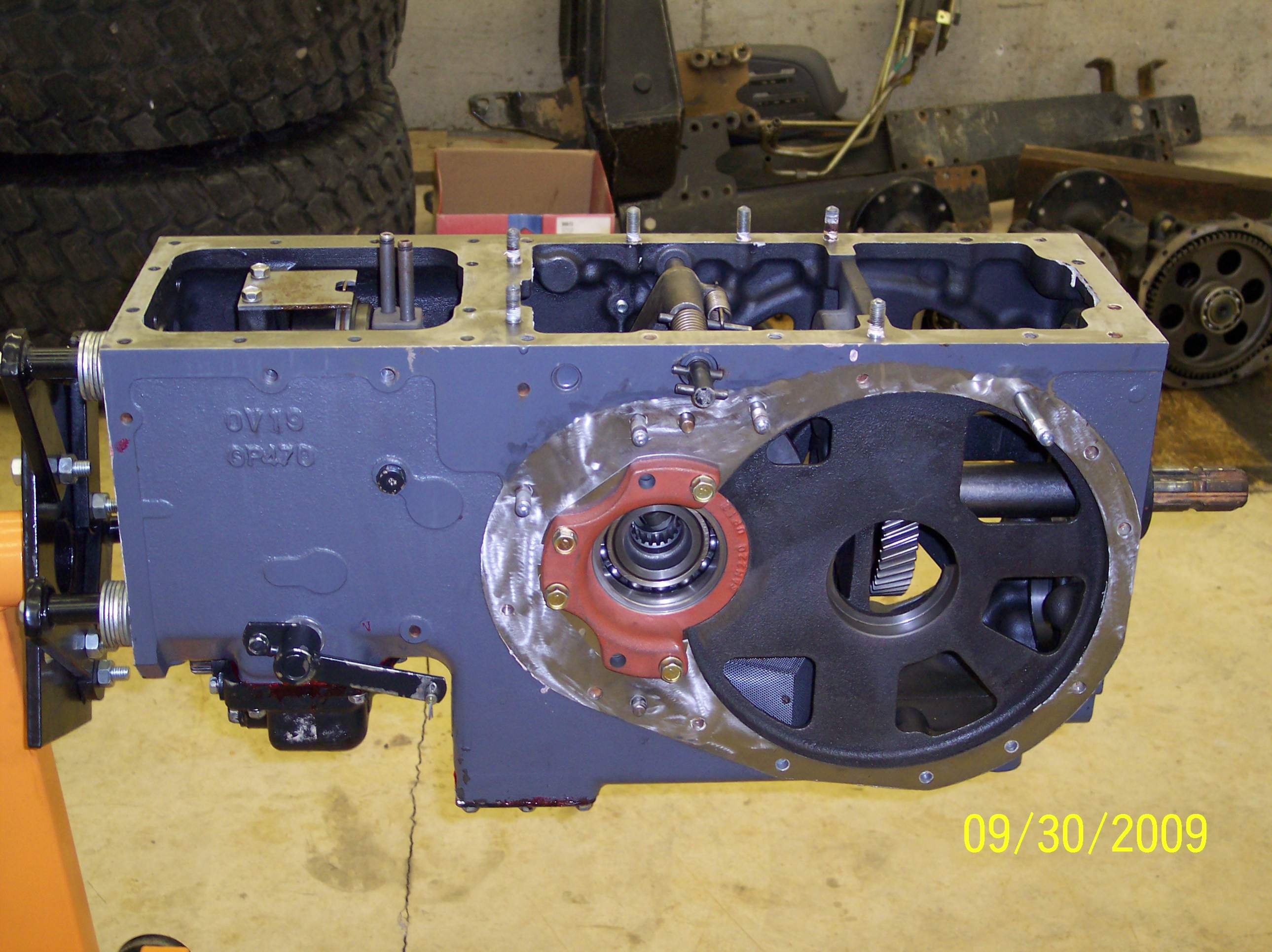

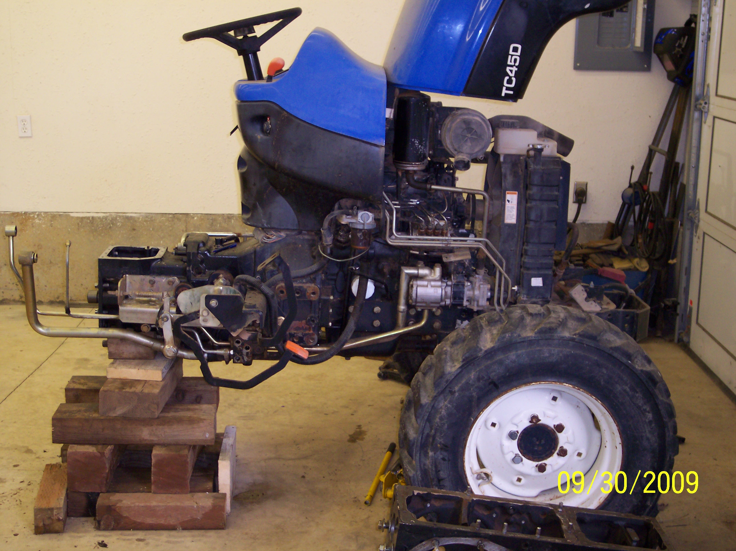

OK here is the update. Sorry it took so long but I have been deep in tractor land. So the transmission swap has been completed. Not a super hard task but you just have to keep all your ducks in a row or you will pull your hair out. The "new" case is from a tractor that was being parted out. The rebuild was easy since gears and bearings on go in one way most of the time. The actual rebuild only took a few hours. The tear down and renounting took about a half day. The most difficult part is that there are so many little parts and pieces missing and since I did not start this project I am left to finish it and buying a lot of nuts and bolts and misc. parts. My dealer has been great and the local tractor wrecking yard knows my name. Here are some pics where I am at now. Cheers. I just hope it runs after all this.
