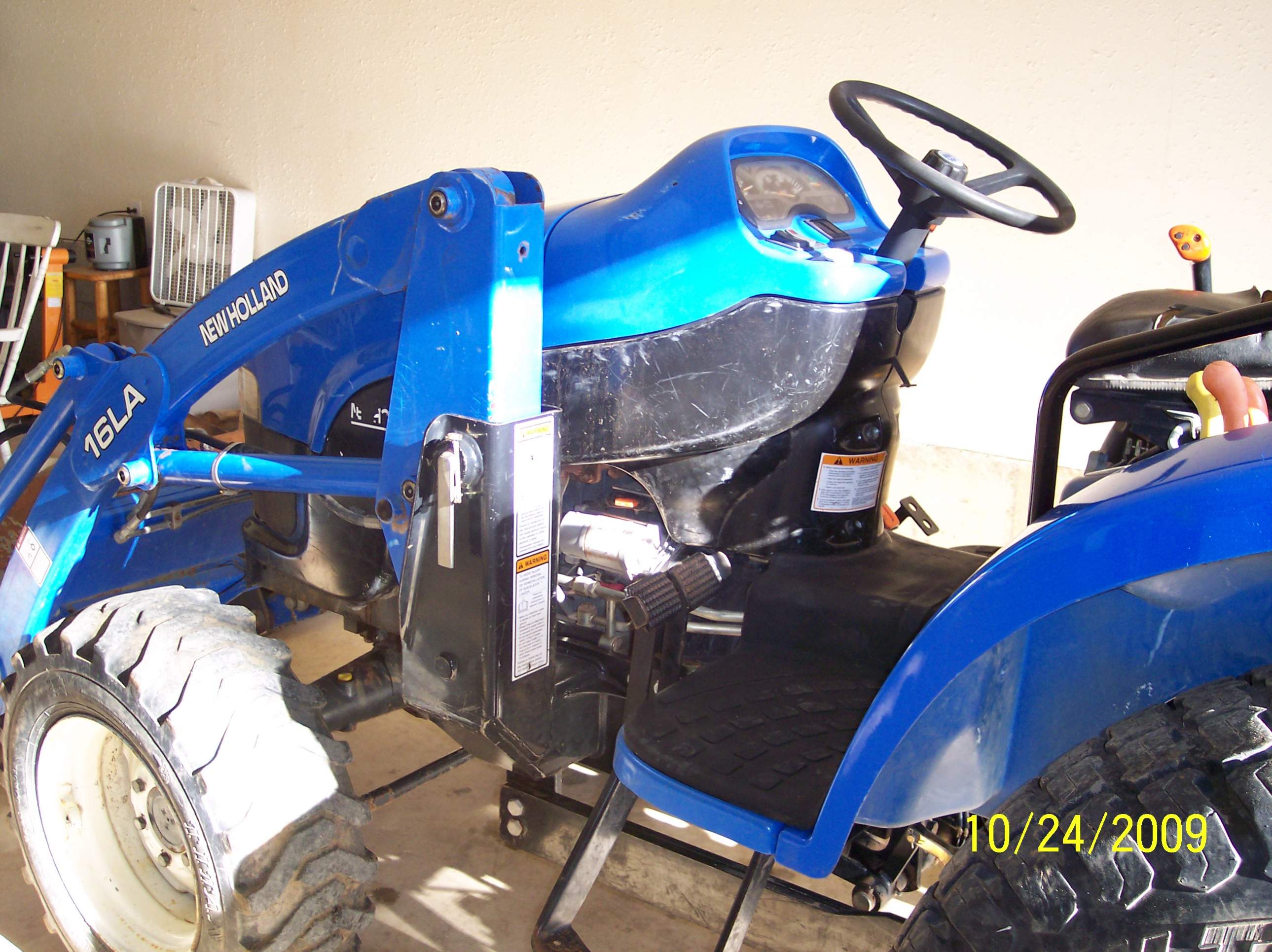

ITS ALIVE !!!!! I burnt the midnight oil and got the beast back together. It was operator error on why it would not start. Since I am new to blue I did not know about it having to be in N to start. After reading jinmans post I messed with the levers and she fired right up. Seems to blow a bit more blue smoke that I expected but I will tackle that one after I take care of all the little stuff. Most important is that is starts and runs, moves forward and backward, PTO spins, and the 3 pt lifts and lowers. I still need to build a diff lock lever since the origional was missing along with several small parts but that is half the fun. At least I will sleep tonight knowing that I didn't waste a lot of time and $$$ for nothing. I will get some new pics and tally up the project. Thanks for all the help and I will keep everyone updated and I am sure I will have some more Q's.

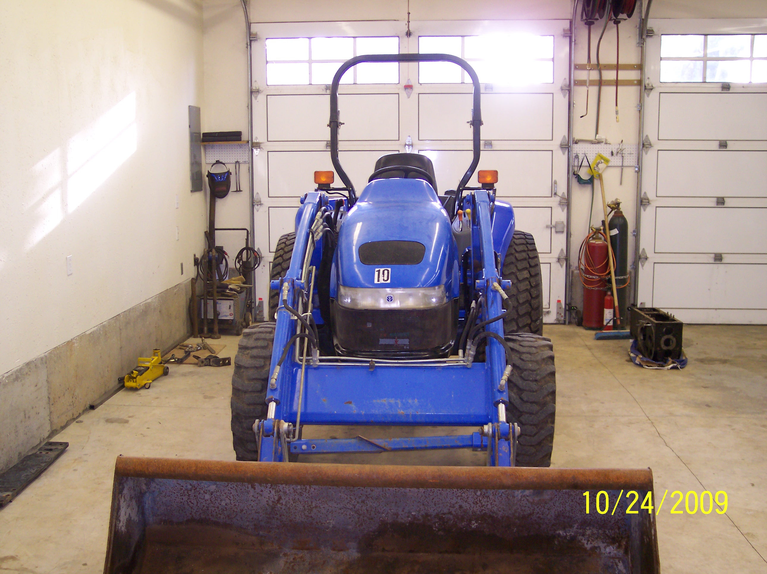

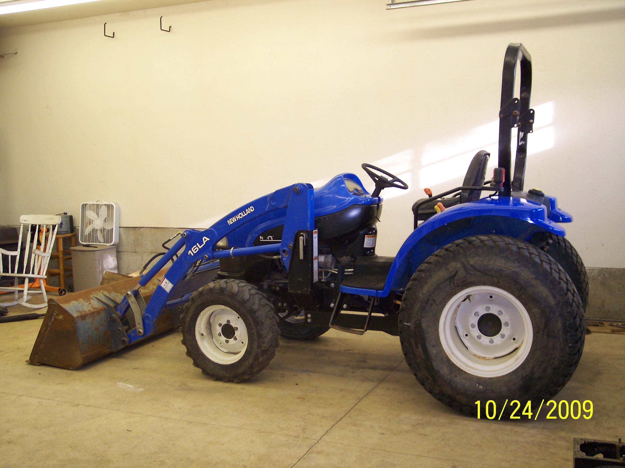

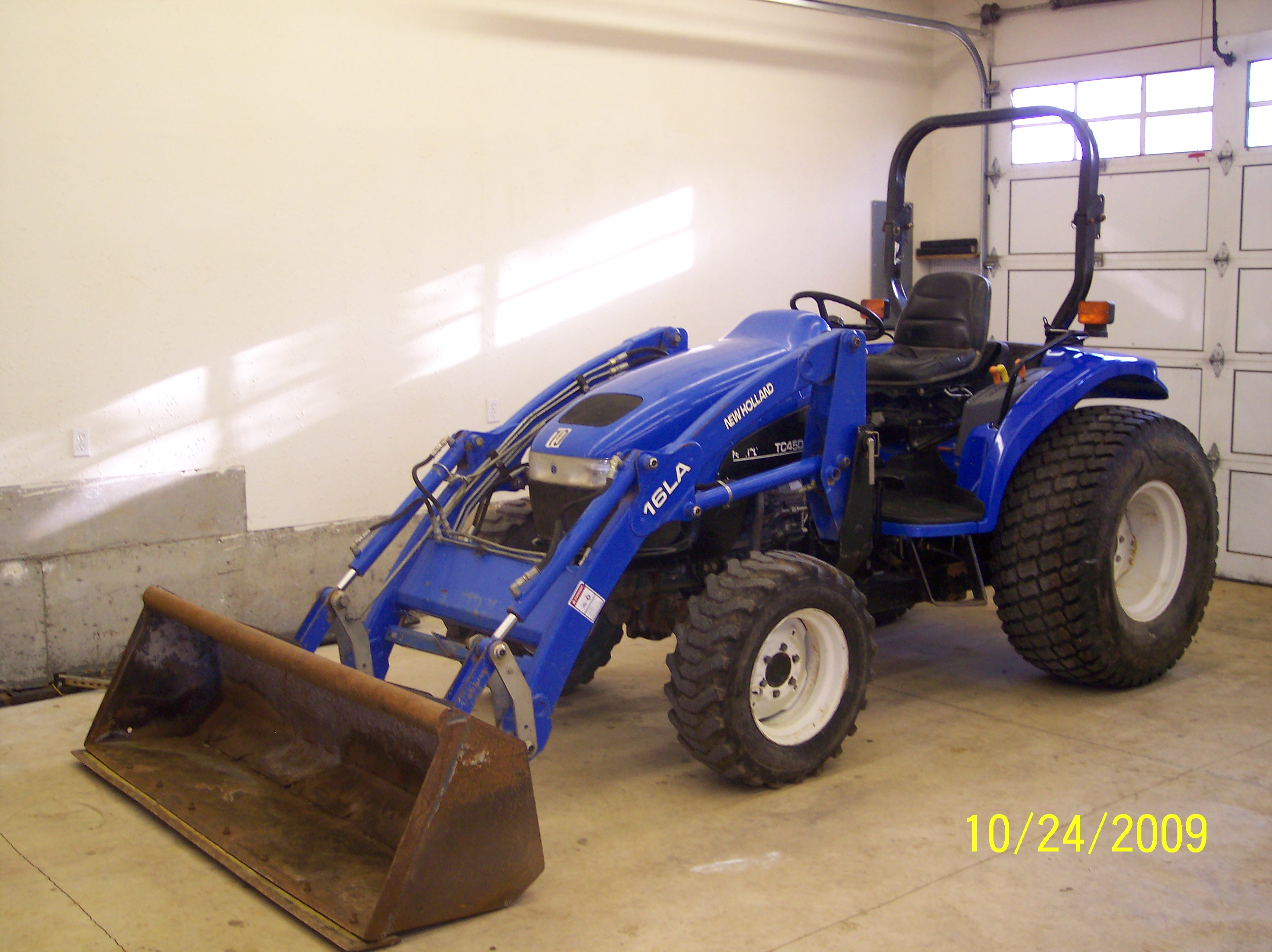

OK so the final results are in. I spent $3200 to get this machine back up and running. Keep in mind that this project was started by someone other than myself so many of the parts and pieces including all the nuts and bolts were missing. The case was purchased used for $1300 from Farmland Tractor out of Tangent Oregon. They had a few TC that they were parting out so it worked well to get some of the major components that I was missing. If a guy is doing this repair on a complete tractor then I would figure it to be about $1500 if you can find a good used case and some gaskets, fluid and filters. I unfortunately had to buy some guts to the 3 pt. lift, all the nuts and bolts, alternator and battery. So overall the whole project brakes down like this. Tractor, loader, backhoe $5000 + Repairs $3200 = $8200
I think I made out ok on this one and I have a decent working knowledge of guts of my tractor. I am sure I will still need help finguing things out from time to time. Here a a few pics of the finished project. If someone needs specific pics of the teardown or rebuild let me know because I have over 100 that were taken throughout the process. Now I need a matched set of tires. Anyone???
