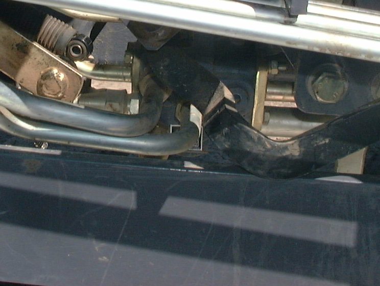

Dave, the system relief valve is inside the hydraulic diverter valve under the right side operator's platform. It's right out in the open and very easy to access if needed.
Is it separate from any AUX or FEL valves? Comes on a tractor with
no options (only a 3-pt valve)? Just wondering what the system relief
valve approach is at Shibaura....
   / TC 45D Rear Differential Rebuild #23
This block called the "Combination System Relief and Diverter Valve" is the Grand Central Station for hydraulic flow. When a tractor does not have a FEL, there is a valve that is postioned to eliminate that loop from the circuit. When an FEL is plumbed into this block, that valve is rotated so that the FEL is pressurized and becomes the first system in the open-center circuit. The only other relief in the system is an emergency poppet inside the 3PH lift cylinder that will prevent shock loads when the pressure rises to about 3600 psi.
The diverter valve also diverts .8 gpm flow to the hydraulically operated PTO clutch/brake. I have a picture of it below, tucked behind an HST pedal arm. It's not the best picture, but the only one I could find from a time when I was working on my HST actuator pedals.
The HST transmission is a completely separate hydraulic system and has its own relief and plumbing that is not associated with the main hydraulic system. Power steering is also an isolated and separate system with its own pump.
That is probably what my Kioti manual is referring to as the "safety valve",
and the pressure is in that range. The 3-pt also has a shock absorber
spring mechanism to reduce sudden loads on the hitch. The last 2 machines
I had apart (B21 and JD4300) do not seem to have either of these systems.
