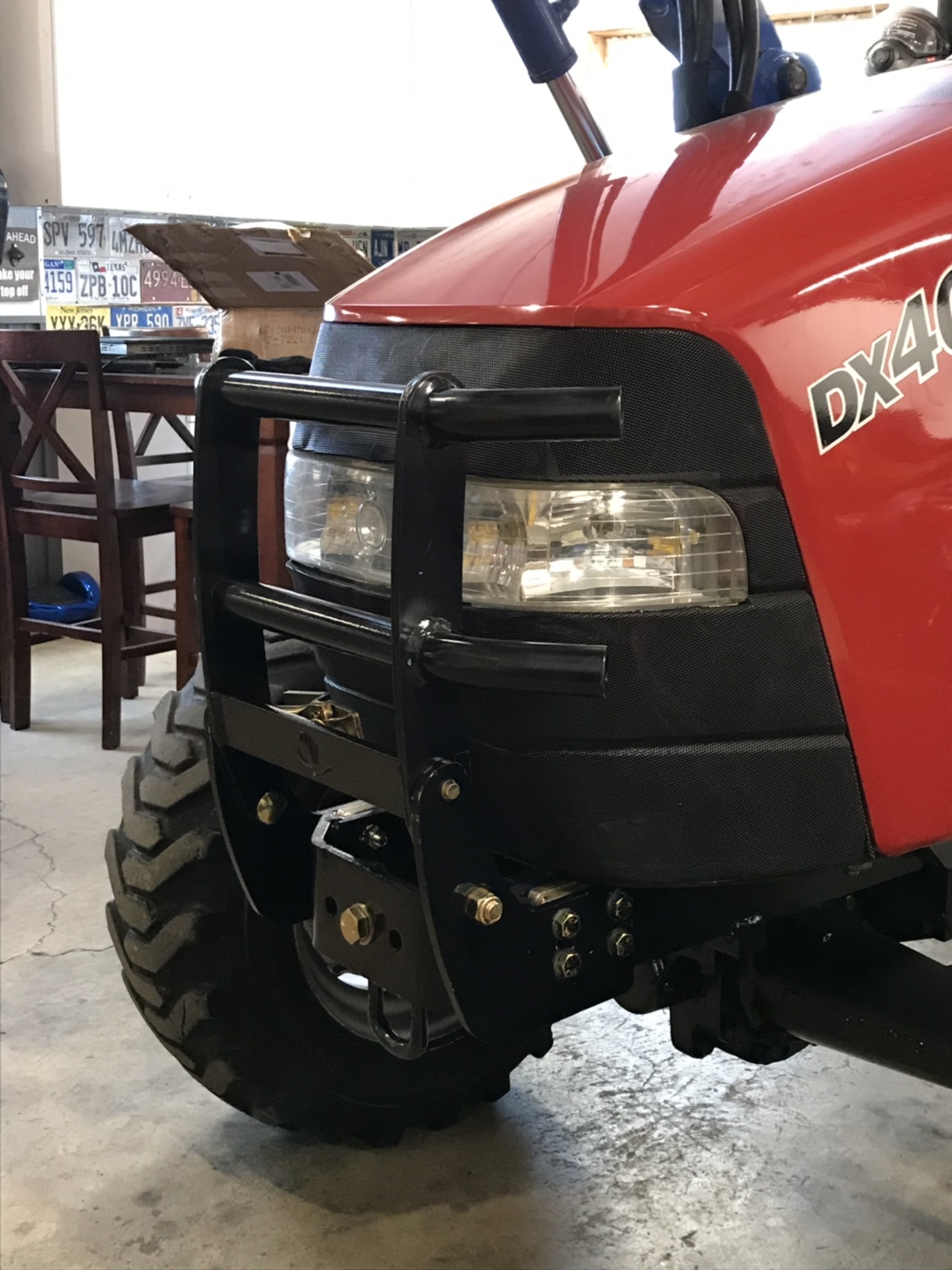

I'm pretty sure Wilkinsonlevi is all set.... see post #8 I believe that is his Case DX40 in the pic with the new grill guard on it... It is an expensive brush guard...

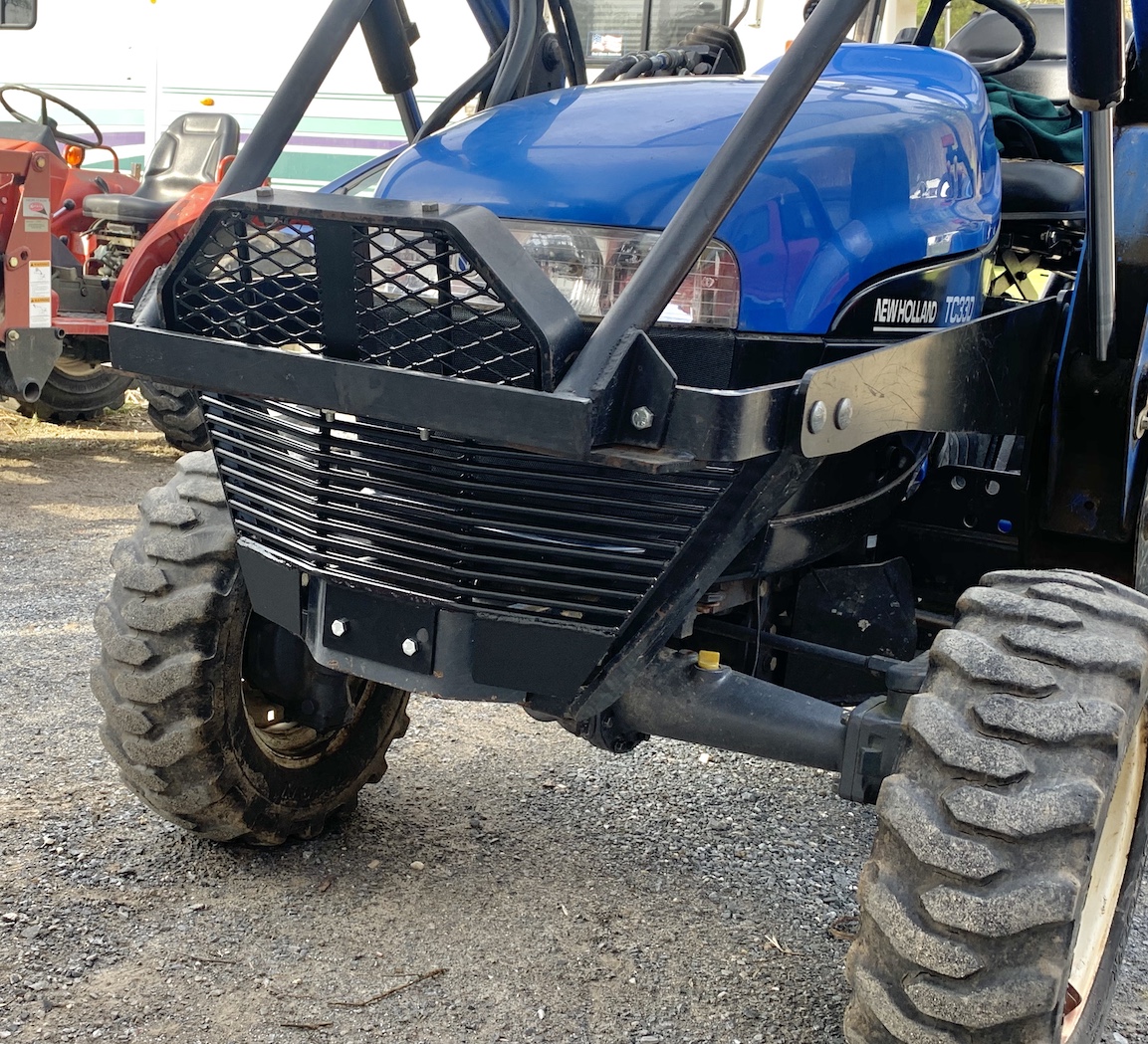

I had a tough time finding one for my tc40d so I built one. It isn’t hinged I have one pin I have to pull and lift it off but I’m happy with it and the price was right. IMG_2494.JPG
   / TC series grill guard #18
Hinged or not - Scottstc - that is one fine looking grill guard. Good job!!

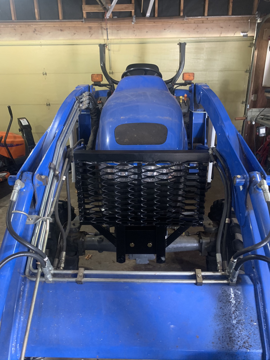

My grill guard, made by a local fab shop (the same guy who made my limb risers and belly pan). I use my tractor a LOT in the woods, and beat up the grill a lot: when using the forestry grapple, it's all too easy for a stray branch to poke through. Fortunately, I've never damaged a battery or the radiator, but I've come close (the battery case has a number of dings and scratches.
The fabricator made it to bolt between the factory "bumper" (if you can call it that), and the front part of the frame for my Woods 1012 loader. The round rods on the lower half welded up on a frame he designed. He also designed a small frame with the expanded metal to fit inside the existing sort of trapezoid shape on the loader frame. Both are bolt-on. I decided against pin-on, since I did not want to put up with the rattling that often brings.
