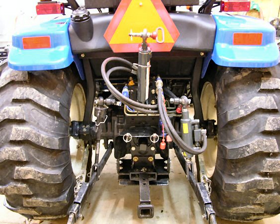

Just ordered a top remote only from IE, cylinder about 205, hoses with hookup 40+, and with shipping should be just under 300. Not cheap, but should have all the parts to hook every thing up right and in the size I wanted. Looked at CCI, but their site show that the size I wanted was out of stock.
   / TC24 Rear Remote + top cylinder #24
My only complaint about the Top & Tilt kit that came from IE was the 60 inch hydraulic hoses that are supplied with the kit. Sixty inch hoses are overkill in my opinion and caught on just about everything and anything. I took the hoses to my local NAPA dealer and had them shortened. They look good now and are much less likely to get tangled up in my implements.
   / TC24 Rear Remote + top cylinder #25
A bungee strap worked for me /forums/images/graemlins/grin.gif
You're right they are too long, I need to get them shortened some.
   / TC24 Rear Remote + top cylinder #26
Bob NAPA charges less than 5 bucks a hose and it looks a lot nicer once they are shortened up a bit. I have attached a picture of my setup since the hoses were shortened. /forums/images/graemlins/grin.gif

When I called, I asked how long the hoses were. Said I only needed a few feet, they said ok and will send that lenght. Should get the kit this week.
Case of question not asked? /forums/images/graemlins/smile.gif
