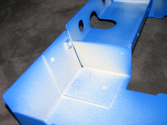

I received my warranty replacement from NH today at no cost. It looks like there has been some improvements to the bracket. Basically, the area where the seat attaches has been increased to a double thickness. I'll try and take some pics and post later.

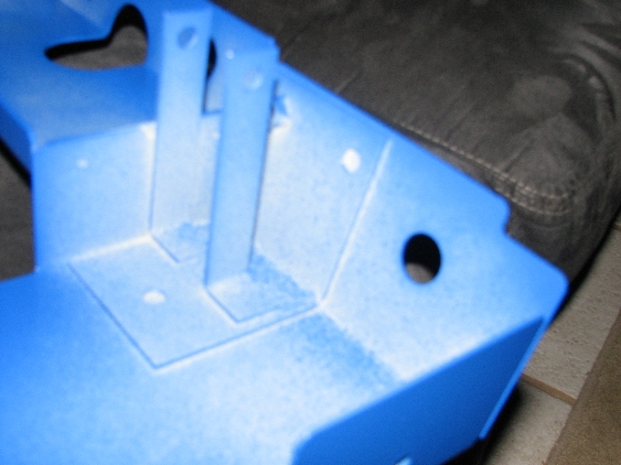

Sorry, it's been a little while since I posted last. I had a trip to Orlando, then another to Auburn, so I haven't had a chance to post pics. I did swap the seat bracket with the warranty replacement one. In the pics you can see where the metal under the bolt area is now double thickness. It only seems to be tack welded on, so it may not stay attached long. I still have my original which I plan on repairing and beefing up considerably. Once that is done, I will swap them and beef this one up a bit as well. Replacement was pretty simple. Remove seat and attached bracket. 2 bolts on floor on each side, and one in the wheel well each side. Remove parking brake and 3-pt lift return spring and a little maneuvering it is out. Reverse everything for installation.
