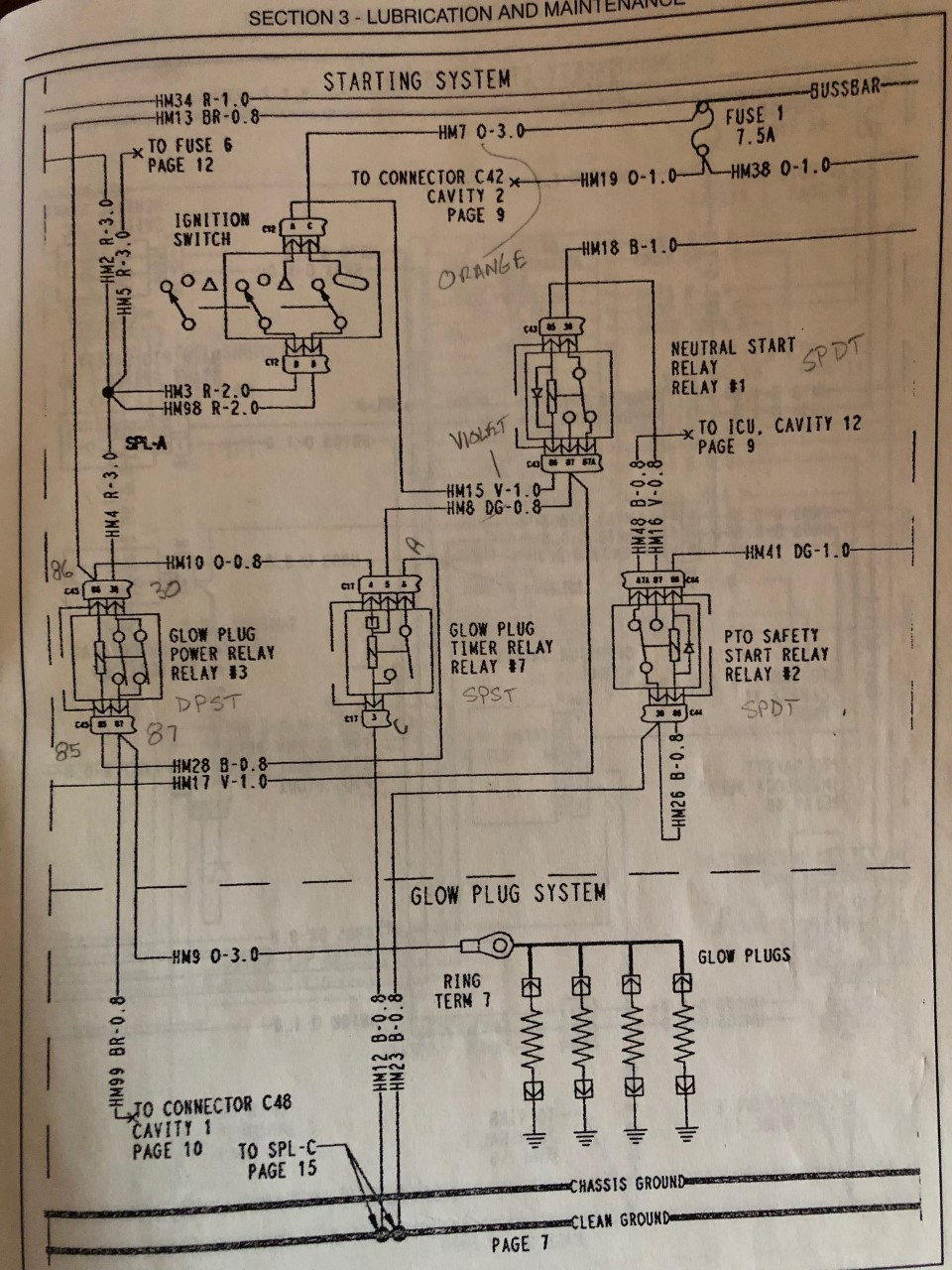

I hate to tag onto someone else's post, but I really need some help, THCLIMBER. I have a 29d, and I ordered the Service Manual. That electrical schematic you attached isn't in it. So I assume it came from the Owners Manual. Correct? My biggest problem is that the wire colors don't match my tc 29d. The area in needing help in us starting circuit and ignition switch. That schematic shows the wire from the (B) position on the ignition connector to the fuse panel to be HM7-White. Mine is orange. On top of that, I have two hot red wires, and the purple starter wire as the other 3 connector wires. Any help will be greatly appreciated.

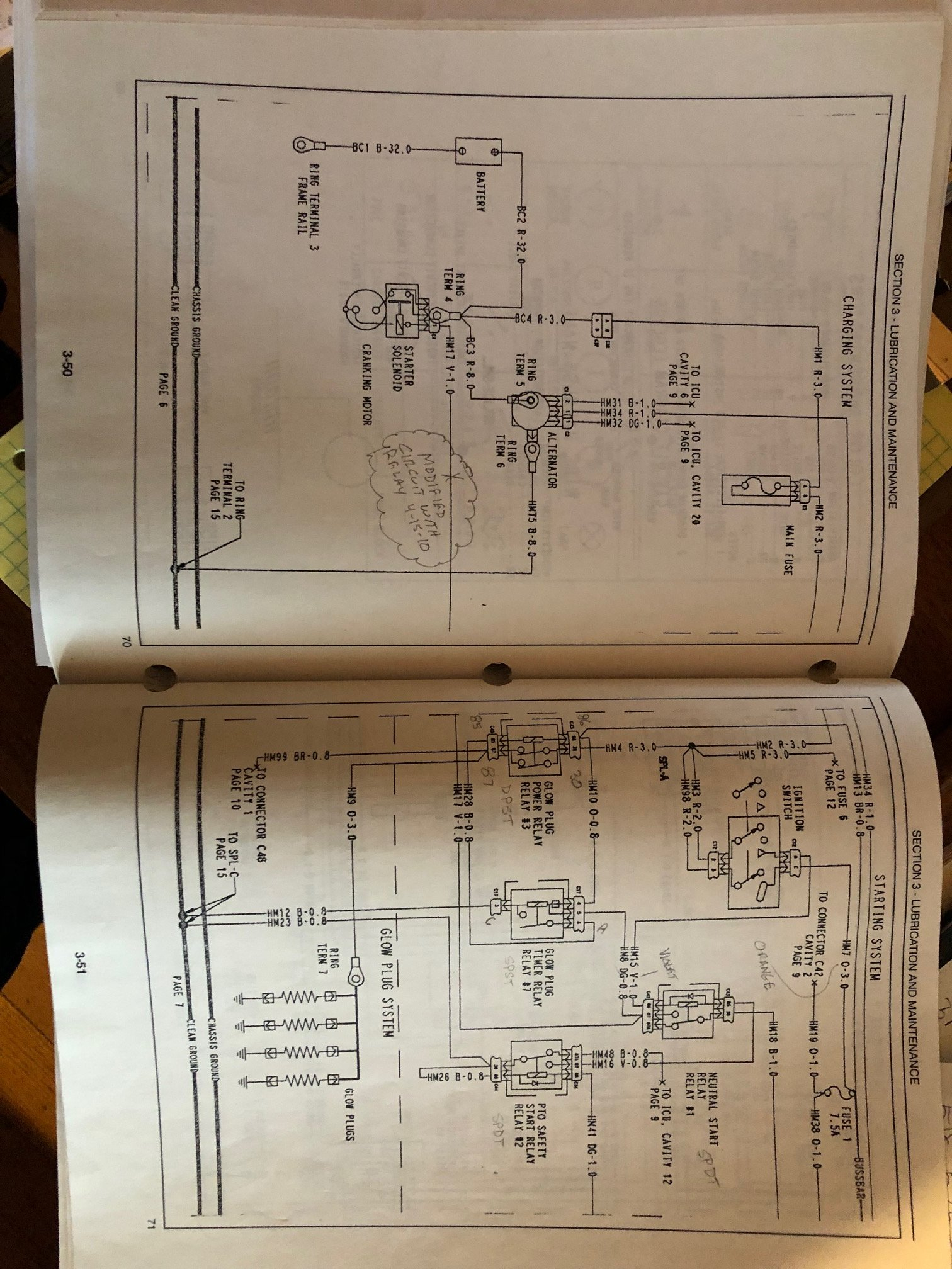

There are some variations of schmatics, but I'm surprized the service manual you bought doesn't have a schmatic.
Attached is the starting circuit from my manual TC33D/TC29D. In my manual there is no single page for the electrical schamiatic, rather its divived into sections on each page. There separate schamitcs for a geared or hydrostatic unit. The attachment is for a hydro, but the starting circuit look to be identical for either.
Are you trying to replace your switch or install the deticated relay which supplies power to the stater?

The service manual i have had all the wiring schematics, but they do not match my tractor. There isnt a "lubrication and maintenance" section. The schematic you posted is the closest I've seen to my tractor. On my ignition switch, there is two hot red wires, an orange and a purple. In my service manual, it shows two oranges, a purple and a red. In yet another schematic I saw online, it showed there to be a white wire going from the ignition to the #1 spot in the fuse panel. I'm going to work off of your schematic and see what I can get done. I noticed that it didn't show the starter on schematic. (?)

The link below describes what I did to replace my switch and has some pictures that might help. Unfortunately it was so long ago that this post is all that I have to go off as to what the wiring looked like with the OEM connector and I have believe it matched the schmatic in my manual otherwise I would have made a note of it.
The starter is shown on the previous page (page 6), see attahced.
