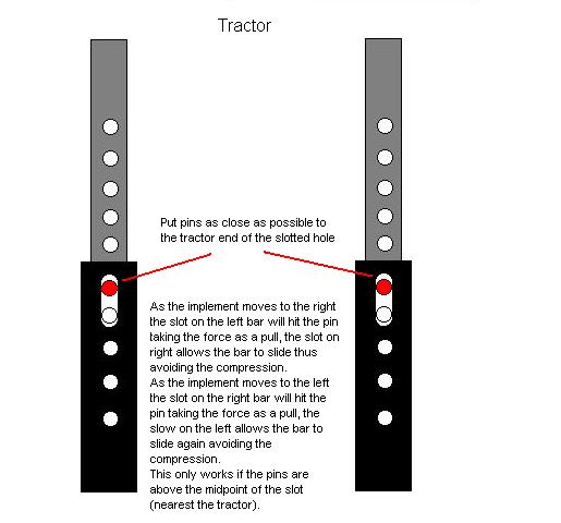

Keep an eye out for the problem that jcamille mentioned - the bent stabilizers. He said that it's happening while using his finish mower. Is there that much force being applied when pulling a finish mower?/w3tcompact/icons/shocked.gif That seems a little extreme, so doesn't it sound like he might have the wrong stabilizers on the tractor?

It's a little hard to explain, but I'll try. My old tractor had stabilizers that preventing the lift-arms from straying too far outward. These stabilizers were under tension when they would try to swing out. On the TC30 the stabilizers are in the more traditional configuration of preventing the lift-arms from straying too far inward as opposed to outward. This puts the stabilizers under compression as the load shifts. I have not used a heavy 3pt implement yet but I have been looking at the 3pt and I can imagine how the described problem could happen. Maybe adjusting the stabilizers for the particular use is in order here.

The bent anti-sway bar problem.
Had the same problem and have successfully solved the problem, at least it has not bent since. The anti-sway bar on the TC40D looks something like this drawing (please excuse its crudeness):
Do your bars look like this? Does this make sense? The basic idea was to get the one bar to take the tension before the other took the compression.

Dave, the TC30 does not have a sophisticated system of sliding planes like your deluxe TC40. The TC30 simply has a turnbuckle with a eye-hook on each end. The only slack in the compression direction is the inherent movement in the turnbuckle and the eyebolt tolerance. Maybe an inch at best. I just spent two hours pulling a 1000 lb lawn lower around my lot and can find no bending or damage. My stabilizers appear to have been adjusted to the optimum length before delivery (last Saturday). I have raised my 3pt arms with a backblade attached and cannot swing them enough either way to create a compression situation on either side. I think I got lucky and got a good set-up guy. Thanks,
Jerry
Note: I was pulling the lawn roller with a bar across the 3pt arms (not the drawbar).
