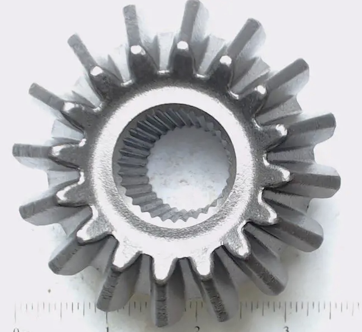

Actually it has been about 130 hours, but as I mentioned above, the bevel gears in my tractors are not precision ground, the gear teeth may not be ground at all, as shown on this photo of an upper bevel gear borrowed from Messick's site;
These gears are putting metal into the oil. Over time, that metal wears the seals and the bearings (bearing wear shown in OP's photo #4 on the first post).
