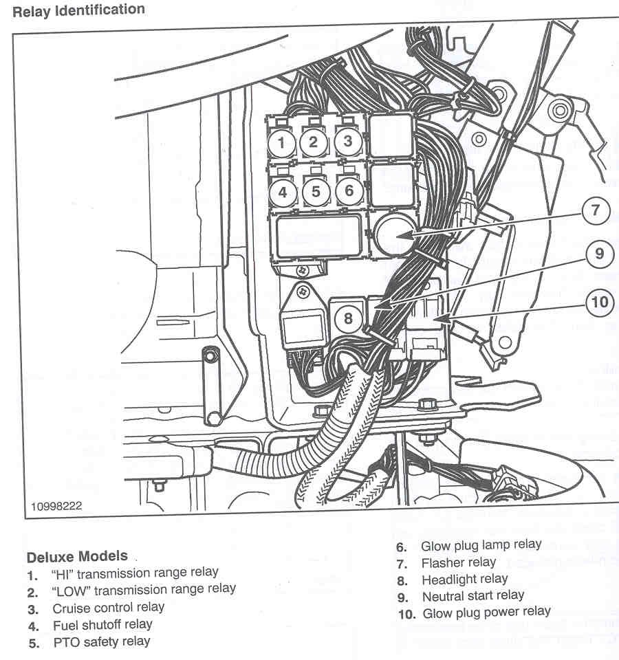

My glowplug indicator light is not coming on, and the tractor won't start when it's cold. After reading this old post, I thought it was the timer, but I troubleshot it as the instructions said in this .jpg (page 2 of this thread) supplied by Pineridge and the timer seems to be fine.
If the timer is getting power, and it seems to be working with a test light properly, what is next? Which relay is for the glowplugs? Is there a way to test the relay?

If you did the test PineRidge suggested, you never checked the timer in the circuit. Is that correct? You don't also have problems with your alternator too, do you? Fuse #1 supplies glow plug power and also the voltage regulator input to the alternator. It should be the first thing you check.
There is a separate relay for actual glowplug power and the lights. Glowplug power is relay K3 and the lights run off of relay K9. Glowplug light power is from Fuse #4. I'm attaching a diagram that shows where your relays are.
BTW: Do you have an Owner's Manual? If so, turn to page 3-37, frame 2 of the electrical diagrams. The glowplug bus bar is shown with power coming from relay K3 and K3 is controlled by relay K4, the glowplug timer relay. Both of these get their power from the 7.5 amp fuse #1.
