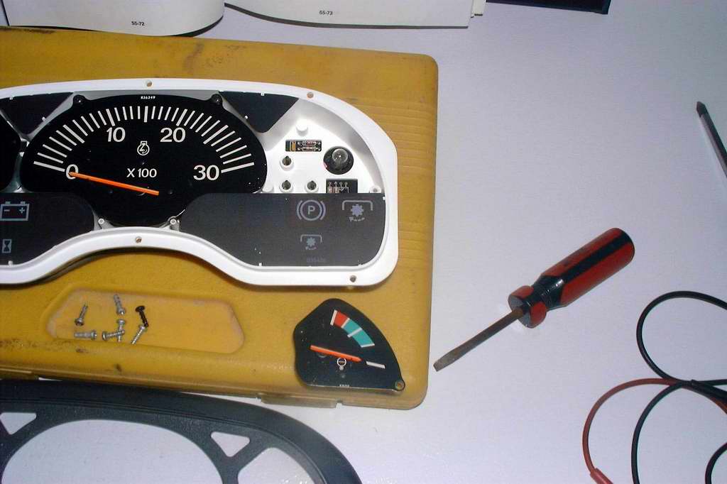

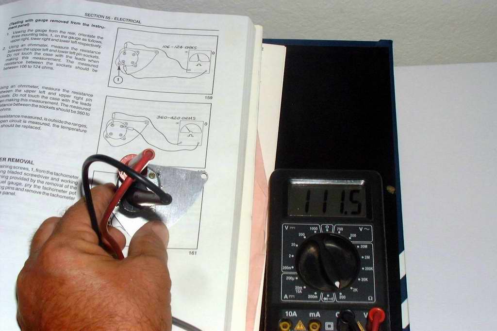

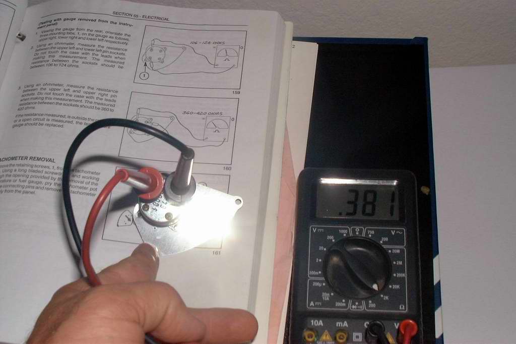

JC, my manual does have ohm readings for the sending unit at various temperatures:
95 F = 670 ohms + or- 80 ohms
176 F = 118 ohms + or - 6 ohms
221 F = 54.5 ohms + or - 2.7 ohms
239 F = 42 ohms + or - 2.5 ohms
That being said, since the temperature of Eric's tractor is indicating the same as his IR thermostat says, I'd say these readings on the sending unit are probably just fine.
Also, I had a temperature gage that was reading exactly the resistance described in testing in the manual, but it was only reading 1/2 scale. The new meter read the same, but it worked perfectly. I'm not sure how much I trust these numbers. My dealer's service manager suggested I disconnect the lead from the sending unit a see that the gage read zero. Then, ground the lead going to the gage with the key on, and the gage should read maximum. That was the test that told me I had a bad temperature gage because grounding the gage only gave me 1/2 scale deflection.
Since Eric's IR thermometer agrees with his gage, I think his temperature system is working fine. But, as you say, it doesn't hurt to check the sending unit with the numbers above. That does give you another data set to work with.

No adjustment JC, just a very expensive gage to replace if it fails, $50. Here are some photos of the gage and the test with the details on the manual in the background. I suspect Eric's gage is similar, but I can't be sure on his Class II TC33D.
Like you, it seems I have a picture of almost everything I've ever done to my tractor. :rolleyes::)
