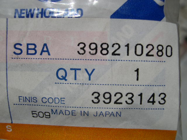

Jmofr, that part number was not valid at my NH dealer. Can you double check it again? Thanks!
Brad
   / TC33D Rear PTO Shifter #12
Unfortunately, I threw my packaging and my receipt away after I posted the number, but I'm pretty sure the number I posted was correct. The spring I bought was in stock at the local dealer which was very unusual based on past purchasing experience.
The spring I removed was so stiff I couldn't compress it by hand, but the new spring was slightly compressible by hand and it was a little smaller in diameter.
   / TC33D Rear PTO Shifter #13

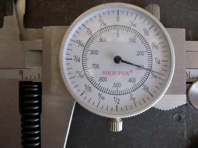

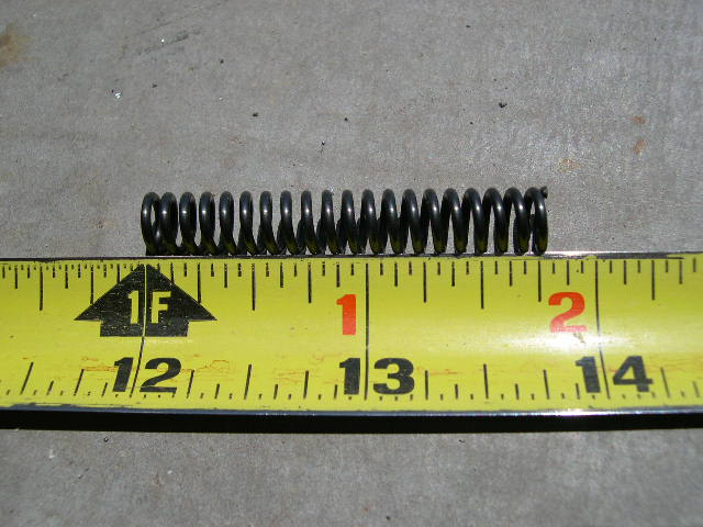

I checked the number and it was correct. Perhaps I should have included the prefix of "SBA". I am including photos of a new spring with measurements and the packaging photo. The cost of the new spring I purchased today was $2.13.

I am having the same trouble on a brand new TC34DA. On the NH parts online both the TC30 and the TC34DA call out the same spring 398210460
which is not the one you guys show as the replacement 398210280.
I guess NH is still shipping machines with the old spring? Got to get a spring
