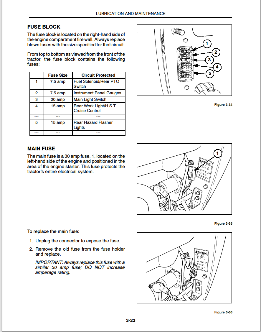

I get nothing when i turn the key. Its not the stating fuse because i have a breaker in its place and i did replace with a fuse to be sure. I checked all fuses in the fuse box all good. Is there a main fuse and if so, where? Not the battery because is was running fine all day and i stopped just for a second and then it wouldnt start. Help!!!

The main fuse is on the other side of the tractor. Mine is attached, or very close to the starter. I think the owners manual shows it on the fire wall by the starter. Good luck..

Hey Mike,
Where was the 'main fuse' located, as we have the same issue? No lights, etc.
   / TC33D wont start, no lights. Main fuse where? #6
See below:
   / TC33D wont start, no lights. Main fuse where? #7
It was the main fuse(30 amp)...thx for the help/diagram!!
