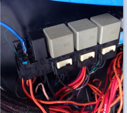

/ TC33D wont start #111
Hey Paul
I tried to attach the picture of my relays, but it is not coming up. Capture.PNG. OK it is going to come up.
I removed the first relay and made a small blue jumper with spade ends. Everything seems to be working fine now, but it is not the way I like to fix things. Since my manual does not have my particular wiring harness I do not know where all the of wires go to. I will mess with it as the weather gets better, but I get more confused and angry trying to figure things out without the wiring diagram. Palmetto fared well with that storm not even the first palm fron fell out of a tree. I bought this tractor from a guy in Ruskin. Got a great deal and this is really a great tractor.

/ TC33D wont start #113
I just copied the photo, thank you. I can't tell where the other end of the jumper goes from the picture. Can you advise?
I was on the tractor most of yesterday and it started every time no problem. This is the kind of thing that drives me nuts. I haven't had time to get into this repair yet, it is getting cold here, 32 yesterday morning, and we are trying to get ready for winter. That 5 foot roto-tiller really does the job!
I love this tractor, it is a real work horse for sure. The only draw back seems to be the electrical system. I had to replace the glow plug timer relay several years ago and as I said before, the connectors are very poorly designed.
You have been very patient with my requests and it is greatly appreciated. If we cross paths in Ruskin I will be more than happy to buy you a beer.
Hey Paul
The blue wire goes where I drew blue line, I am pretty sure it is in the first slot closest to you on the relay. I will take a picture of the jumper installed and send it to you when I get home later.
