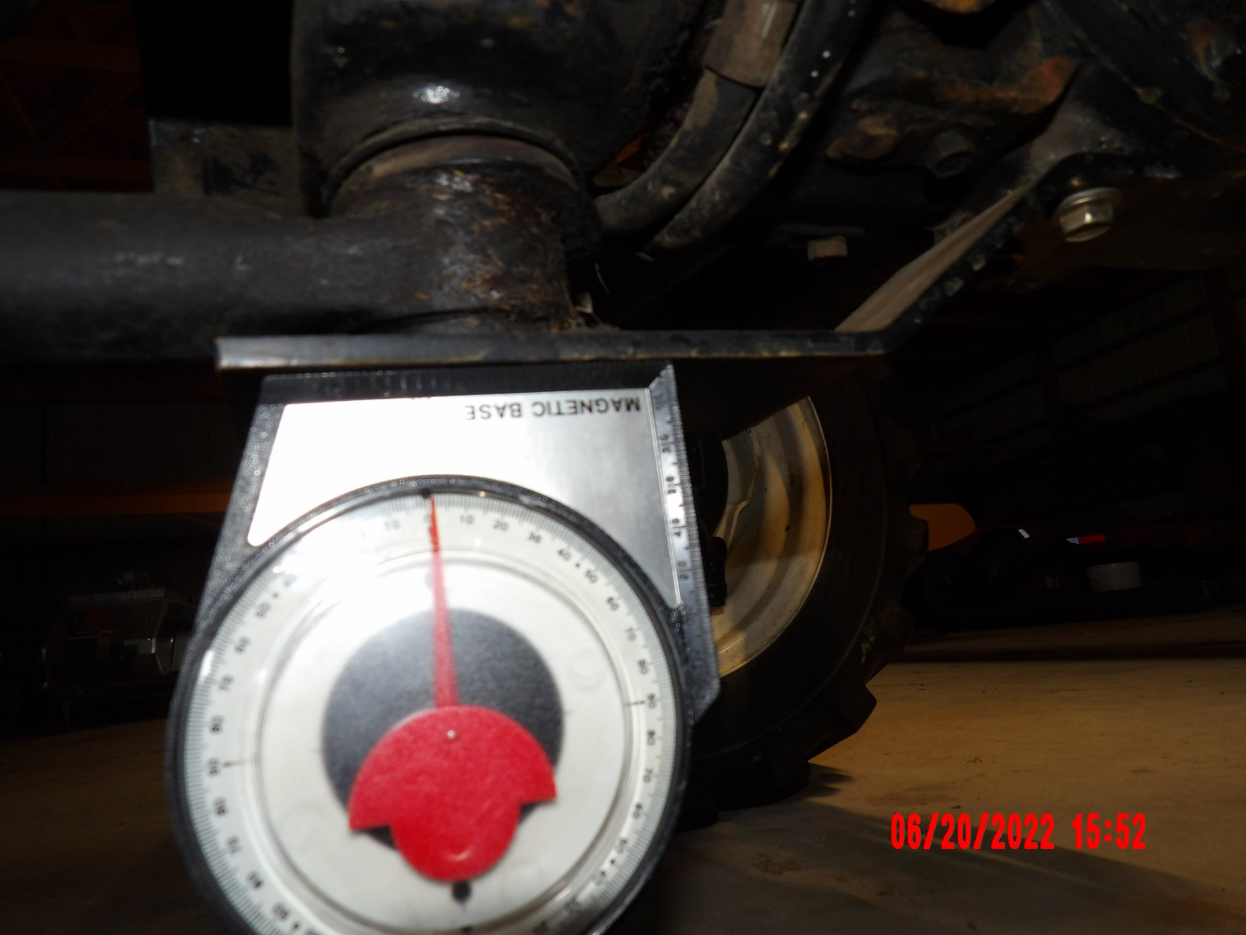

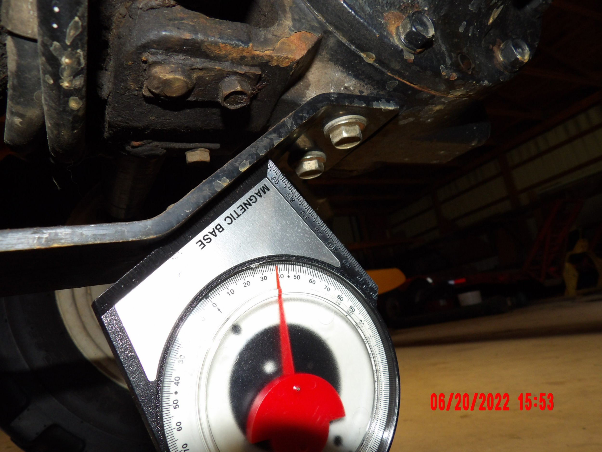

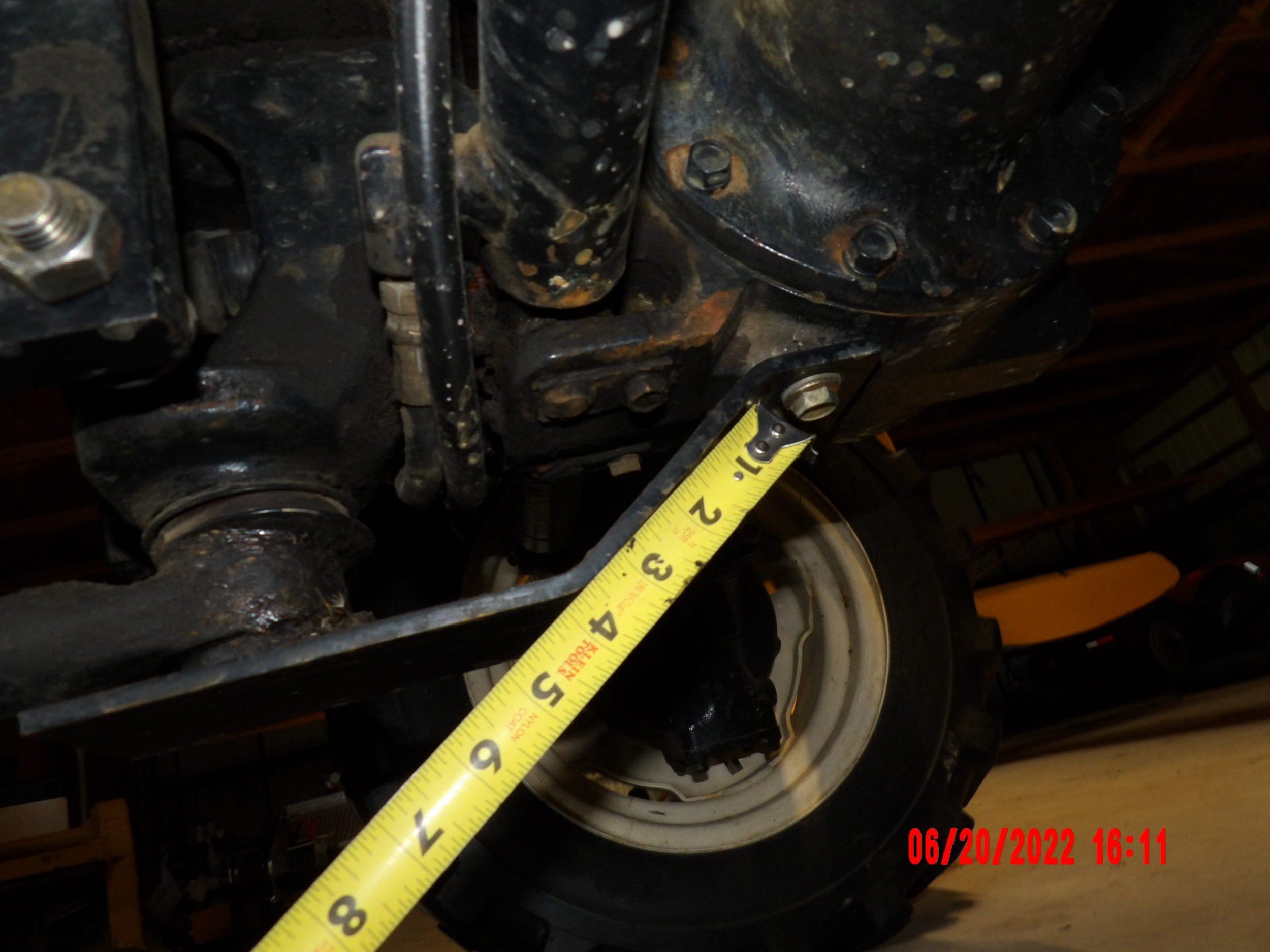

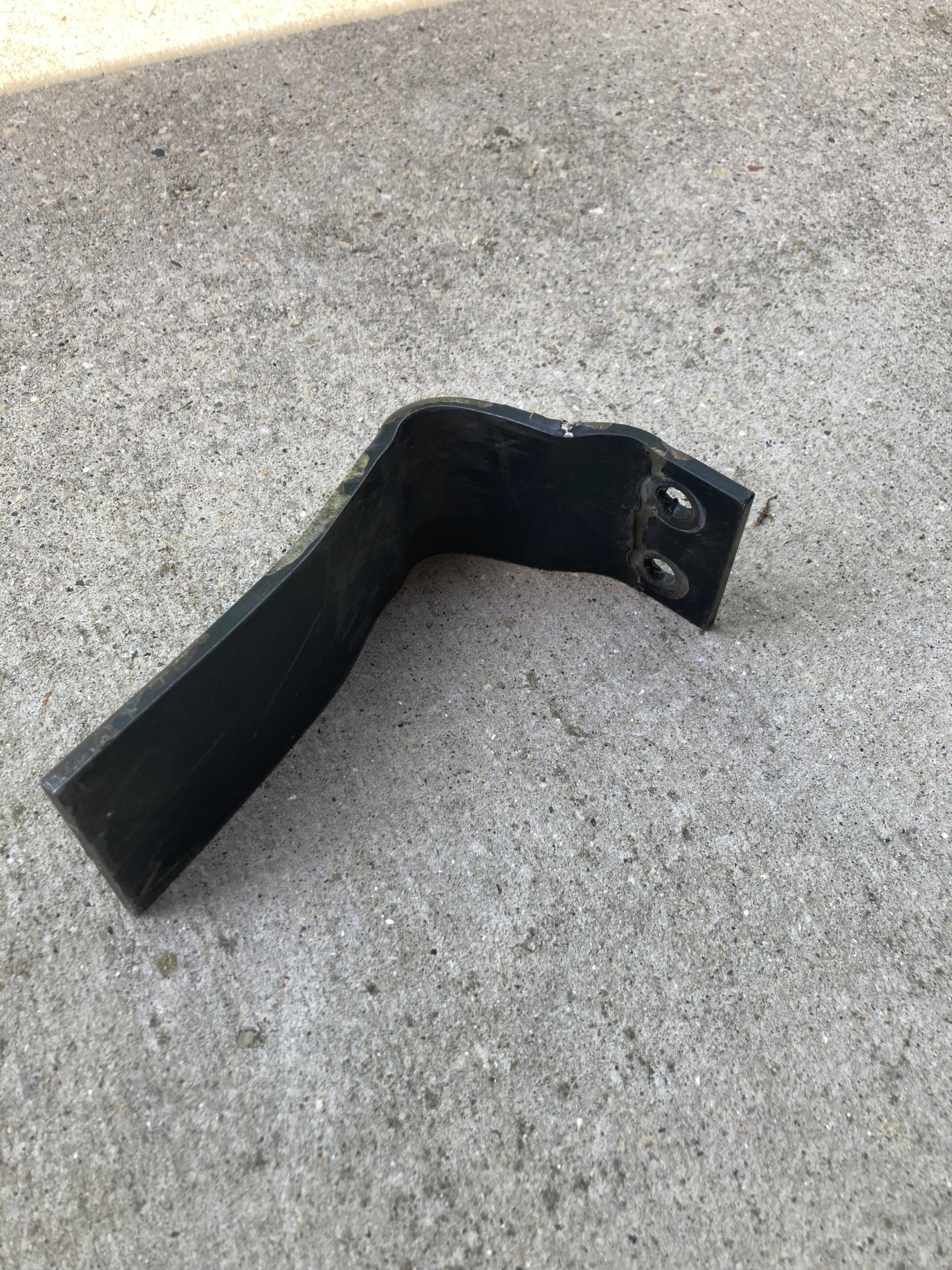

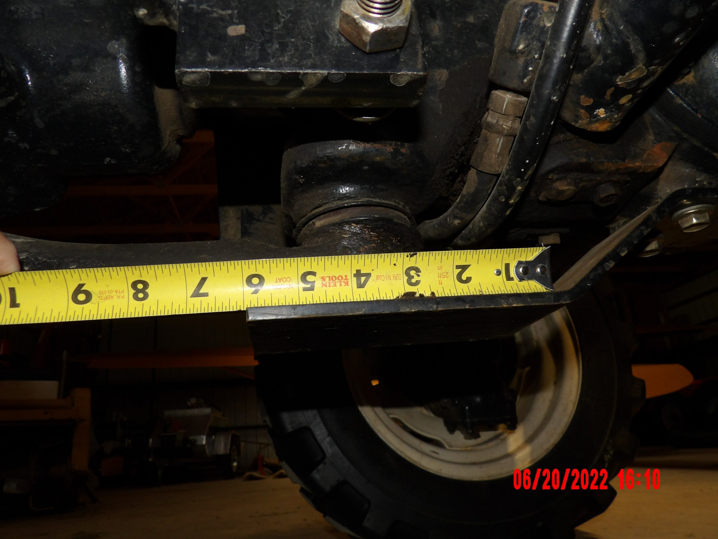

I snagged the front axle protector plate on my TC33DA, probably on a stump, and bent it up pretty badly.
The new replacement part 86402588 is about $100 😮, but I think I can have one made by my local welding shop for less than that. It's a 3" x 12" plate', 1/4" thick steel, with 2 bends and 2 bolt holes.
Could someone with this model tractor please measure their plate for me? I need to know where along the length the bends are supposed to occur, and approximately at what angle.
A photo of the badly mangled plate is attached.
Thanks in advance!
