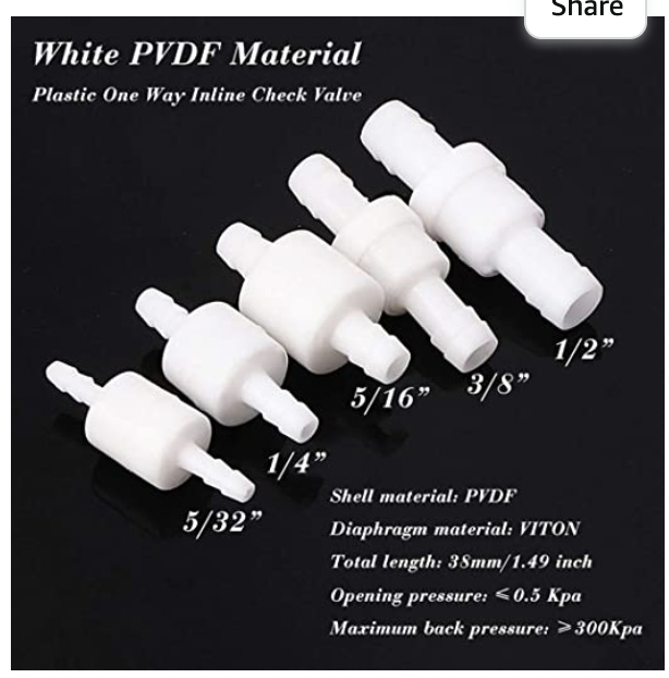

I got these check valves from Amazon. Here is the link to the correct product.
There are metal valves that would probably be more durable, but I went with these for two reasons: 1) It was an experiment that I didn't know would work and thus didn't want to waste money if ineffective; 2) these were the only valves where I could clearly determine a small opening pressure. I didn't want a valve that would require too much pressure to open. These valves have a documented opening pressure of 0.5 kpa or 0.07 psi. There were some nice aluminum alloy valves, but their opening pressure was 2.9 psi (or 20 kpa) and I was afraid that would be too high a pressure to operate on these low pressure return lines.

Have now used the tractor for high throttle work for more than 15 hours with no loss of fuel height in the filter bowl and no compromise to the workings of the tractor. I think I can now recommend that anyone out there with this same problem could use my fix; namely, two low pressure check valves with one preventing suction flow from the return line to the tank, and the other permitting only outward flow from the filter assembly out to the return line.

This is just an update on the solution above. It has now been over three months and a couple hundred hours of tractor use. I've had no further problems with the fuel lines and filter bowl assembly since installing those two small check valves. While I still cannot say definitively WHY the problem occurred (and has occurred apparently with my other TC owners), the above fix really did FIX the problem. Happy holidays all!
