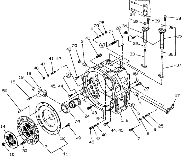

When I turned 60 I thought about buying a Harley and got a tractor instead. 2003 NH TC35 Boomer with 85 hours on it. I'm brand new at tractors but got a really sweet deal. My problem is No one told me to lock down (release) the clutch so the flywheel and clutch plate seperate and don't rust together in the off season. I've gotten all kinds of advice from friends but so far nothing has worked. The plates are really stuck and I have no clutch. Pedal and linkage all work fine it just does not release. Local repair shop says $1,500 minimum, have to break tractor in two pieces. They have done this before. I have a front end loader on one end and a back hoe on the other. All kinds of heavy steel bolted on at both ends to re-enforce the frame. Lot's of work to get it in half. Here's the latest suggestion, cut a small hole in the bell housing directly over the clutch plate, insert a piece of cold roll steel against the clutch plate and use an impact tool to rattle the plate break the rust and set it free. What do think ? Does anyone have a drawing or exploded view of the clutch so I can see how to get to the place where the two are rusted together. How much access is there through openings in the spring plate ? I have to figure a way to do this other than breaking the tractor in half ..... I know from reading some of the threads there are some really bright people out there .... Let me have your best shot ... Thanks
/ TC35 rusted clutch #2
Man newhollandharley, I dont think I could bring myself to drill any holes in the bell housing. This is a parts picture from the new holland website. Maybe you can remove one of the items attached to the bell housing to gain access for that impact suggestion? Do you believe the disk is rusted to the flywheel? Or to the pressure plate, or maybe both? My Ford is an old one and never had that problem before, When you turn the key to start it, the tractor tries to roll? Maybe getting it to an open area and get it to run, and drive it, it may come loose on its own. Good luck, TB

I can start it easily out of gear and as long as I stay in low low range I can actually put it in and take it out of gear with no grinding so I've driven it many time, very slowly. Jerking it, gassing it, applying brakes hard, running it into a tree (slowly) and stalling it, I've tried everything. I'm told I just don't have the horsepower to break it free. Ive seen the drawing you sent, thanks .. I need a drawing that shows a cutaway of the clutch housing assembled so I can better tell where to drill a hole and a detail of the spring plate assembly to see if there is any access to the clutch pad in the first place.
/ TC35 rusted clutch #4
Do not drill a hole in the belhousing. Looking at the parts diagram it looks like there might be a hole with a plug in it on the left side of the belhousing.I would split the tractor before I drilled a hole in the belhousing. The belhousing is part of the structure of the tractor. If you weaken the structure you weaken the tractor. Hopefuly rickb will see see this post and give you some good honest advice. He works on these for a living.

It may sound rough but i think i would remove the starter motor and give the back of the flywheel a good rattle with an air chisel . Round off one of the chisels on the grinder so it can't damage the flywheel . It would help if someone could put some clockwise pressure on the harmonic balancer bolt while it is in first gear with the clutch pedal blocked down . Do'nt rattle the ring gear , you may be able to get onto a portion of the pressure plate . If you get it free , give it a bit of a slip as you drive it to pollish off the rust .
I have the starter off right now and I can see the flywheel and ring gear, I tried to get a "see snake" (TV on a stick) to fit between the bell housing and the ring gear but it's about a 1/8" shy and won't fit. I got no manuals with this tractor when I bought it and the cheapest I have found on the Internet is well over $100. I need some drawings or photos of what the pressure plate, flywheel, clutch pad and other components look like under the bell housing. I need more of a cutaway than an exploded view .. any help? I can't tell where the harmonic balancer is at this point. The pressure plate covers everything but I think there are a few openings along the edge that will allow me access (although minor) to the other components. I can't judge which of them need ratteling but I will try the flywheel while avoiding the ring gear . .. thanks for idea. I'll get back with the results in a bit.

Well gentlemen, nothing worked. After a full can of PB and 24 hours soak time I locked down the front end loader in a very large pile of earth, put the transmission in low low, stood on the brakes and the gas at the same time until she shuddered and stalled and still nothing. I have had the clutch pedal locked down for weeks now. The clutch is stuck, rusted solid. I am spending my Sunday making heavy duty kick stands for the front and rear halves of my tractor and will begin to break it in half tomorrow. Any thing I should know? Experiences by you could save me a lot of heart ache .... let me know. I've taken dozens of digital pictures of the assembled tractor so I can remember how to get it back together. I have to remove all the sub frame to the front end loader and the back hoe and that will take me the rest of today and part of tomorrow too ... I am going to take pictures along the way in stages because I don't have a manual. I'll update as I go if anybody is interested. Thanks again for the suggestions
