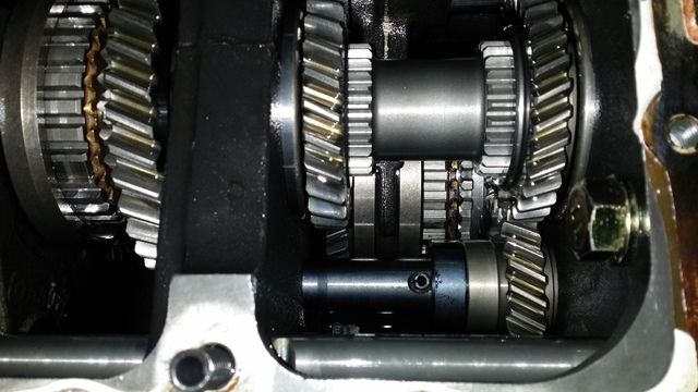

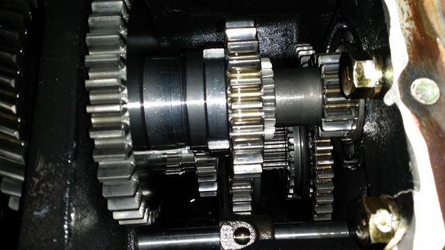

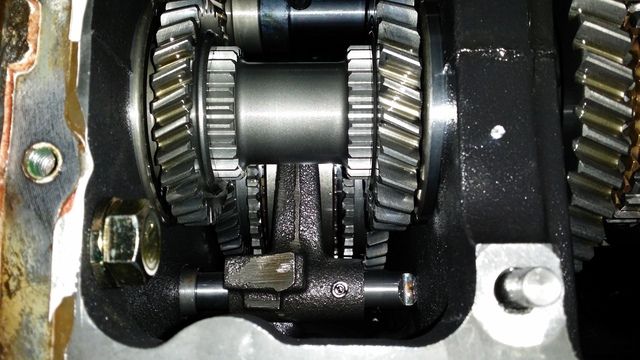

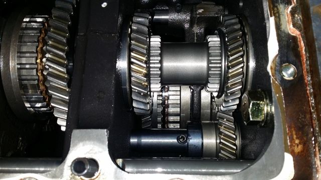

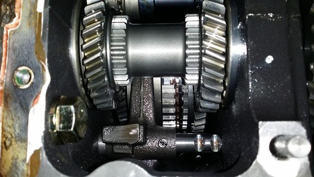

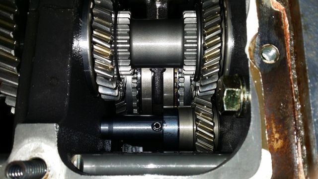

Over the last couple days I have done the following:
1-Drained the hydraulic oil.

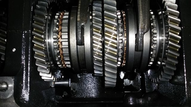

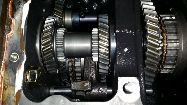

2-Popped off the top cover on the trans and taken some pics.
Right side of tractor - Forward gear engaged
Right side of tractor - Neutral engaged
Right side of tractor - Reverse gear engaged
Left side of tractor - Forward gear engaged
Left side of tractor - Neutral engaged
Left side of tractor - Reverse gear engaged
Left side of the tractor - Gears 1-4
Left side of tractor - Ranges 1-3

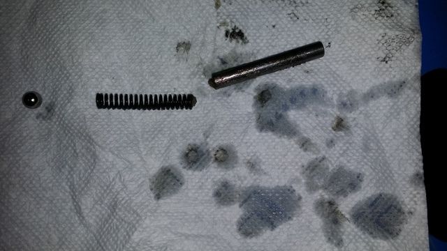

3-Removed the ball detent for review
Ball detent mechanism & paper towel used to wipe magnet off
The ball is in pristine shape, no wear in the chrome.
4- I fished in the bottom of the sump fwd/rev section with a magnet.
I did not find any metal shavings. Just a little gunk shown on the paper towel above.

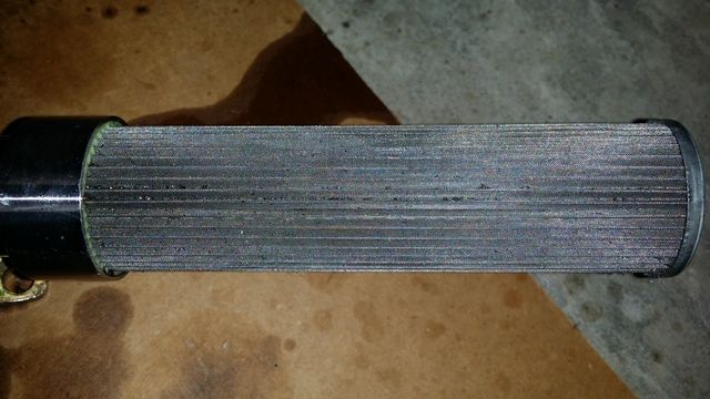

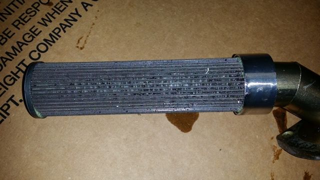

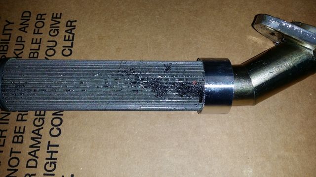

5-Cleaned the suction strainer
Top of the suction strainer
Bottom of the suction strainer
This could potentially be cause for concern BUT this strainer has never been removed for cleaning ever. A lot of the shavings were long and curled which to me would indicate that they were from the initial manufacture. On the other hand a lot were just metal filings. Note: I don't see any wear other than very light wear on gears etc. anywhere in the transmission.
Crud I got off the strainer
The strainer after cleaning it off with brake cleaner and before I re-installed it.

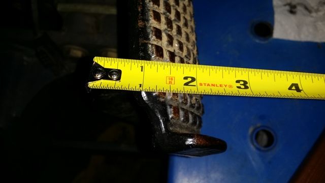

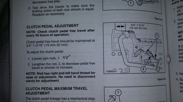

IV-Last thing would be to measure the clutch pedal free play when hot and potentially adjust it to where it was before the 1000 service. As part of this service I did adjust the clutch pedal free play. It was getting to the point where I needed to have my foot firmly to the floor when clutching and it would engage pretty quickly after releasing the clutch. By adjusting the free play, which is now in the middle of the spec, I should be alleviating any problem with the clutch staying engaged but it is something that I did change at that service and it needs to be looked into.
Manual
Current pic showing how far the pedal returnes after hitting tension
Anything I'm missing? I'm hoping to get the fluid grade figured out tomorrow and maybe do my testing Wednesday or Thursday after work.
   / TC35 Shuttle Shift, Won't Engage When Hot #20
I think at this point you're covering all the bases, and short of actually tearing it down, doing just about all you can.
For what it's worth, when I study your photos it looks to me that the color of both the forward and reverse synchro rings seem darker than those of the speed change units. With forward even darker than reverse. To me that indicates possible heat damage, which goes along with the whole concept of the problem. I can't comment on what that particular synchronizer has on the interior wear surfaces, but it may be in part, some of the dark, stringy material you found on the screen. That too, goes along with the symptoms. If it's on the screen, it's not doing what it was put there for.
My view on the colors may be just a difference in the lighting, but you can judge for yourself since you're seeing it first hand.
