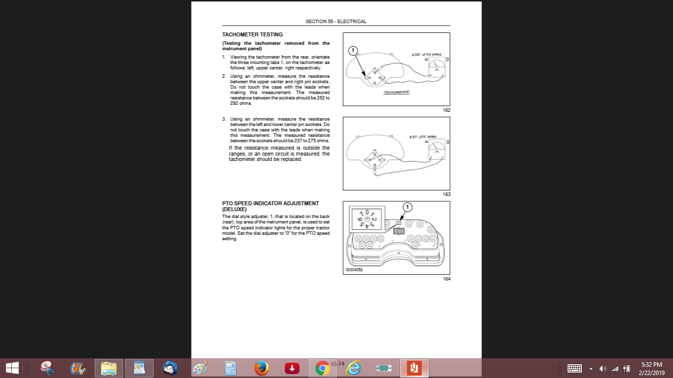

/ TC35 Tachometer Failure #5
this is from my NH manual

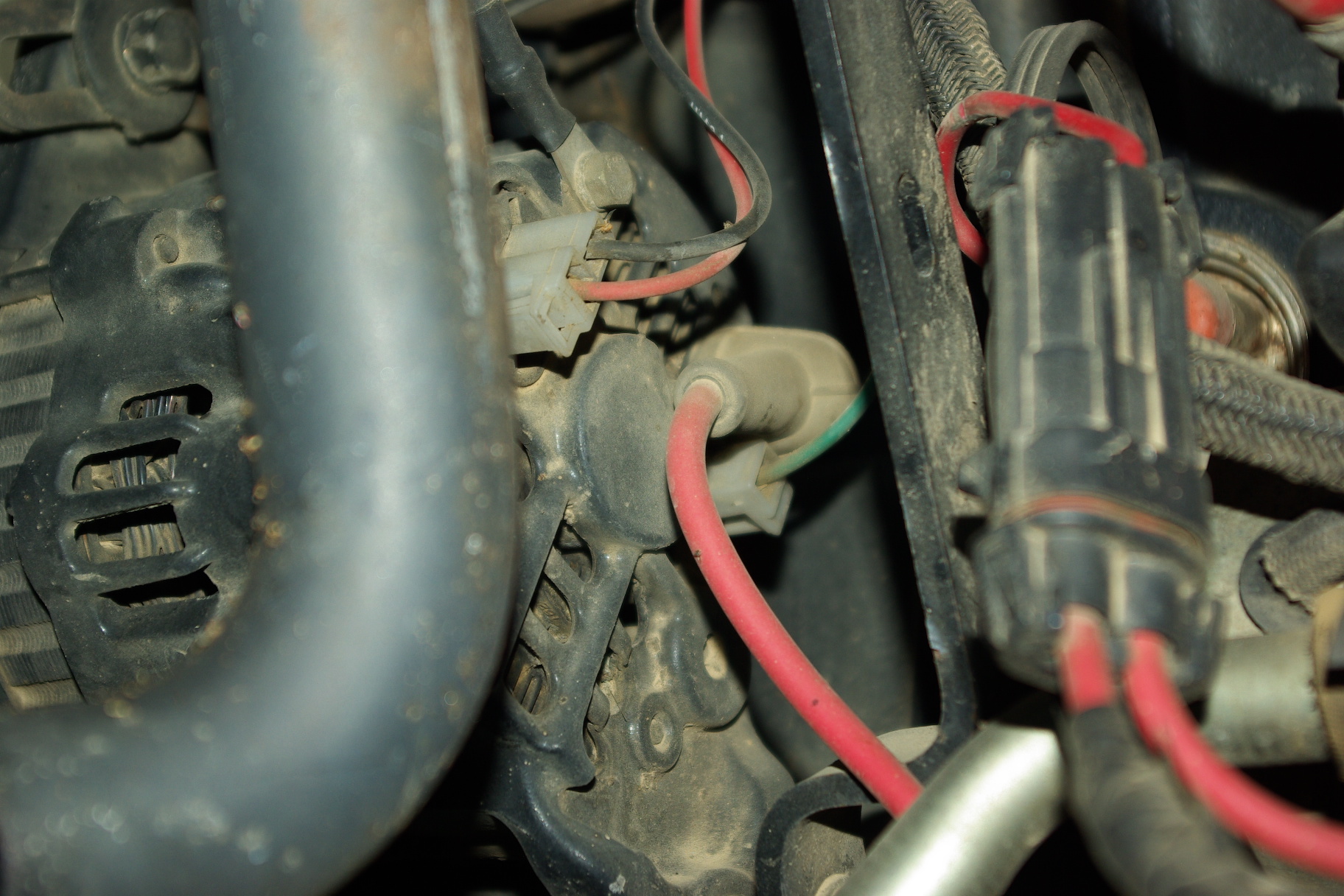

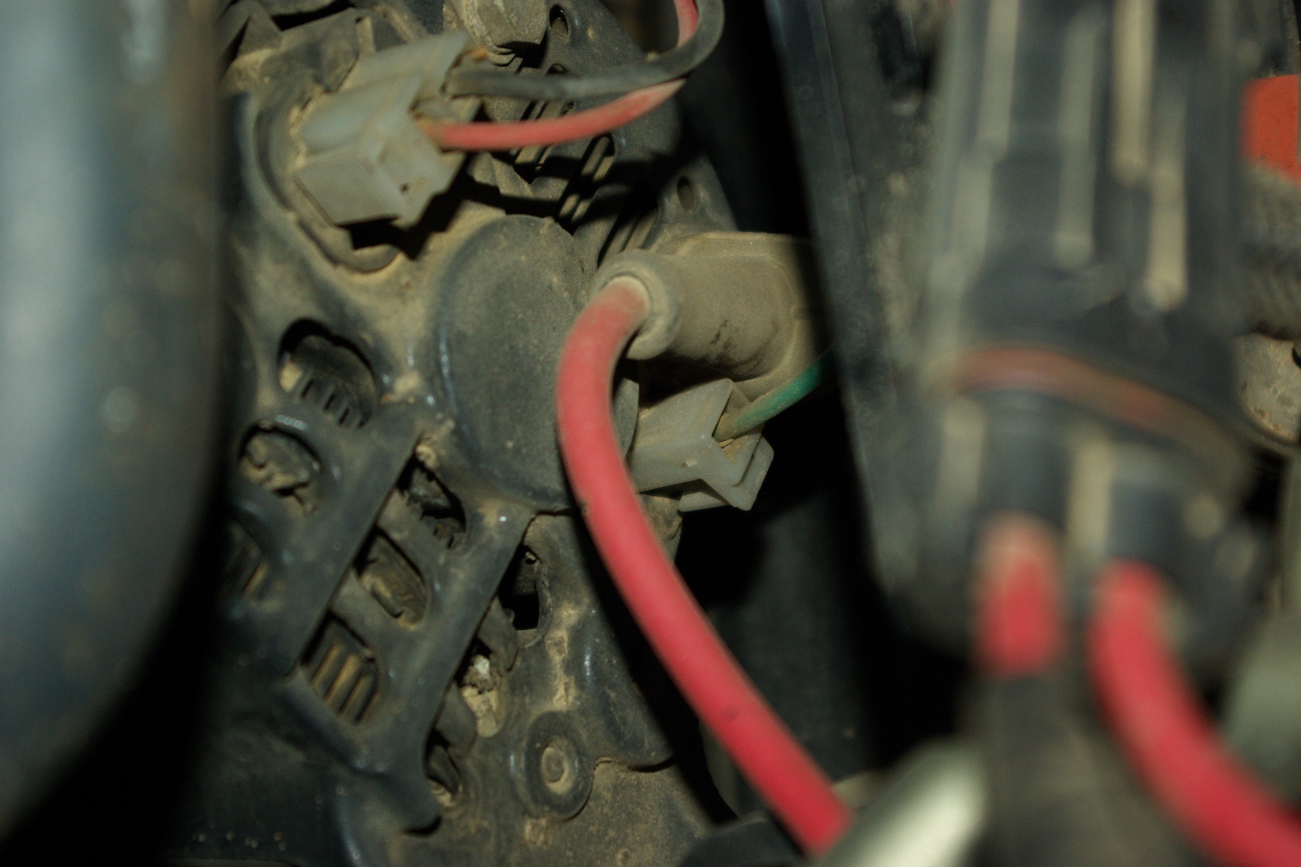

I recently purchased a USED New Holland TC33D tractor. Good news is that everything on the tractor appears to work ok except the tachometer/hour meter.
There is a green wire with a female blade connector that looks like it should have been connected to something around the alternator but is hanging loose. There is a plastic connector on the back of the alternator with a black and red wire going from the alternator to the dash area + the large power cable off the back of the alternator.
As I understand it, the tachometer takes a pulse from the alternator to count pulses to show the tachometer indication.
I assume either the black or the small wires go to the "idiot" light on the dash--this light goes off when the tractor is started. I cannot find where the green wire might have been attached to the alternator. I have the wiring diagram in the back of the owners manual but no color coding of wires.
Any help would be appreciated.
/ TC35 Tachometer Failure #7
I attached a couple of photos of the back of my alternator, hopefully adequate enough to give you an idea where the green wire plugs into it. Yours may be the case that the alternator has been replaced with a generic unit with no tach provision. Check to see if the mounting bolts have been removed or unthreaded. The wiring diagram is color coded in that the letter at the end of the description denotes the color.IMGP4397.JPGIMGP4398.JPG

You don't know how relieved I am to receive your response. Thanks!!!
Now I know exactly what my problem is which will save me a lot of time and possibly unnecessary parts purchasing.
My alternator looks like yours and others that I have seen pictures of on the internet--but cannot really see the area where the green wire is attached on yours since I have a bracket in the way along with having the arm from the front end loader in the way.
As soon as I finish my morning coffee I will remove the bracket that is in the way--looks like a simple job and see if I have the correct alternator and if so determine why the blade connecter/wire was disconnected. I suspect that I have a generic unit with no tach provision-but will soon find out.

All Grins on this end. Removed the bracket and there was a connector blade on the far side of the battery connection. Green wire connector wouldn't reach so, cut and spliced in a small section of wire and hooked up, re-installed bracket and gave it a try. Tachometer now works. Don't know the history of how the green connector got disconnected but obviously the harness wire would not reach the alternator.
