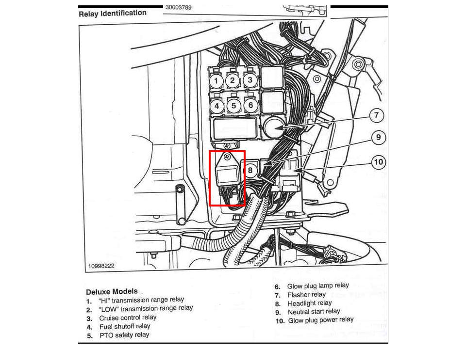

How do I identify the glow plug timer? Larry
   / tc35d #2 fuse blows intermittently #25
It's under your left side cowling below the steering wheel and below the relays (hi-lited with the red box below). On the cover it will say "Lamp Timer" and I believe be manufactured by NGK. It might be Hitachi, but I believe it is NGK.

Thanks, it's on e-bay for $13.95. Same as Kubota NGK glowplug lamptimer S81NL, free shipping. Can't beat that. Larry
