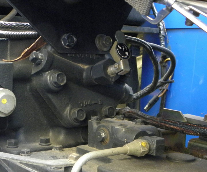

The first thing you do is look at that "deee-lux" operator platform and realize you can't do nuthin' until it comes off. Unlike the non-deluxe models where the job is a snap, yours is gonna be a pain. You have to adjust your mental attitude for doing lots of "get to it" before you can even start the job. The pictures I posted below are ones I copied from another TBNer's post about access to the lift cylinder. Yours is in the same place, but below the operator's platform. You might be able to see it by removing the seat and looking back through the hole under the seat support. I just don't think you'll be able to R&R without removal of the platform.
