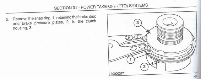

I currently own a NH TC35D, which I bought a year ago. I previously had a Ford/New Holland 1520 with 1350 hours on it before the rear end went out, and I decided to move up in size to more easily handle some of the jobs.
The TC35D has 250 hours on it now and went into the shop for what I thought were some minor hydraulic adjustments. Turns out one of these repairs were not so minor. The symptom was that initially, the tractor was “difficult” to change from 4WD to 2WD. It was also sometimes tough to change gear ranges. After a month or so, I was no longer able to move the tractor from 4WD to 2WD. I figured that since this was all hydrostatic, it was simply an adjustment. After 2 weeks in the shop, here is what I have been told:
The 35D has a braking mechanism on the PTO. This device stops the PTO from spinning as soon as the PTO lever is set to OFF. The problem seems to be that I use a 6’ finish cut mower deck about 80% of the time. I sometimes use a 5’ Brush Hog. It was explained by the mechanic that the momentum of the blades of these implements put extreme forces on the PTO braking device, breaking the ring, which happened to fall and wedge between my 2-4WD gearing and jamming those.
My dealer highly recommended an external PTO slip clutch, which just slips onto the PTO and allow your implement to keep spinning until stopping on its own once the PTO lever is disengaged. I was told that without it, I would do the same damage. It costs $46.00; I bought it on the spot. (The dealer has since sent me a check for the $46.00, since I protested having to buy one in the first place!)
Although this is my first Hydrostatic drive tractor, I can’t understand why a tractor manufacturer would design such a feature knowing that many implements have spinning parts that would cause these failures!! I was fortunate that my machine was still under warranty, as the “fix” is written for 24 hours of service + parts. At $35-$40/hr. I was looking at well over $1,000.00 repair for a year old tractor!!

I hate to be a rub, but I still don't think the TC35D has a PTO brake.
The service manual states the following:
" NOTE: The rear PTO output shaft cannot be rotated when the tractor is shut off and the PTO in the disengaged position because the PTO gear coupler, being constantly engaged with the powertrain."
It goes on to say that with a mid PTO kit, the shaft will free-spin.

Well, I'm gonna jump in here because I've done testing and also have the repair manual which clearly shows a PTO brake.
In section 31, it even gives the dimensions/specs for measuring thickness of the brake disc diameter and thickness. I'd hate for it to be thought that jlong's dealer was not giving him the correct info. The brake sits behind the clutch pack on the assembly as shown in the illustration from page 31-28 of the TC35/40/45 Repair Manual. The reason the PTO continues to turn after the lever is moved to OFF is that there is a bleed valve which slowly bleeds pressure from the clutch pack and allows the brake to set. If you have your PTO engaged with the engine running and then disengage it, you can turn the PTO shaft for a few seconds by hand (not long enough to hook up a rotary cutter unless you are extremely fast.)/w3tcompact/icons/laugh.gif This has been my experience on my TC45D, but according to my Repair Manual, the 35 & 40 have the same clutch pack even if they have mid-PTO installed.
I'm surprised jlong's dealer told him he should put an overrunning clutch on his PTO shaft. It seems like telling a person that their brakes will last a lot longer if they just allow their car to always coast to a stop./w3tcompact/icons/crazy.gif I like having the blades on my rotary cutter come to a stop in a few seconds rather than in a couple of minutes. It seems to me that our tractors have been around long enough that if this part were a known problem, more of us would have heard about it. I'd say it's probably something we should be concerned about and maybe Spencer200 or other dealers who have access to a greater amount of service history would be able to shed some light. In the meantime, I like the way my PTO works and I hope I can continue to use it that way./w3tcompact/icons/smile.gif
