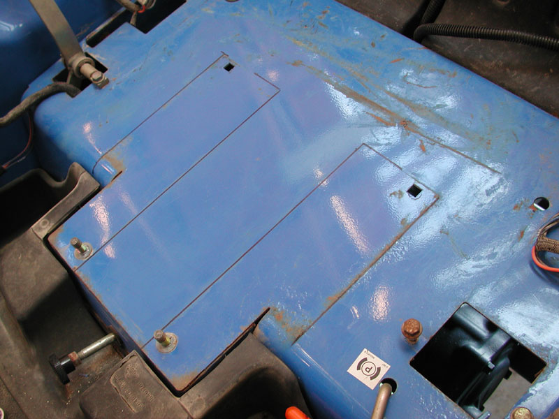

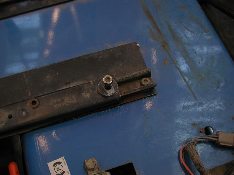

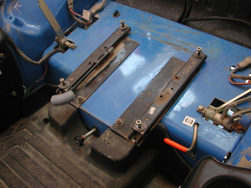

I need your help here if you can. I have attached (I hope) three photos.
Photo 1 shows the platform with the seat removed but the seat brackets and left side levers still in place.
Photo 2 shows the 6mm socket head cap screw securing the back of the bracket.
Photo 3 shows the area with the seat brackets and levers removed. I had to remove the levers so I could get my hand and a 13mm wrench under there to hold a nut while I used a 6mm alan to remove the socket head cap screw on the seat brackets. I was able to get the other side through the hole on that side where the draft control?? would be if I had it.
Photo 4 show a square drawn with orange grease pencil where I marked the tentative location for the access hole.
I checked several times from beneath the tractor to be sure there were no bolts or other attachments in that area. There are a couple of welded bolts but they are well outside the area so I could make the hole bigger if need be. The fabricated cover plate would have to be maybe an inch bigger than the hole so sufficient bolts could be used to guarantee structural integrity is not compromised. I also thought about adding a "picture frame" kind of steel plate around the access hole, but underneath, so I could drill and tap holes to attach the top cover plate to. This would sandwich the cover plate, original steel around the access plate, and the bottom "picture frame" reinforcement. Don't know if going that far is really necessary though as I have never seen the access plate configuration on the manual shift tractors.
Your guidance will really be appreciated.

Searay,
I'm with Sweep on this. If you glance quickly thru the 2 links I pout up you'll be able to see the cylinder head/liner and piston removed. You'll have exactly that under the sheet metal. The cylinder head casting might be a bit different but not by much. I just can't see how cleanly you can cut the sheet metal to expose the cylinder head for removal. the knob that you see if is in the middle of the head and you need to cut big enough to be able to remove all the bolt. I think the sheet metal will be damaged unnecessarily and odes not buy you much. might be difficult to put the seat back after the sheet metal is all cut up. I have many pics of the head and how it relates to my seat and I can share here if you want. The innards all the same and sheet metal just covers it all.

I can cut the sheet metal extemely cleanly. I drill 1/4 inch holes at the corners to provide a nice radius. I then use a Dremel with a reinforced cut-off wheel to cut the straight sections. I have used this procedure several times in the past and the results are excellent. Any minor flaws and sharp edges are easily removed with a file. I don't know how you thought I was going to make the cut, shears/plasma cutter/torch? I would never do anything to compromise the looks or integrety of the tractor. Thorough planning, the correct procedures, design, proper materials, and care are all that are needed to do a great job. When the job is done, including paint, it will look like it came out of the factory that way.

Searay
This is the first time I have seen the area under this type of tractor. (I have a gear tractor). I would not call it sheetmetal more like structural steel.
I would think by the time you cut it out, make a new patch, bolt or weld it in and paint you could have unbolted much of the steel off and maybe even start putting it back on.
If welding it back on you have to worry about shorting something out on the tractor such as relays or sensors etc.
I could probably have that metal off unbolted in less than a 8 hour day as a first timer doing it. I made a steel support under my plastic fender and took off the fender in maybe 15 minutes or less.

Thanks Sweep.
The metal is only 3/32". Not even 1/8. No problem at all for the Dremel cut-off wheel. The thickness of these cutters is only 0.05". I don't plan on doing any welding or any other kind of torch work... that's asking for major uglyness and trouble. Everything will be drilled, tapped and bolted. From the above comments I did not explain my idea clearly enough.
I'll just go ahead with my best guesses about the size and exact location of the access panel. I do not consider this a "jury rigged repair". I absolutely hate that kind of thing. I think this is correcting a design deficiency and making an improvement through a "field modification".
