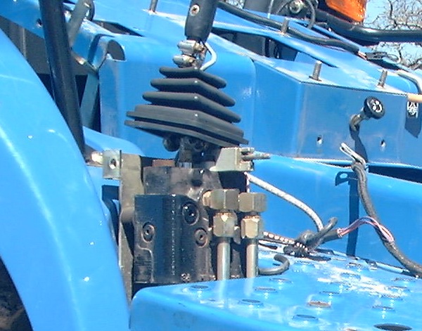

Searay, holy cow! HOLE-LEE-COW! They removed the hole on the DA models (certainly all three: 35DA, 40DA, and 45DA). Sheesh! Look at the photo below. It's when I had my platform raised to work on my broken HST pedal. You can clearly see there is a hole in the middle of the seat platform. On your tractor, the seat mounting is slightly different from mine on my TC45D also.
If it were me and I wanted to cut a hole, I'd do it so that the front two bolts are not disturbed. Maybe you could put the bottom of the hole 1-1/2" above the lower bolts. Since the upper bolts are carriage bolt holes, you can remove them completely because you can easily make new square holes if needed in the cover plate when you reinstall it on the platform. I also think you should consider removing the fuel tank so you have open access from the rear. The fuel tank is easily removed with only two bolts. You have to remove two fuel lines (supply and return) and disconnect the wiring harness for the fuel level sending unit. After that, take out two bolts and remove the tank. Of course, draining the tank makes this a much easier job. This will give you a clear view of the area and even allow access from the rear if needed.
EDIT: I've added some useful images below:
This photo shows how easy it is to get to the lift cylinder on a TC35A (non-deluxe) gear model tractor. Your's will look exactly like this when you get your hole cut. . . except for lots of dirt.

Dang Jinman... that hole looks about where I had marked mine out with the orange grease pencil! This morning I took some photos by sticking my digital camera into the cutout for the levers. Also stuck my arm in the hole far enough to actually reach the adjustment rod and the head area. There's plenty of room to get things taken apart just by cutting the hole. Halleluja!!! I won't have to take the whole platform off to fix this!
