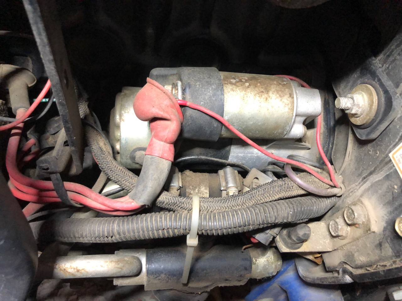

I've often wondered that same question. Here is a picture of the starter on our TC33D if that could help someone describe what you do?
/ TC35DA Wont start help #4
So in my picture somewhere under the black cover, behind the lug which the red wire is attached, there is another terminal these two need to be connected. I guess for my situation you would need to remove the black cover.
/ TC35DA Wont start help #5
I've often wondered that same question. Here is a picture of the starter on our TC33D if that could help someone describe what you do?View attachment 731904
OK, the red cover is over the battery hot leads,
also a small red wire leaves there and goes up towards the firewall,
there is a second red wire that appears to go behind the starter solenoid.
Does it go to a terminal on the other side of the solenoid?
If so a jumper from the hot leads under the red cover to that terminal will act like a switch.
Your best way is to use a remote starter switch;
Also I would expect that there is another large stud from the solenoid to the actually starter motor the same size as the battery connection, it could be under that black cover or on the other side of it.

Hi thanks for the help, I actually have one of these switches bought awhile ago but haven't used yet, different brand.
But my question is on the starter I just see one LARGE red wire from the battery and one small red wire which I am assuming is the wire from the ignition switch to trigger the solenoid is that correct? Attached is pics of my starter, appears the prior owner has hacked something on that small red wire at one point.

You guys have it scoped out exactly right--simply introduce 12 volts from the battery to the smaller red wire on the starter solenoid. This can be done with a small (12-14 gauge) jumper with alligator clips on each end.
What was not mentioned is VERY important--MAKE SURE YOU ARE IN NUETRAL!!!!
A guy a couple miles away from here spent most of a year in the hospital after he routinely jumped the solenoid after refueling and was run over by his tractor. Crushed his ribs and pelvis in numerous places. The first passerby called the ambulance, the next guy chased the tractor down as it was going across the pasture and got it stopped.
/ TC35DA Wont start help #16
I can't really tell from those pics, I would expect 3 terminals on the starter solenoid.
One from the battery cable to the solenoid,
then a small one from the tractors wiring harness to the solenoid,
and a third going into the starter body.
A remote switch would go from the battery cable terminal to the smaller one from the tractor harness.
If this is similar to your starter,
yes the remote starter would go from the battery connection to the small tab above it.
Likely were the previous owned tapped into it.

The second pic you shared looks like what I can see from my starter.
So I will give that a go, applying power to the small red wire to get it started.
Thank you all!
