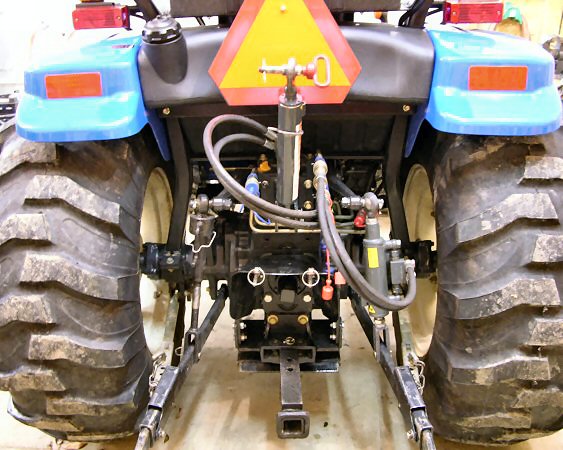

We had a case where our brush hog contacted our draw-bar also so we made a slight modification to ours. We welded a receiver tube on the draw-bar itself. Now we keep the draw-bar retracted as far as possible and simply slide in one of many different hitch attachments that we have made using 2 X 2 x 1/4 inch square tube when we need to pull or move a trailer. It works well for us.
Also notice the rear pin that can be quickly removed without getting under the tractor to remove the whole draw-bar from the tractor itself.
