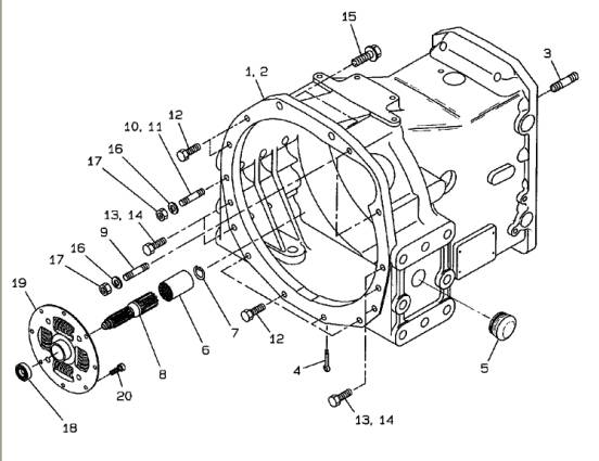

Motor rebuild? Did they split the tractor? This is sounding like the splined collar may have not been re-installed correctly or is cracked and slipping. When the tractor would not go up an incline, was it in low range? I'm beginning to get an idea of what you may find when you split your tractor. Of course, I don't know for sure, but this is sounding like maybe a rollpin was left out of the splined collar and it moved and cracked, leading to total failure. Now, this is just a fairy tale based on my imagination.:rolleyes: It is plausible, but you won't know the facts until you look at it with your own eyes.
Here is an illustration of the front transmission housing and the engine interface. Item #19 is the damper on the engine that replaces the clutch. Item #8 is the engine/transmission interface shaft that has to be in place since there is no clutch on this model. Item #6 is the splined shaft that connects the interface shaft to the transmission input shaft. I was wrong that it has a rollpin. It has a lockring instead, item #7. This is where I think you will find your problem.

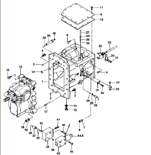

Here is the illustration of the transmission. The input gear shown on the left would mesh with the splined collar on the front transmission diagram.
