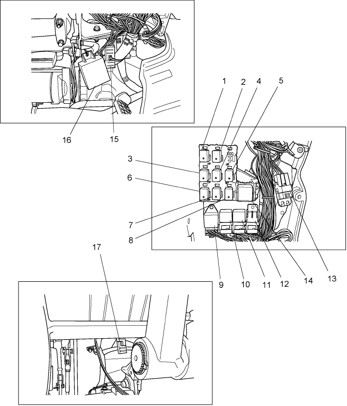

Well, the configuration has definitely changed on the newer "DA" machines. Let me do a little research and I'll get back to you. I think it may be black square near the upper group of relays, since the lower group appears to be the same configuration as my tractor. NH may have a combined blinker/flash converter all in one assy now. Don't know for sure.:confused:
Hold the phone. . . .
Okay, I'm back.:)
The illustration for your tractor is attached thanks to Messicks.com . The flasher module is #16. It appears to be lower than your picture showed. It's also (hold your breath) $151 and change.:eek: The flasher relay is #3 in the relay illustration. This is the kind of thing you definitely want to know is bad before you go replacing it.

Jinman, Thanks for following up on this. $151 is a liitle steep and I definately want to be sure the flasher module is the problem before I buy one. Is there a proceedure to troubleshoot the module? Sig
   / TC40D turn signal problem #13
I'm sure there is, but my Maintenance Manual is for the old-style NASO module. I think they have now included the flasher inside the module and that makes things much more complex. Without specific info or a schematic, I'd be afraid to offer you adivice.
In the old days of blinker flashers on cars, I've "adjusted" a few by pulling them and smacking them against something hard to break the contacts loose. I'm pretty sure that would be bad advice here.;)

Thanks Jinman, I'll make a few calls and see if I can find the proceedure to troubleshoot the flasher module.

Did you get an Operator's Manual with your tractor? If so, it has an electric schematic in the back of the book. That schematic will tell you what pins on the module get power, have input from the blinker switch, and have output to your lights. With that info and a VOM, you should be able to isolate the problem. The test procedure in my Maintenance Manual calls for removing the module and flasher and hook them together on a bench with a test light and a 12 volt battery. You essentially rebuild the circuit on the bench. I don't know why you could not do all that with using the circuit and components on your tractor. After all, what is better than troubleshooting in the actual circuit where the flasher has to normally work?
