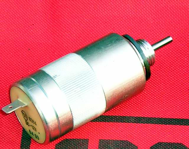

What about the fuel cut off solenoid not fully opening the injector inlet? I'm not sure I understand what or how that is? or how to check it.

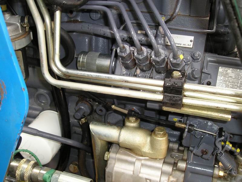

Of all the possible problems, that is probably the least likely, but the easiest to check. The only reason I mentioned it a all is that your problems seem so strange that it might be something remote. I've attached a picture of the solenoid. It's that shiny round cylinder right behind the injector pump. It has one spade connector to remove and then you can unscrew it. The knurled surface means only hand tight, but you might have to grip it with pliers to get it started. Be very careful because you don't want to squeeze it too hard. Once you have it out, just hook up the wire and turn on the key with the range lever in neutral and the parking brake set, the plunger should fully retract. Note: the body has to be in contact with ground to operate.
Also in this picture down near the lower right corner, you can see the bracket I illustrated in my last post with the governor shaft phased properly.
I'm attaching a photo of the solenoid completely removed too.

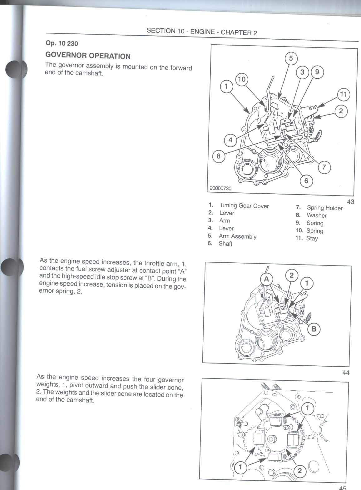

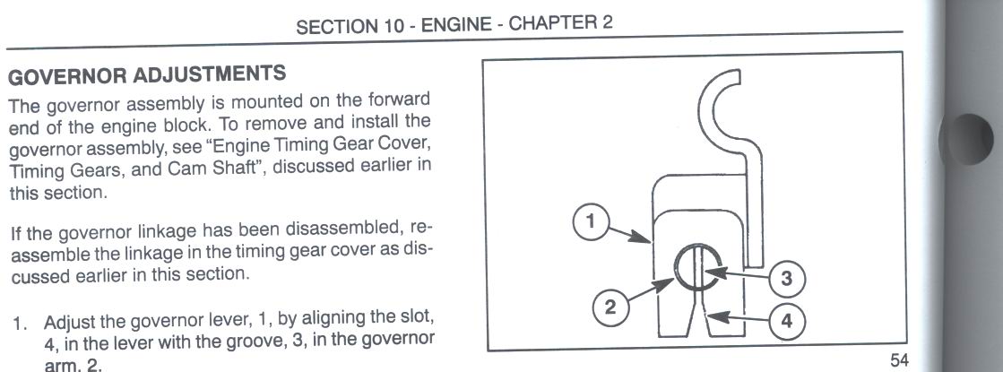

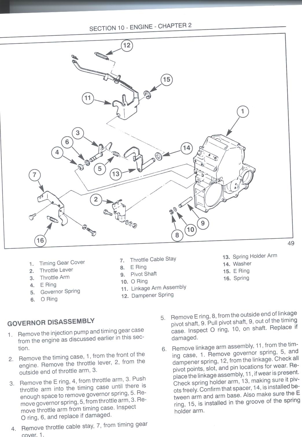

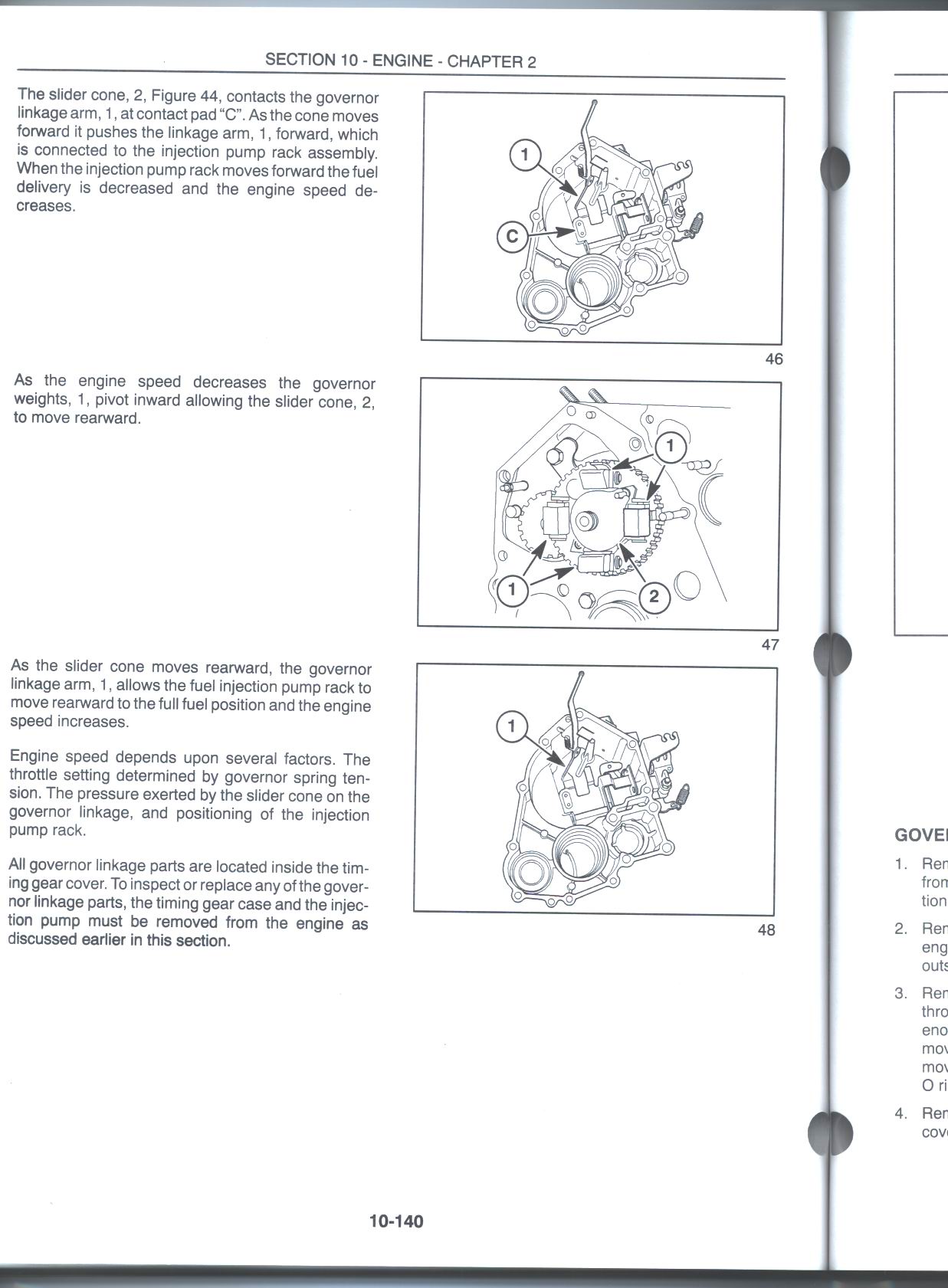

Sonnyc, here are the Repair Manual pages about the governor. I doubt this is your problem, but I will leave it to you to decide for sure.:)

   / tc40d with no power #20
G'day it is extremely unlikely that the inj pump timing would have altered unless you have had the pump out or broken teeth/drive pin on the pump diesels unlike gas do not need timing altered every service i have seen pumps on engines that have done in excess of 10,000 hrs and never even had the nuts loosened on the pump.
