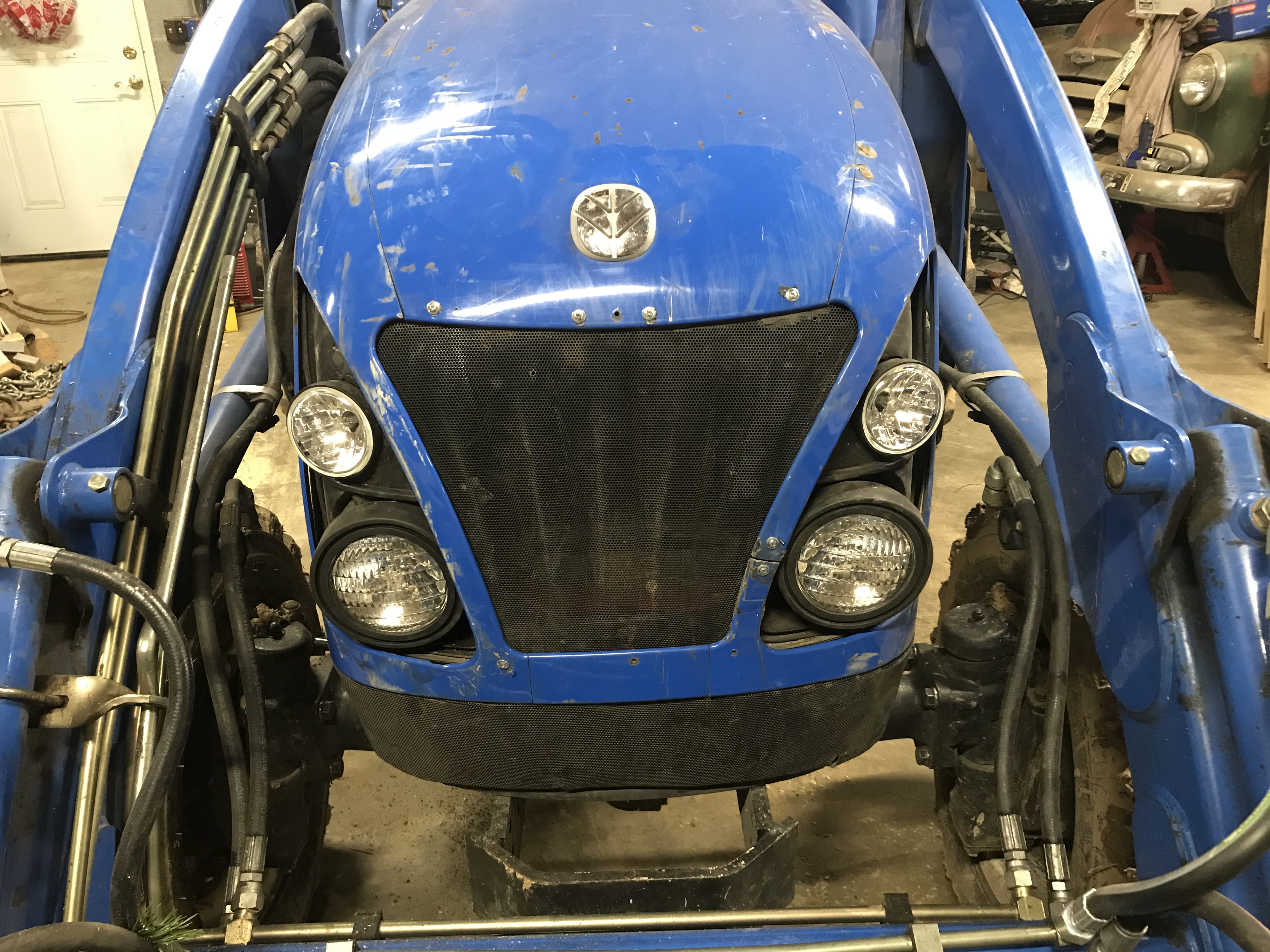

Wife in a week and half broke the glass lens on both headlights and three bulbs exploded while moving indoor from the rain. I searched the net but find with tax and shipping and bulbs a total of 500 bucks to replace both and no guarantee that they'll last another week. Looked for something to replace it that would work that was price friendly and could be easily replaced. Found an Allis Chalmer 5.5 inch bullet shaped head light with a seal beam to replace the lower light. Rear mount stud goes right in the bulb hole. Added half inch foam tape around it to control vibration movement that could weaken the mount, though is has huge cupped metal washers that come with it. The upper light does not shine straight ahead, it is an area work light. Found a New Holland LED to mount in after some modifications. Had to cut the back out of the hole and had to cut the mounting ears off the new light... JB welded the gaps after covering the light body with the plastic bag it was shipped in. Filled the space with JB and after it set, removed the light from the bag and removed the bag itself. Sanded the area and removed the chrome reflector. spray them flat black and attached the lights with 3 screws.
   / TC40DA Headlamp Assembly #12
Used WN-388946R91, 25.00 each on eBay on the bottom.
Used 82035642 on top. 64.47 or two for 138.93 w/shipping on amazon (this is a new holland part)
Both are mounted in the original light housing
