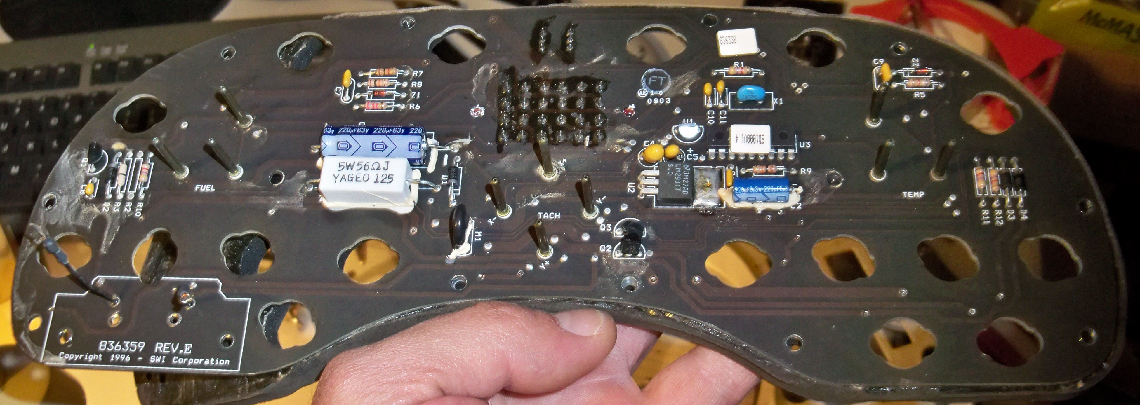

I had the same problem.
My repair of the hour meter is out of the scope of this forum, but hopefully I can shed some light. I repaired the hour meter after the coolant temp gage had failed.
If you are not familiar with electronic repairs you shouldn't attempt it. It could cost you several hundred dollars, send it to a professional.
Do not remove the hour meter from the circuit board as shown.
The hour meter runs when there is power applied to the Microprocessor (U3). The MPU send a momentary signal every 36 seconds to the NPN transistor (Q1). This transistor provides a circuit path to ground on the hour meter solenoid. The other end of the solenoid is connected to 12V positive.
On my instrument cluster Q1 had failed. After replacing the transistor I added a schottky free wheeling diode across the hour meter solenoid leads.
Mike
   / TC40DA - hour meter stopped working #5
So Mike, you think the collapsing field around the solenoid caused your Q1 to fail? I take it that your Schottky diode shorts the field away from Q1.
   / TC40DA - hour meter stopped working #6
Yes, and I know that you know that. You just want me to explain it.
A solenoid is an inductor. An inductor is the opposite of a capacitor; it stores energy dynamically vs. statically like a capacitor or battery.
When you apply a current across an inductor the electrons flow through the winding. Since the electrons have mass they do not want to stop flowing when the circuit is opened. Since you cannot create or destroy energy that energy will ring back and forth through the inductor until it finds equilibrium. At this point there could be several thousand volts and it will find the closest path to complete the circuit. The closest path would be the transistor itself.
A freewheeling diode will protect this circuit. A diode will only allow current to flow in one direction. If a diode is connected across the inductor it will shunt the first ring of the inductor. There was already a freewheeling diode (D2) which was a 1n4006. I felt that the forward voltage on this diode was too high and would not adequately catch the first ring.
Mike

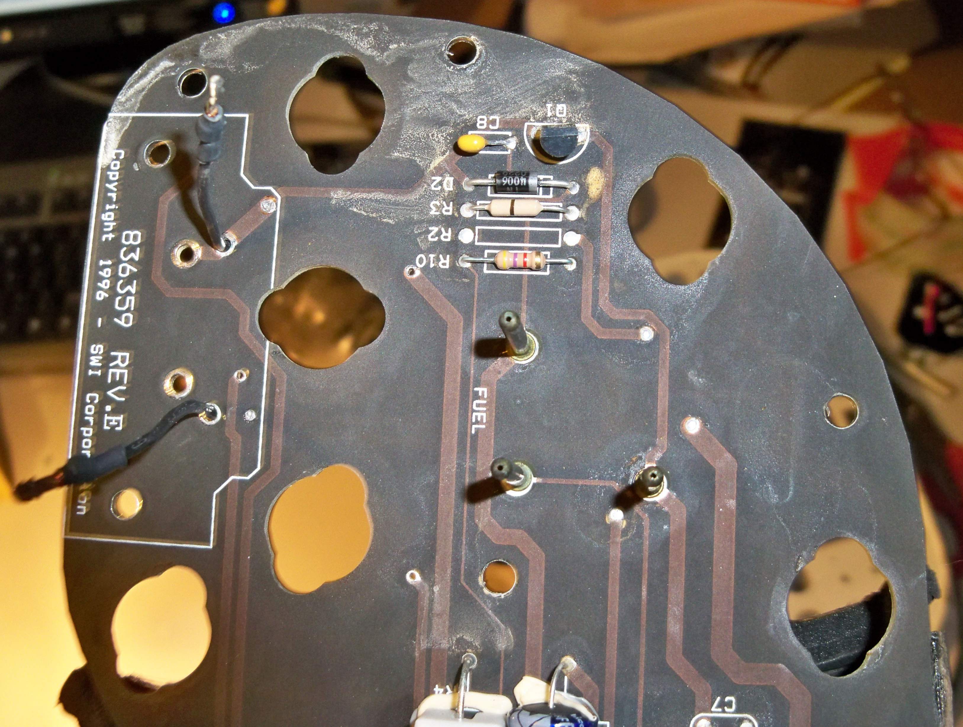

BTW: Is U3 on the part that has been removed or just out of the photo?
   / TC40DA - hour meter stopped working #8
From the picture you will see that I made a mistake on the disassembly of the hour meter. What appear to be blade terminals on the ends of the wires are actually the wire termination for the hour meter solenoid wires. These terminals should not be removed from the hour meter. The correct procedure would be to unsolder these leads from the back of the board.
The picture below now shows the MPU (U3).
Mike
