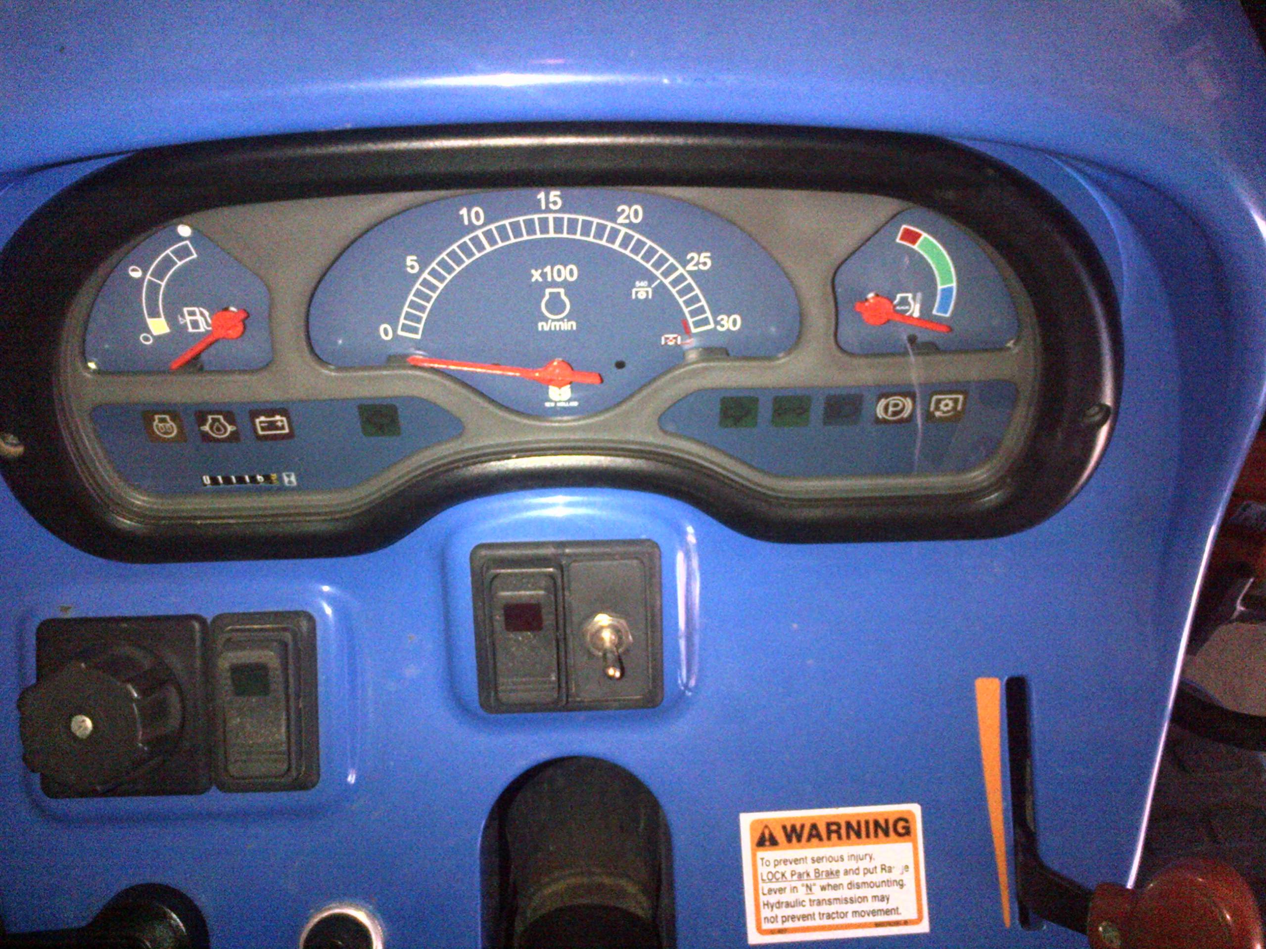

Hello everyone, just posting a quick update. I fixed the hour meter on my TC45DA in a much less technical fashion than that described earlier,...no diode soldering or rerouting excited electrons.... I'll tell you what, you guys sure know your stuff. In my case, careful disassembly to the point of getting direct access to the rollers on the hour meter, some gentle compressed air, and a few blasts of electronic cleaner (made by "Gunk") did the trick.
For anyone else who's ever stripped the gauge cluster down, you know that the gauge needles are extrememly fragile. I broke two of mine as they were very weathered, the previous owner did not store the tractor inside and my needles were literally white colored instead of orange from being baked with UV. Some 5 min epoxy and careful arrangements of toothpicks for support allowed me to get the needles properly repaired with a good bond. Some bright orange paint from an old Testors model paint kit I still had from a kid has the cluster looking like new,...and a working hour meter to boot!
Thanks for the initial tips guys....
