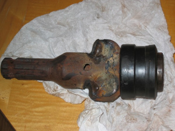

#37
Here is the adaptor I had made. I had a quick release yoke that was too small (don't actually know where it came from). I disassembled the release (simple snap ring holds things in place). I took the bare yoke, the original adaptor and a short 1 3/8" OD x 1 1/8 " ID spline collar to my welder. They cut the ears off the yoke, then used the spline collar to align the two pieces. They tacked the pieces, then removed the collar and finished welding. It is one solid piece now, perfectly aligned.
I reassembled the quick connect and tested it on the tractor. I'll do a test mow tomorrow is it isn't raining. It is heavy and I am a little worried that it might not be perfectly balanced. Don't want to strain the PTO. Anyone have an idea for checking if it is balanced or should I even be worried about it?
