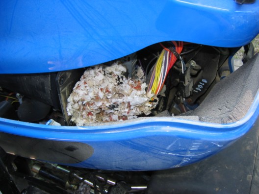

   / TC40DA Rabbit/Turtle Switch not working
I can't get the switch for the joy stick unplugged - is there a trick?
AND the switch is now stuck in Trutle. It won't move nor do I hear the relays click. The Rabbit light doesn't flash any more.
The problem may be in the wiring. When I pulled the panel to get to the relays, I find a mouse nest - and some insulation missing from a wire. I had found a nest behind the battery and they have chewed that cable to the wire.

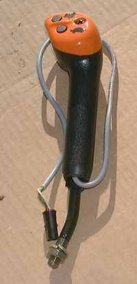

Barry, I'm attaching a photo of the joystick removed. Is the connector you are having trouble with the one on the bottom? That's the one I disconnected easily.:confused:
Also, in your second picture of the wire damage, the hi/lo relays are the two at the top-left of the picture. All of those relays are the same ones, so if you can swap them or move them around, you might find your problem. Of course, it is wire damage, who knows? It could be anywhere the rodent may have found a home.:mad:
