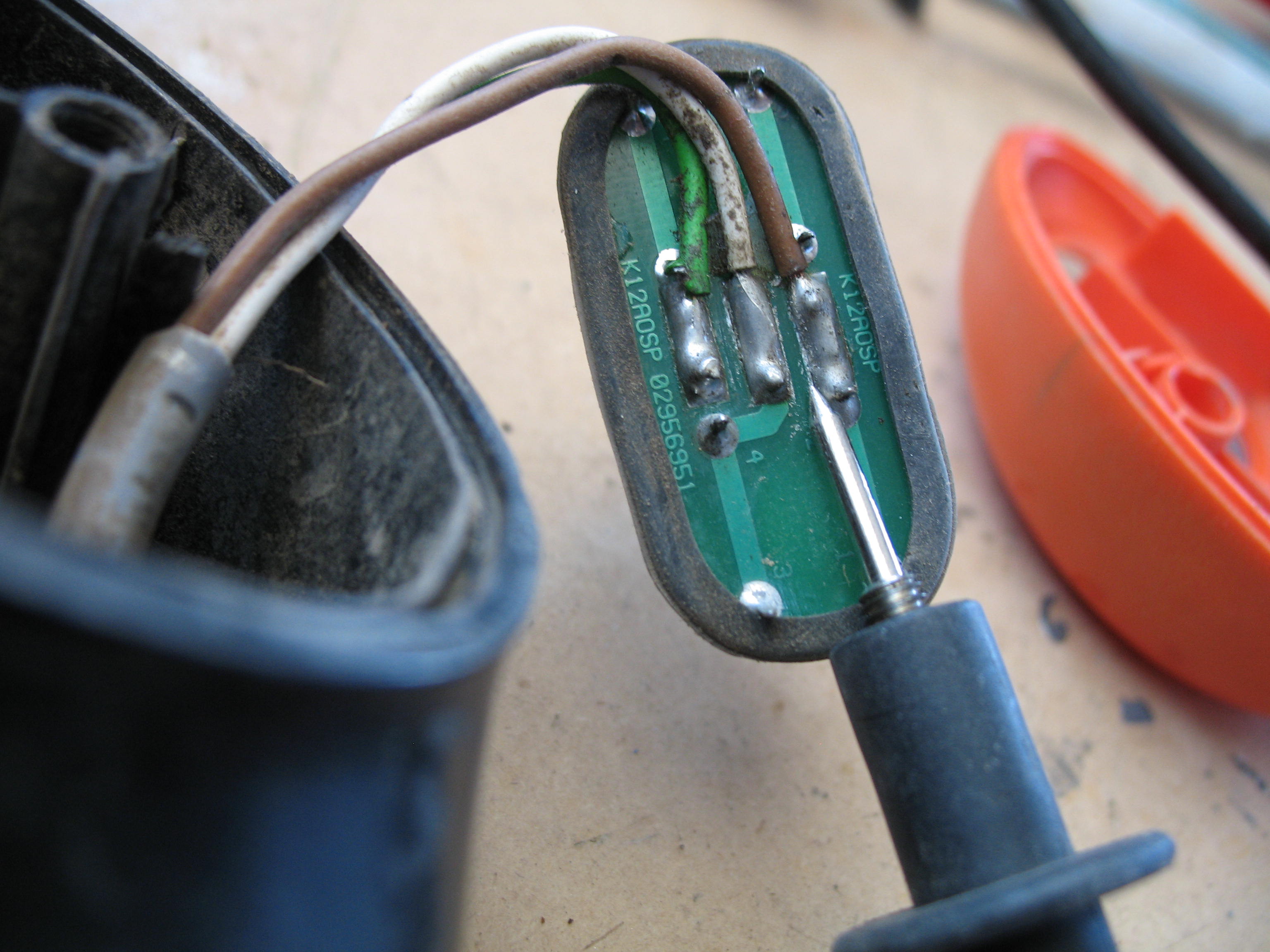

Just fixed Turtle-Rabbit problem!! Was moisture/mineral deposits on rear of Joystick switch. Cleaned between soldered terminals (see end of test probe) and working now!!!
Looks like good clean-up work:) !
