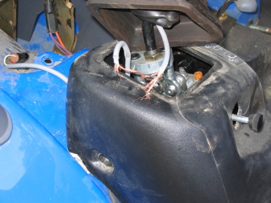

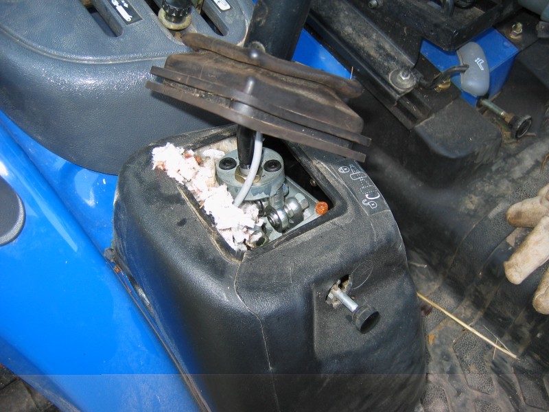

Well the mice have done it again. As you can see from the two photos, the joy stick tower was filed with a nest and the wires had been stripped bare. I spliced them together and all is well.
BTW in a DUH moment, I was trying to disconnect something under the tractor - not the joy stick connector. I came right apart.
I'm going to post a general message about how I might mouse proof all the places I've found nest so far.
Thanks for the help.

   / TC40DA Rabbit/Turtle Switch not working #15
I'de be getting me a cat or two to take care of those destructive rodents. Don't overfeed the cat though.
#16
Since we are only here a couple of days a week, I'm afraid the cat might go find a home with the neighbors. I'm thinking moth balls or other chemicals.
   / TC40DA Rabbit/Turtle Switch not working #17
Wow! What a mess, Barry. I think mothballs would be a good idea. Also and old sock filled with cayenne pepper dropped inside the joystick cowling might work. Mice hate that stuff. I think I'd also load the area around the tractor with mice and rat baits too. In a way you got lucky. The next time you could end up with a meltdown due to an electrical short. I'm glad you got everything working.
...and trying to make "lemonade": I'm sure you learned a lot in this process too.
