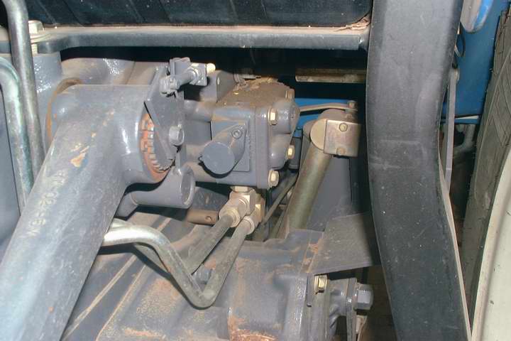

Just had my recently purchased 2001 TC45D delivered today.
I drove it for about 1/2 hour. Temp was around 9 degrees.
1) The temp guage might not be working, as it never moved.
2) There was another issue with the hydraulics, or something,
as every few seconds you could feel like a thump.
From behind the tractor, you could actually see the 6ft snowblower move up and down when this happens. This continued the entire time it was running.
3) Another issue: I stopped while driving up a hill.
I then switched to turtle, and the tractor wouldn't move.
The more I increased pressure on the pedal, the more the engine would bog down.
The only way I could get it to move was by switching to rabbit.
Tried this twice just to make sure it wasn't a fluke.
Are these issues related?

1. The not heating up issue can be one or all of three things: 1) the gage is not working, 2) the thermostat is not working, 3) the coolant is bypassing through the hose from the block to the radiator on the right side of the tractor. The final problem is fixed with a shutoff valve installed in the drain line as shown in the attachment.
2. Move your hydraulic lift lever away from the top stop just a bit and see if the hiccups of the lift stop. If you look at your right lift arm where it enters the casing (the upper portion of the lift as shown in the attachment 2) you will see an adjustment that stops the lift if it goes too high. If this is out of adjustment and you raise the lift all the way to the top, it will cause the lift to hiccup. If your lift is hiccuping at any position, then you probably have a slow leak inside the lift cylinder and the hydraulics are correcting as the position drops.
3. What range were you in? Were you in high range? If you were in high range, it is common to stall the transmission going up a hill. On steep hills, you will have to switch to low/rabbit to go up. Now...if your transmission pulled better in "rabbit" than it did in "turtle" then I would say your buttons are reversed (or the wires are swapped). It is impossible for the transmission to pull more in rabbit than in turtle. Are you sure you did not get that backwards?

I think Jinman is right on. Especially on the linkage / leak issue. Due to the way the ford unlaoding valve is made. the leakdown happens, then the circuit regenerates.. causing the bounce.
My 7610s does it if I have 2-3 thousand pounds on the lift and low rpm... the hiccup is more pronounced at lower rpm on mine.
