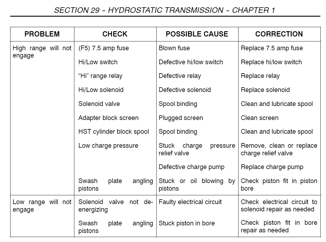

Well we been busy with wind storm damage, vacation and getting a new home HVAC system.
Monday I was cleaning up the down tree limbs and tried the high/low switch again and it worked fine even though I hadn’t done anything to fix it and it worked on Tuesday too. I guess I‘ll just monitor it.
   / TC45DA Electric Two Speed #16
Glad it started working. Like was said, it is in Low unless the Hi/Low solenoid is activated. In case it happens again, here is what the service manual says.
